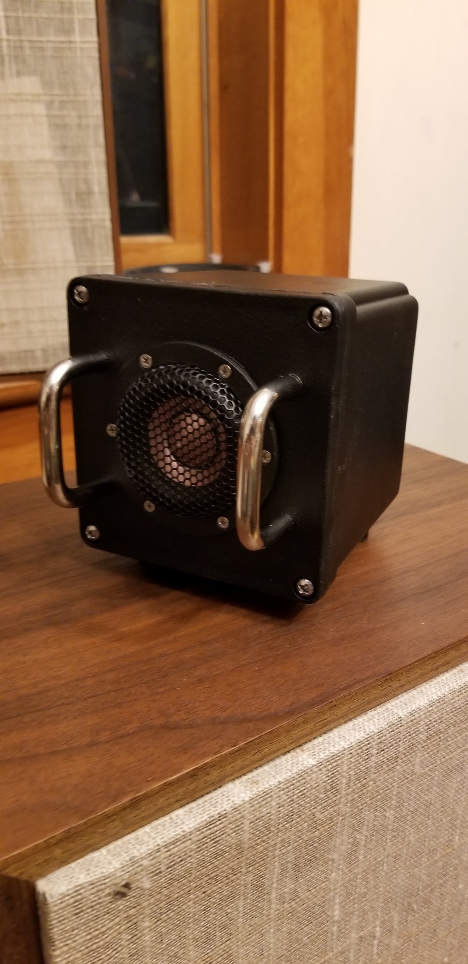

I'd like to share something I built for and with my son a while back for a pair of small desktop/nearfield monitors.
First off, I know that the number one rule of successful speaker design and construction is to _not_ just pick some appealing parts and bolt them together and expect good results. But that (with some trial and error along the way) is what I did, and got results that far exceeded my expectations. Beginner's luck.
The driver is the 2" Fountek FR59EXE, which look nice, seem well made, are moderately priced, and have the advantage of a built in grille.
The enclosures are a PVC weatherproof 4x4x4 inch junction box commonly called "JB444" sourced secondhand unused from ebay. Different makes of that sort of generic JB444 box have slightly different shapes and vary in how much their covers do or don't protrude past the edges. I picked some with a shape I liked.

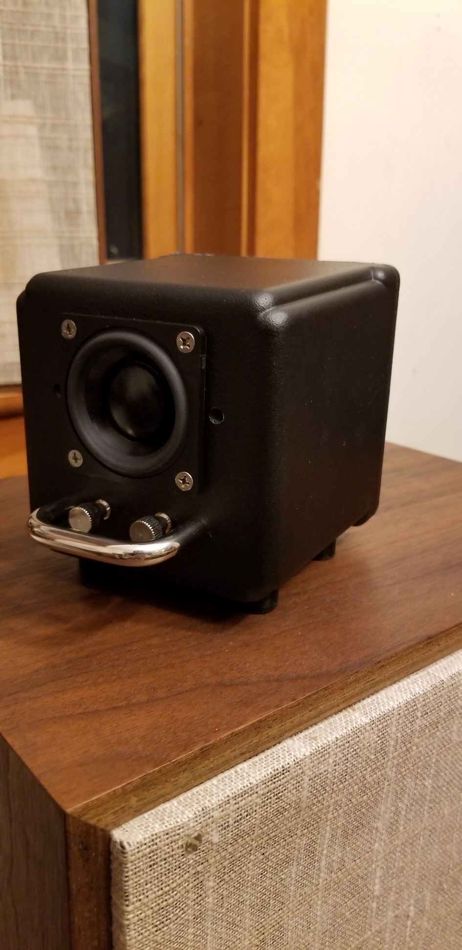

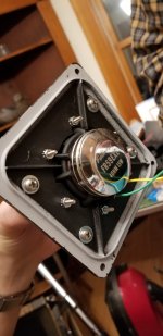

Fitting the driver into the front baffle is a bit fiddly- the speaker's frame has arms that, if you make a hole of that diameter, you have nearly nothing left for the bolt circle around the front flange. A 2" cutout followed by some very specific filing of narrow recesses for the geometry of the frame and terminals works out nicely (you still have to be careful to leave enough for the bolts)

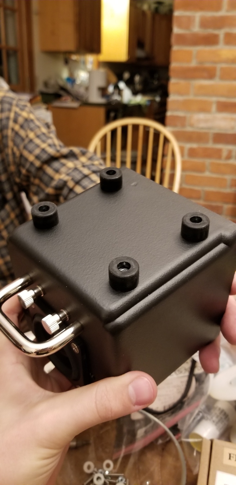

Drilled a 2" hole in the back of the enclosure and dropped in a Dayton DMA58-PR 2" passive radiator. Suddenly, wow, a really astonishingly well-rounded response, even at the low end. Started with the stock set of three washer-weights supplied with/on the PR "as delivered", played around a bit, and the sweet spot was two of the original washers plus one slightly heavier washer from the hardware store.

Finish on the outside of the enclosures is Rustoleum aerosol undercoating, goes on thicker than paint and is hard enough (but not brittle) to hold up surprisingly well with handling (after you let it harden for a day or more). The undercoating has an appealing "matte luster" appearance. Applied after sanding off the mold marks and scuffing the PVC everywhere with Scotchbrite to give the coating some 'bite.'
Rack handles are, of course, purely for looks (though they do also protect the binding posts on the back) sourced from ebay and apparently leftovers from some high-end Watkins-Johnson surveillance receiver.
Feet are screw-on silicone feet that someone on ebay was selling for use in making homemade wood cutting boards.
These are powered by a Tube Cube 7 single ended EL84 amp and the results really amaze me, both in terms of clarity and the extent to which you can really fill a room to satisfying (though not extreme) levels and truly enjoable clarity and tonal range with 3 watts to a 2" driver.
Not shown in the photos and added afterwards on the back of the enclosures were some small wire 'fan finger guards' to protect the PRs from errant fingers.
