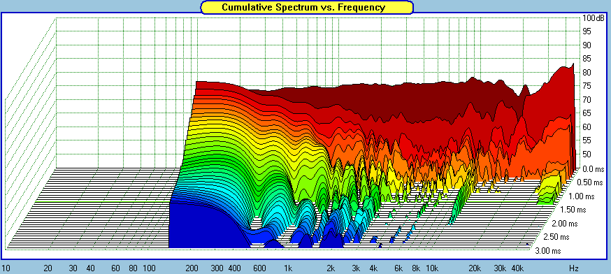

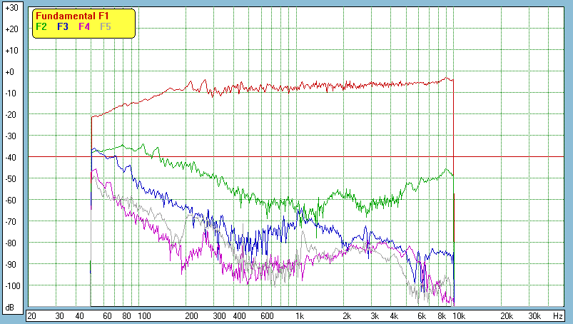

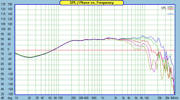

Some of these little wide-ranges do seem quite potential for that use. By way of example some measurements that Zaph made in Aug 2010 on one of the flavours of scanspeak 10F (the 4424G00) though of course there are alternatives (I just showed this one due to finding decent measurements of it).
0-15-30-45-60 degree FR:
On paper, possibly quite a reasonable choice for my needs. Just wondered what other people think of the idea?

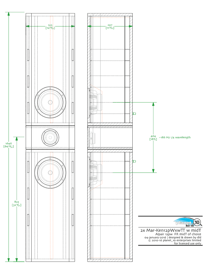

Such an arrangement is called a WAW (woofer Assisted Wideband). Almost all of them on the FUll Range Forum.
XOs are typically lower than 800hz (200-500 Hz). There is a huge amount of unexplored space.
We have done a number as examples (some examples):
I started this thread in 2009 to discuss these. https://www.diyaudio.com/community/threads/a-thread-for-tysen-and-variations-on-waw-fast.144099/
https://www.diyaudio.com/community/threads/alpair-7-3en-12pw-waw-build.319102/
https://www.diyaudio.com/community/threads/p10-hifi-alpair-7-3en-sdx7en-waw-aka-fast.269393/
https://www.diyaudio.com/community/threads/alpair-12pw-7-3-12pw-mtm.367842/
