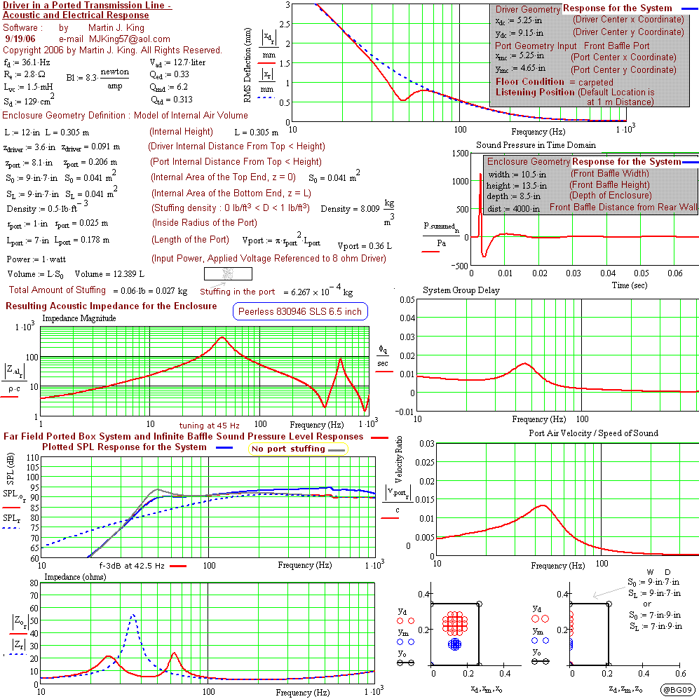

Sumba, This simulation may help:
b
1(1)
Thanks bjorno, your simulation looks a lot like mine so I guess I've done something right 🙂
I think I will go somewhere in between in terms of box volume and try around with different tunings until I find what I like the most.
Cheers
Sumba

I would consider this one...goes straight to 30hz in relatively small BR
Well, I usually try to stay on topic but if Sumba had asked for a down to 30 Hz sub that also ‘doesn't need to play loud’ in a 12.3 L box, then I had posted this simulation instead: See picture 1(1).
If he wants to build this 'Tapped (folded) box’ I must agree with GM: s statement:
‘truly high performance speaker design is no trivial pursuit’
It would be a challenge to fold this design suggestion into a compact internal volume of 12.3 L while still keeping the airways dimensioning/ acting accurate as shown in the simulation.
The port or slotted duct if 40 cm^2 would have the dimensions of 2.2 cm x 18.2 cm = about 40 cm^2 and if the port dimensioning is to be considered reliable at 20 Hz too, this area must be provided both in front and at the rear side of the driver.
The driver magnet has to be countersunk and sealed into one of the dividing walls…etcetera, etcetera.

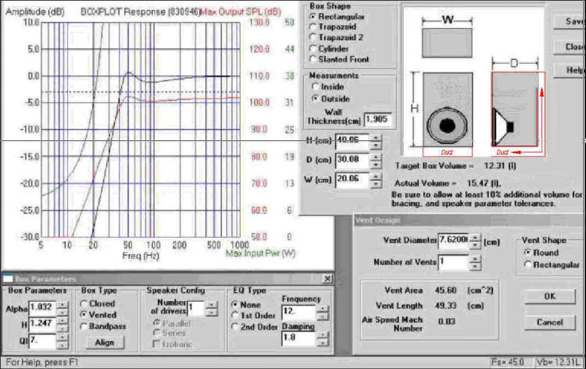

Hi Sumba,
Thanks for bringing the little Peerless to my attention 🙂.
I agree with GM's suggestions, as to the vent (duct) take a look at this construction:
tb46 said:
Hi Sumba,
Hi tb46 and thanks for your suggestion.
I will be building several different boxes with different approaches and fiddle with different tunings and vents and one will be a folded vent like that.
The Peerless is indeed a interesting little driver and it will be great fun to play with it 🙂
