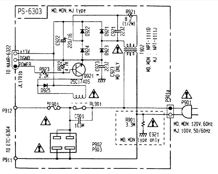

Well, this what I am looking at.
You will need that D925 installed in any case. Look at your board.
<<make sure it gives you DMM diode reading (without transistor in place) ~0.6V.>> You may need to unsolder and pull one end of D925 to avoid distorting your diode measurment with the coil resistance in parallel.

Schematic ?
What schematic is that, on my amp from q921 it goes onto the power pin of Q702 FL driver. However that d925 is there on my power supply board, so well, looks like your schematic is correct and whatever I pulled up as the TX-DS555 schematic isn't.

Testing this amp
Thanks for this diagram, I am testing my power board with this as reference.
The 3 connector that is going to NAR-6332, that has the +13v dc I am supposed to have.
However there is no voltage @ the coils of the relay RL-901 and I have shorted the prongs, so its like the relay is connected.
The amp still has nothing lighting up, and its not even going to stand by when I plug it in.
What could be wrong ?
