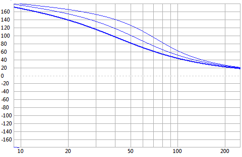

Maybe someone smarter than me can tell you if this crudely calculated phase graph means they would sound fine together. (I don't know how many degrees difference it takes to cause a problem, just that 180 is completely out of phase IE total cancellation, and I'm pretty sure drifting phase is the reason for the usual recommendation against mixing sealed and ported playing the same range). I only modelled the slim 10.
bottom line, highlighted: RSS210HO-4 in .75ft3
next up, LS10-44 in .75ft3
top line, LS10-44 in .33ft3
Max phase difference between dayton and LS10 in equal volumes is ~20 degrees. Max between dayton and LS10 in .33ft3 is about 45 degrees.

Chompy,Max phase difference between dayton and LS10 in equal volumes is ~20 degrees. Max between dayton and LS10 in .33ft3 is about 45 degrees.
At 45 degree phase difference, the loss in level compared to two perfectly "in phase" (0 degree phase shift) sources is less than one dB.
In other words, if phase response is within 1/4 wavelength, output is nearly the same as two identical sources which sum to +6 dB.
Small room modal response can easily result in variations of over 12dB between various room positions, making the small difference level due to +/- 45 degree phase differences between two sealed subwoofers looks quite small.
