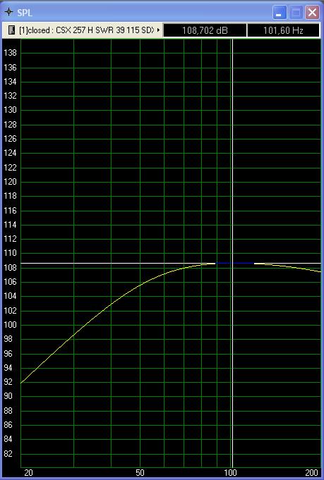

Here is the SPL curve of your driver in your 41 liters box not stuffed with a 100 W RMS signal, at the top right corner you see the maximum SPL at 1 meter at the peak frequency.
Add 6 dB because you will have two subwoofers.
I would do the box bigger than that but that's my opinion 😉
