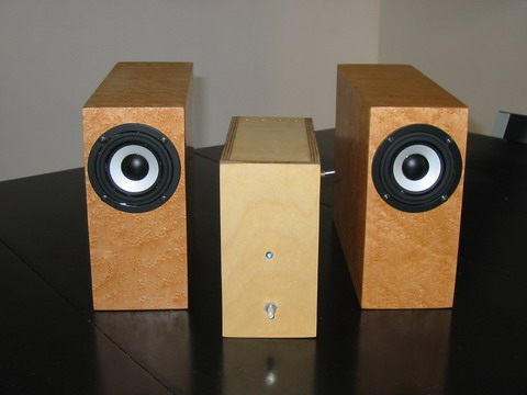

I just finished my first DIY project. The reason why I started this one, is that I live about 3 months in a year at hotels. I carry around laptop computer full of ripped cd´s and movies. Until now I have used quite basic active computer speakers that you can find anywhere (and they allways suck). Now I was fed up with those and made small speakers+amplifier set that is easy to carry around. The qoal was to get decent sound quality in small size with cheap components. You can see the result in attached picture.
Speakers: W3-871S in about 1.5 liter closed cabinet. Walls are 12 mm thick plywood. Simple BSC with 6.8 ohms resistor and 1.5 mH inductor.

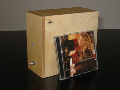

Amplifier: TDA2030A in inverting configuration. No pre-amp stage, just potentiometer. 40 VA Transformer with 12-0-12 outputs.
I´m actually quite happy (and proud) with sound quality. Cons are obvious: No real bass, limited SPL and dynamic constraints. But in other ways this system sounds nice and clear and it is possible to relax and enjoy music without being distracted by errors in reproduction. Even tough there is no real bass these speakers sound quite punchy with rock music at low volume levels. I think highish Q-value makes the punchiness in kick region somewhere around 150 Hz to 300 Hz or so. This kind of makes up for lack of deep bass. Amplifier is practically dead silent without signal. You have to turn volume control all the way up and place your ear next to driver to hear slight hissing sound.

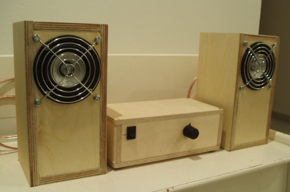

Exactly!
Can you give a description of the speakers (preferably with plans) and the strenghts and weaknesses of this system? How do they sound and/or compare to other systems or set-ups?

Very nice set Ralph. Fine finish.
Well, maybe Jordan JXR6 HD would be ultimate driver for mini full range speaker at the moment. I think it would work as straight replacement for W3-871S in my enclosures and it would nice to hear it for comparison.
How small should micro setup be? At size of my speakers there hardly is other options than closed or BR enclosure. That mini TL is twice as big.
