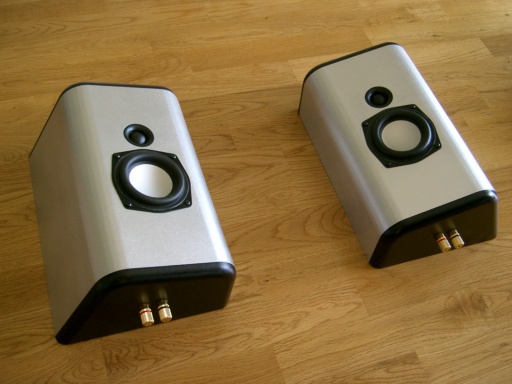

I honestly don't know what those size figures are in inches, but here's a project with relatively small size compare to other speakers.
http://www.zaphaudio.com/audio-speaker20a.html
A bit low in efficiency but will actually go lower than most other small satellites about the same size. Definitely cheaper than the Jordans as well.
