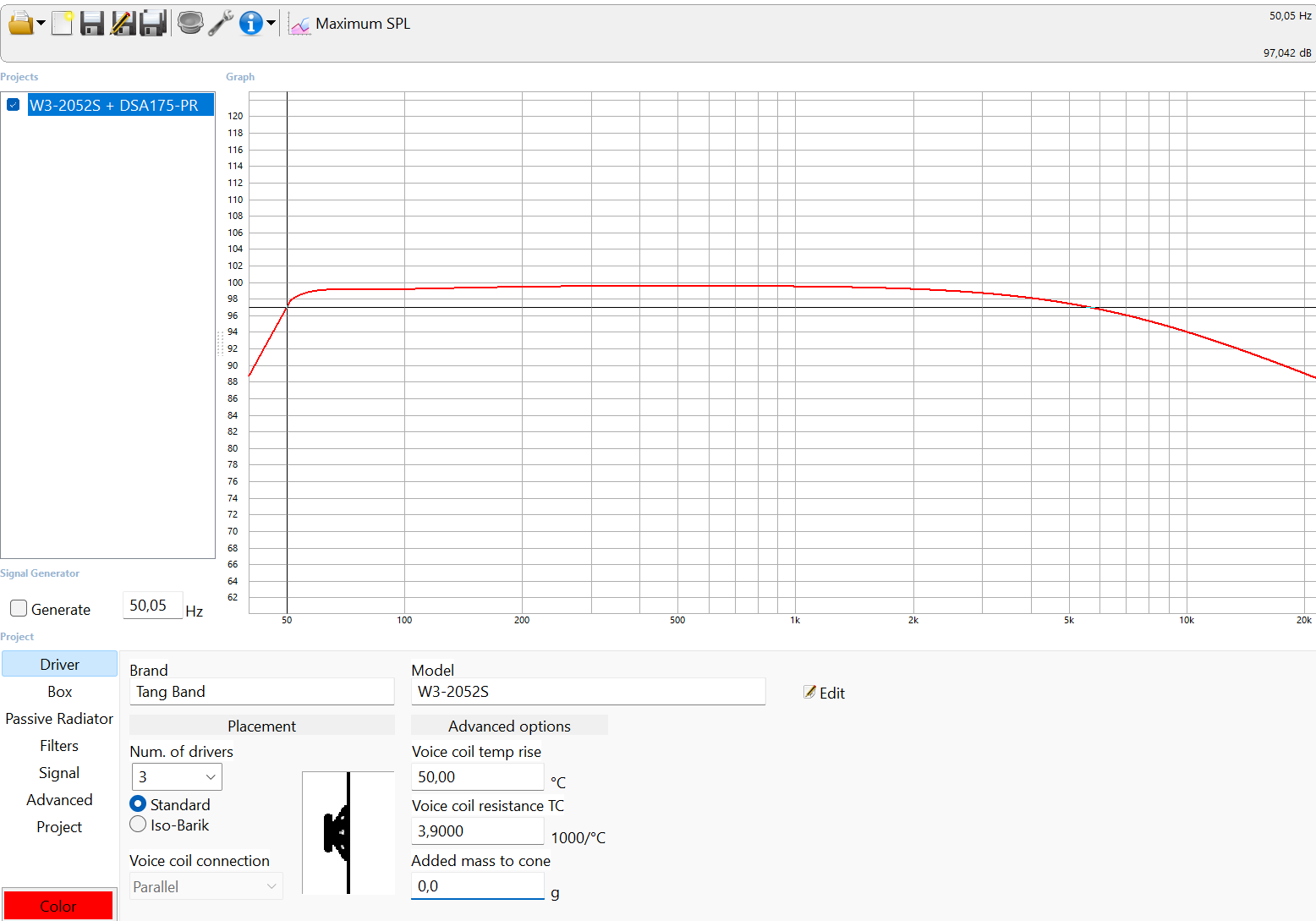

I want to build a small and lightweight speaker that I can take with me while traveling.
Yes, I know there are tons of products out there already, but I really enjoy building my own gear instead of just buying something off the shelf.
I'm also hoping to get better performance than a typical JBL Xtreme-style speaker.
I'm already quite experienced with electronics, so that's not a problem. However, I’d really appreciate some feedback from the diyAudio hive mind on my current plan.
The enclosure will be around 18×18×8–10 cm and made from carbon fiber to keep it lightweight. All components were chosen based on size and weight.
So far, WinISD suggests I should be able to get around 99 dB SPL @ 30 W without exceeding Xmax (for both the woofers and PR), and around 49 Hz @ -3 dB.
However, distortion looks decent up to 2 kHz, so I’m wondering if I can push the woofer that high and just tame the response peak with the DSP?
Even so, the tweeter would still need to go quite deep. I'm also unsure whether the ND20F-4 is the right choice from a distortion standpoint.

My goals:
- Small – max. 3 L internal volume
- Loud – ~100 dB SPL
- Lightweight – <2 kg
- Low-end extension – 50 Hz @ -3 dB
How do I plan to achieve this?
- 3× Tang Band W3-2052S – 3" woofers
- 2× Dayton ND20F-4 – ¾" tweeters
- 1× Dayton DSA175-PR – 6.5" passive radiator
- Custom PCBwith:
- Custom 4s 21700 battery pack

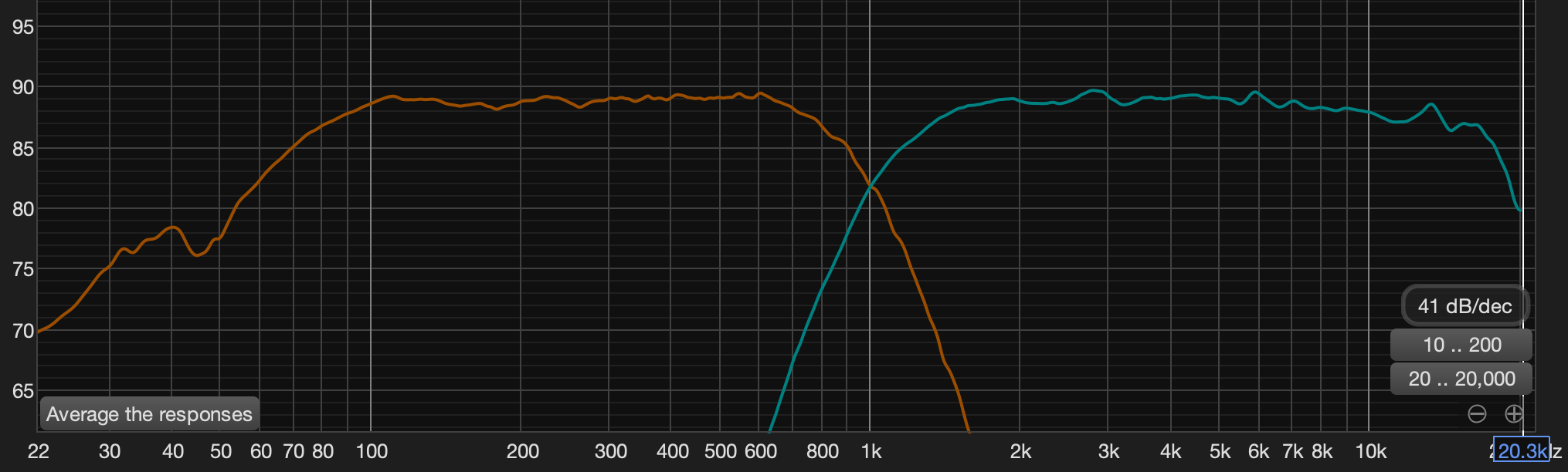

The real issue: Woofer/tweeter crossover
The W3-2052S shows some signs of ??cone breakup?? around 750 Hz, according to Voice Coil Magazine measurements (available on Tang Band’s site).However, distortion looks decent up to 2 kHz, so I’m wondering if I can push the woofer that high and just tame the response peak with the DSP?
HiFiCompass did some measurements: LINK
Looking at the HD response at 315 mm, -30 dB H2 at 2 kHz doesn’t inspire much confidence.

Just some thoughts:
It's an interesting project, keep it up!
- Two tweeters nearby will exhibit strong lobing and resulting comb filtering. Use one tweeter instead.
- Three midwoofers driven up to the tweeter may also show some lobing. Maybe use two of them as 2.5 way woofers?

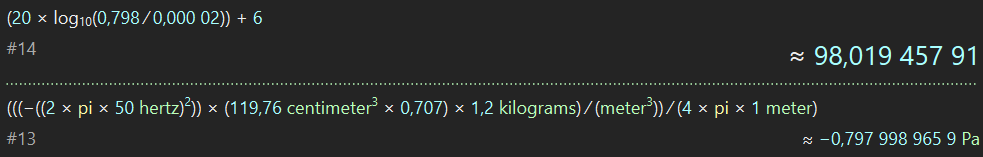

- are you sure you included baffle step in your max spl calculation? Or do you plan to use the speaker near-wall?
- your enclosure walls look very thin. Pressure in a resonator enclosure can get quite high.

The enclosure is very thin indeed, I intended to laminate 3x 200g/m^2 carbon fiber with a 2mm PET foam core, which should give me around 3mm wall thickness with an equivalent strength of roughly 1,5mm of mild steel. That is hopefully enough to keep it stiff / damped enough (due to the foam core) while still being incredable light. Braces are planed, i might end up connecting the inner walls with a cross brace depending on the actual performance of the housing.

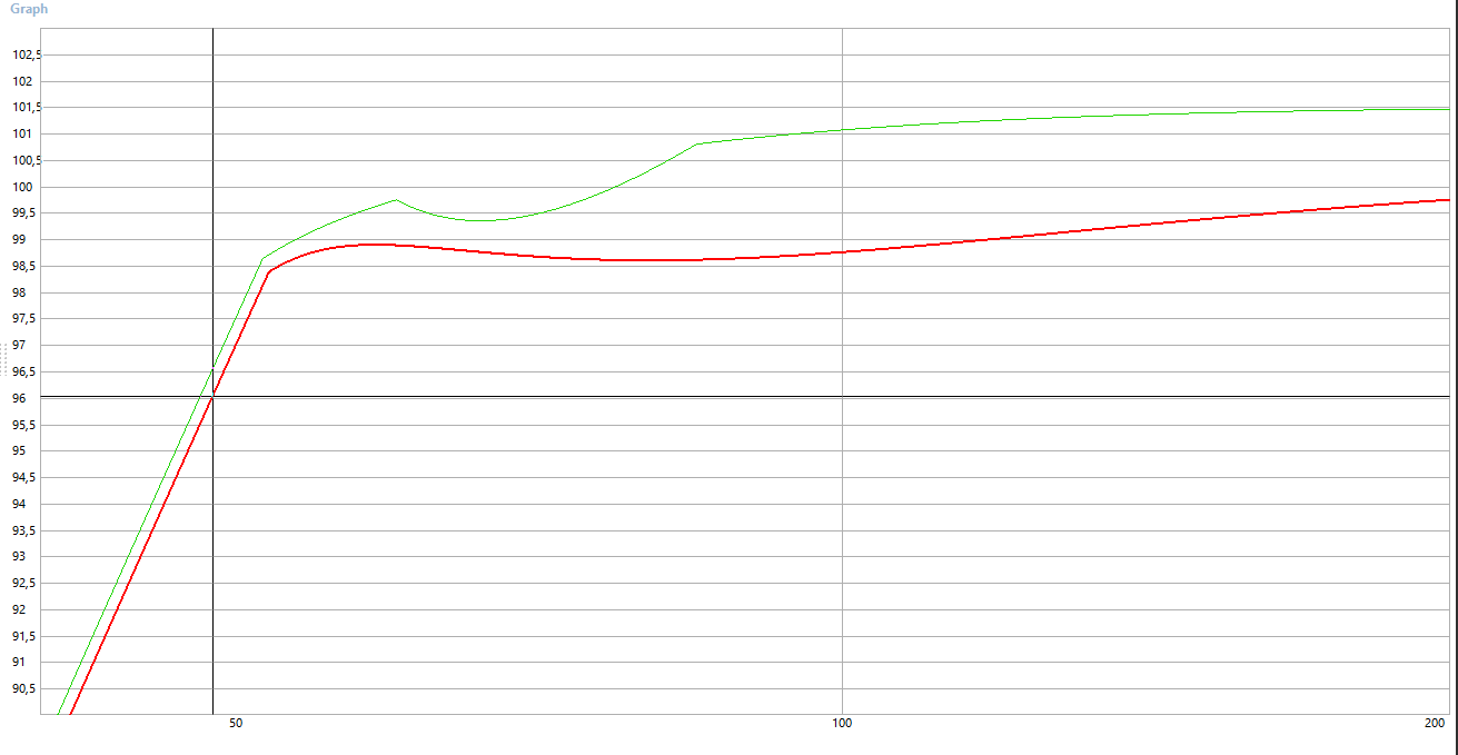

The W3-1876S puts out a tiny bit more but runs into X-max. (Red: 2052S / Green:1876S)
Both are very similar, the 1876S might even be a better choice depending on how high it goes..
However i already have the 2052s 🙄

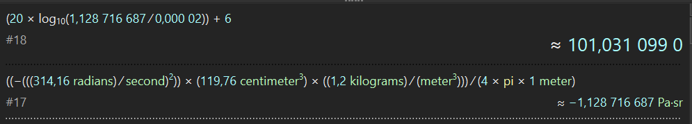

Running three, with 3x the power, gives them +9,7db compared to running a single one. So they should go close to 100db, maybe even over if i just care about x-max and exceed the power rating by a little.

It's pretty common to start with quasi-anechoic measurements indoors to get the basics of the crossover worked out. 4 ms isn't that bad given your cross point (if that's reflection free).
Later, in-room response can also be used to make adjustments. If you set your window to something like 100-200 milliseconds, you'll have much more resolution and you'll get a better feel for what the bass is doing. Of course room reflections and modes will be heavily influencing this measurement. And keep in mind that most speakers will have an in-room response that gradually slopes down with increasing frequency. How much is a matter of personal preference. As you implied, your EQ for use outside will likely be significantly different though, since you won't have any bass reinforcement from the room.
It's hard to say where you are at this point. Your design is definitely stretching things a bit with that tweeter, woofer, and cross point, but whether that's the issue or a more basic frequency imbalance is to blame is hard to say without seeing more data.
I doubt comb filtering is the explanation for the harshness though.

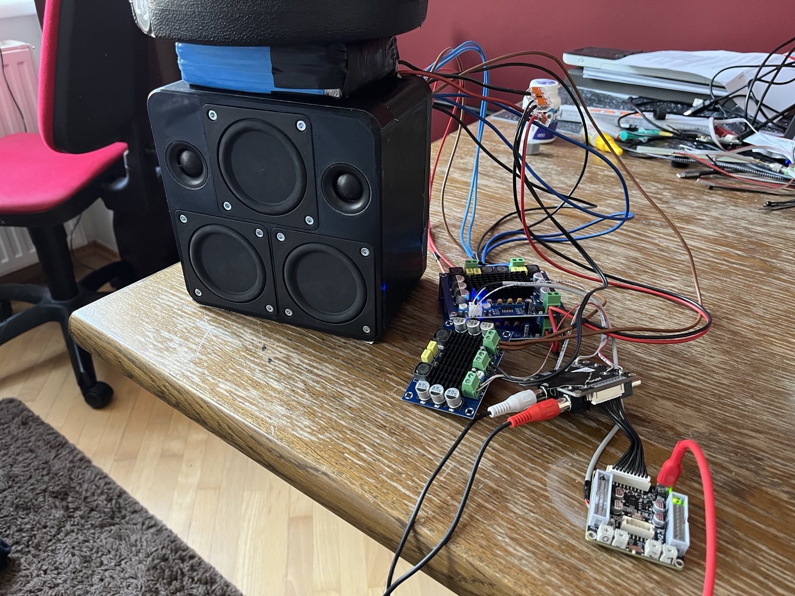

Thats my housing and prototype setup so far:
Just some very cheapo class D boards and an Wondon AMP2 as the DSP.
The amps are crap, not sure what they did wrong of the the chip is just a copy and not a real TPA3116, it has a crap ton of noise / high noisefloor.
So maybe the reconstruction filters are also crap and therefore they introduce quite a bit of distortion. I didnt measure that.
Maybe i should go with a single bigger tweeter to get the lower cross and eliminate comb filtering. I could also eliminate a complete amplifier channle and save space/weight/increase battery runtime.
Any opinions on stereo image for these small setups? Worthless anyways? I played some music while switching between mono sum and stereo and honestly couldnt hear much of a difference.. However it feels wastefull not to include two channels. Some phones are able to create good stereo seperation with two very close speakers. Maybe i can do some stereo widening with the DPS.

I ordered two and they surely measure and sound better. 😀
It doenst sound as harsh anymore I attribute this to lower distortion.
Hopefully the sound difference isnt just my subconscious telling me i payed more so they must be better.
Here are some measurements with REW
(nearfield directly on tweeter and woofer after crossing and EQing - ignoring PR response)
I moved to a linkwitz riley 48db crossover at 1khz to better control the cone breakup of the woofer and safe the tweeter from too much low end.
The measurements in REW are still with LR 36db crossover.
The measurement at the end is at just 30cm distance with reflections. I seem to still have phasing issues, but i think i will work that out with the real housing.
I have the tweeter just sitting on top of the 3D printed housing.
I also need to check how much the baffle will influence this in the far field.
I included the raw measurements of the woofer and tweeter before EQing and crossing.

You seem to imply that WinISDs simulation can’t be trusted?
It’s telling me I would get 97,4db@50hz = 100db with -3db @ 50Hz
At just about 30W with just 1,75mm excursion on all 3 drivers.
Xmax for the active driver is rated at 4mm - it measured 4,2mm and 4,8mm for 20% distortion based on Bl (moving out of the magnet field) and compliance.
So i dont think it will be the issue here.
PR is right at the limit of 8mm, that might show some more distortion.
Even with 50°C temp rise on the voice coil i still get 97db.
However that's all debatable if that really matters. First i dont expect super clean and audiophile sound out of a tiny portable speaker and secondly i will add harmonic distortion ON PURPOSE anyways!

Just to check a different way: (as it really sounds much from such a small enclosure)
Svante posted the formula to calculate SPL based on volume displacement: Link
If we plug in the values from the PR (103cm^3) and the W3s (16,8cm^3) running at 30W we get:
101db SPL in 1/2 Space = standing on a ground plane not suspended in the air.
At least in theory it should work. I just added the displacements of the PR and the drivers, I assume this to be false.
If i just use the PR I get 99db.
If i subtract the drivers displacement, I get 98db.
So i am not 100% sure why there is some sort of loss, maybe its radiation efficiency or some out of phase behaviour of the pr and the drivers.
At least it looks like the math/simulation cant be far off - the amount of air moved by the driver + PR is enough to produce the SPL I am after.

Too late to Edit my post:
I found whats wrong: I ignored the RMS part.
If we use the RMS of the displacement like Svante said:
We get 98db halve space with the PR and woofer added. So much closer to WinISD almost spot on.
Hey,
for the calculation, you must only take the PR at the tuning point. For BR Enclosures, its either the driver moving or the PR, the relationship is shifting depending on frequency. You can see that quite well with WinISD. So for your calculation, i would take only the PR.
WinISD overall doesnt calculate the powercompression. Try to push your PR to 8mm by "hand", you will feel an increasing resistance above a certain threshold. I never encountered an afforderable PR which is fully linear to Xmax aside from Purifiy and Accuton Types.
Also vastly different: the actual SPL of the driver at 50hz (see the manufacturer measurements) and the SPL in WinISD. This one is a little tricky due to how the drivers are measured.
From experience, you can subtract around 6db from the winISD max. SPL Prediction (WinISD doesnt simulate free Air btw.)
The Harmonics addition is a well known practise, but the THD is a controlled one and cannot be compared to the THD coming from a driver out of Spec. General guideline for non-hifi would be <10% THD up to 200hz and <1% THD above.
I think you will achieve around 95db@70hz. By the way you dont happen to be german, judging from your name? 😀

Hallo fellow German 😉
WinISD shows exact excursion for both the PR and the active driver. There is no sense in not including the drivers excursion. However even if we do that its still in the ballpark as the active drivers only move very little like you said.
Power compression: I think you got this wrong, Power compression only happens on active drivers- The voice coil heats up and increases in resistance resulting in less current at the same voltage so you end up providing lower power at the same voltage.
WinISD can calculate its input, you just need to input the voice coil temp rise - which i estimated to be 50K above ambient = 70°C.
This still didnt result in significant power compression.
95db at 70Hz is way off. I will certainly measure that when i get a suitable housing.
I think you are very much overestimating the impact of the distortion and "power compression"
In my experience, WinISD is close to spot on.
Do you have any real measurements / comparisons with WinISD on known power with a calibrated mic?
