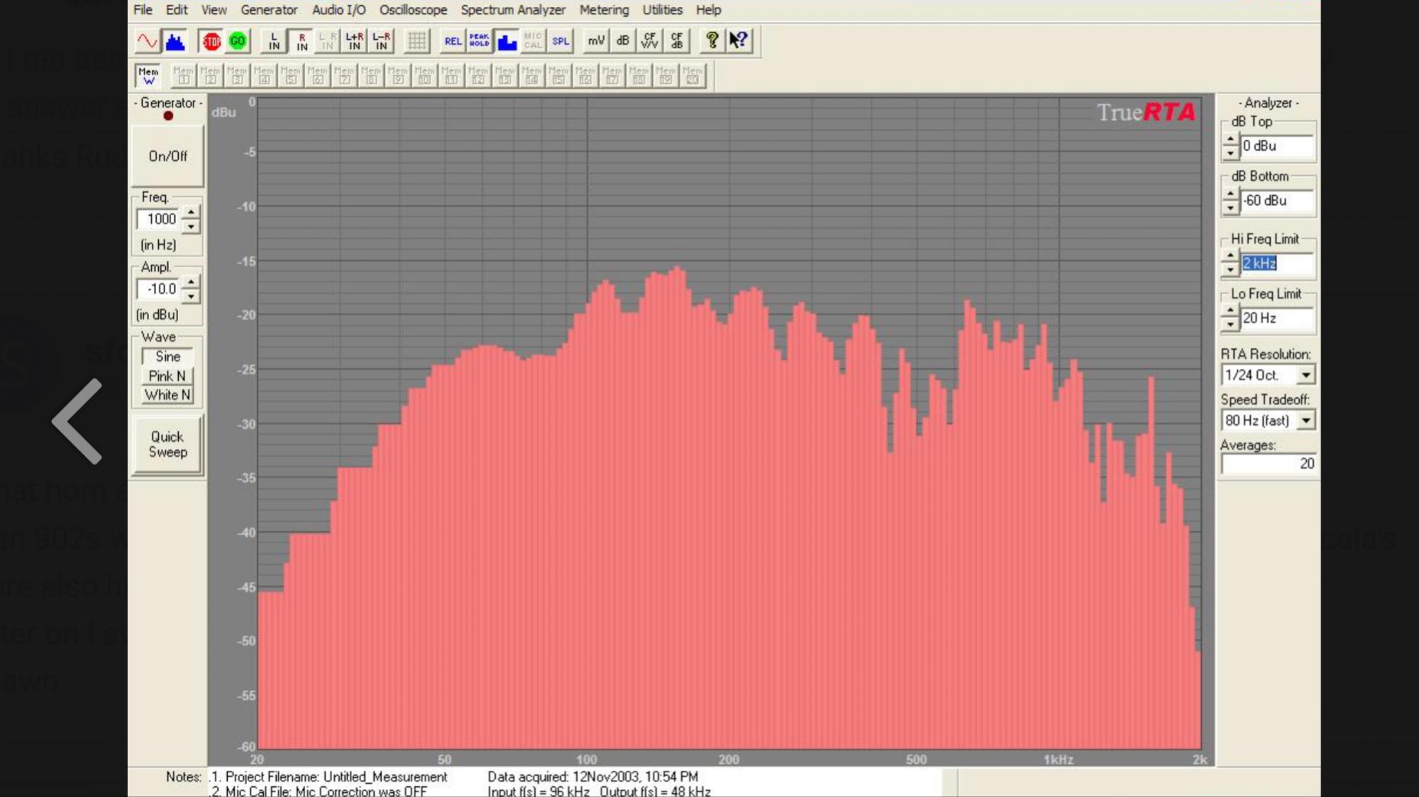

due to various problems - then winter with no heat in my big room (to save $), I've not yet loaded my "baby" Belle. It should run ok with my 12pe32 or Kappa12a. That's a Klipsch K700 horn (from Heresy I) sitting on top for size comparison. The initial problem was with a thin spacer warping when trying to load a speaker - there has to be something to keep the cone from hitting the throat plate.
A Question - - GM, when using hornresp and looking at the directivity of these little midbass, its typical to see a predicted on-axis rise of 7dB or more vs "flat" response. In practice - does that happen? (didn't see that with the 100Hz "hypex" Edgarhorn and 2220H on-axis outdoors) What I think may have happened was it was "flat" on axis and would have dropped that much off axis at a certain point. Maybe its case by case ?
Here's how hornresp shows a horn scaled roughly from John Inlow's drawing of his 135Hz horn. The back chamber is pretty tight
DB would have to answer that since I've never measured it nor felt the need to pay much attention to it since I relied on the known excellent HF hearing of others, though IIRC I've got some some accurate Altec polars I can check.
I do know that the ones done for deep cone [Altec] and shallow cone [JBL] woofers showed that Altec's pretty much followed the piston chart whereas the JBL's were 'all over the map', though apparently due to more flex, so would think that a horn would be similar to the piston if just basically a horn, i.e. not multi-cell, Smith, etc..
Well, if the compression chamber is tuned too high, then it will have a rising response like simmed, so tune it to the horn's BW mean for best overall performance: [Fl*Fh]^0.5
