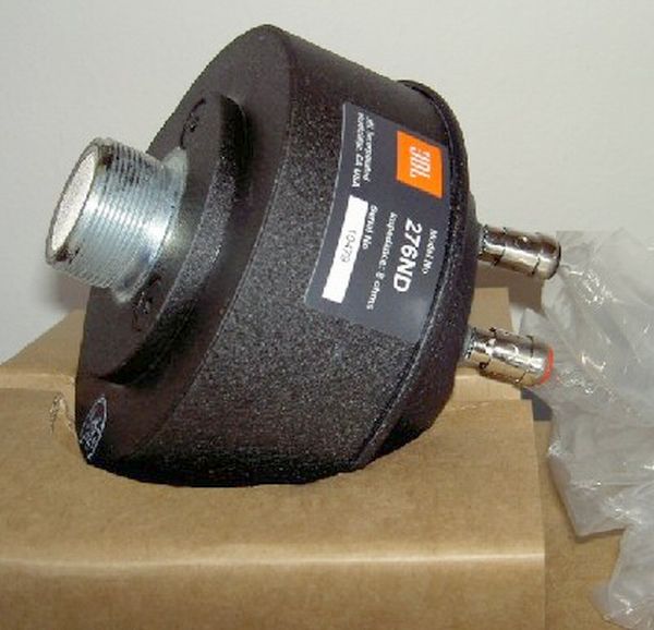

Here's where JBL used the 276ND .
It's found in the older Synthesis 2 line , in the model ; S-2M L/R .
For those of us familar with JBLs' product offerings, it's obvious that this driver is a (Nd) variant of the 2426/7 . ( The replacement diaphragm is the giveaway .)
FYI; the 2427 was made by adding a screw-on 1"-2" adapter onto a standard 2426.
Your 276ND seems to have it's own ( bolt-on ), 1" to 2" adapter .
Your adapter might be removable / leaving a standard 1" exit, 3 bolt
driver ( ND ) . Then you can use a 1" entry, bolt-on, waveguide/horn .
How about a picture of your driver ? ( I've never seen one of these drivers )
<> cheers
PS : a search for 276nd , over LHF , returns quite a few references to this driver / though with little actual information .
JBL 276ND ?
cool, here it is!
bas Driver jbl le120h-1 12 inch
midrange jbl 726 gs 6,5 inch
compression driver jbl nd276 2 inch throat
horn:? 15inch wide/ mouth 3,5 inch tall and 6,3 inch deep
best regards
panduro
This compression driver has a 1" dia. throat.
Horn mounting is via 1-3/8"-18 male thread.
WHG

Hi again,
hmmm im embarresed now, that shows how little i know about comp. drivers and horns.
SORRY
the picture is the same driver as mine, mine is still in the box.
Seller said it was a 2 inch, but apparently he didnt mean 2 inch throat😱.
Thanks alot guys, that widens my options alot i suppose.
Just to besure, I should have been looking for a 1 - 3/8" throats?
