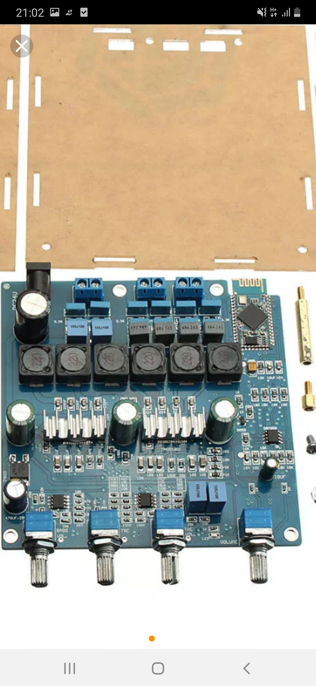

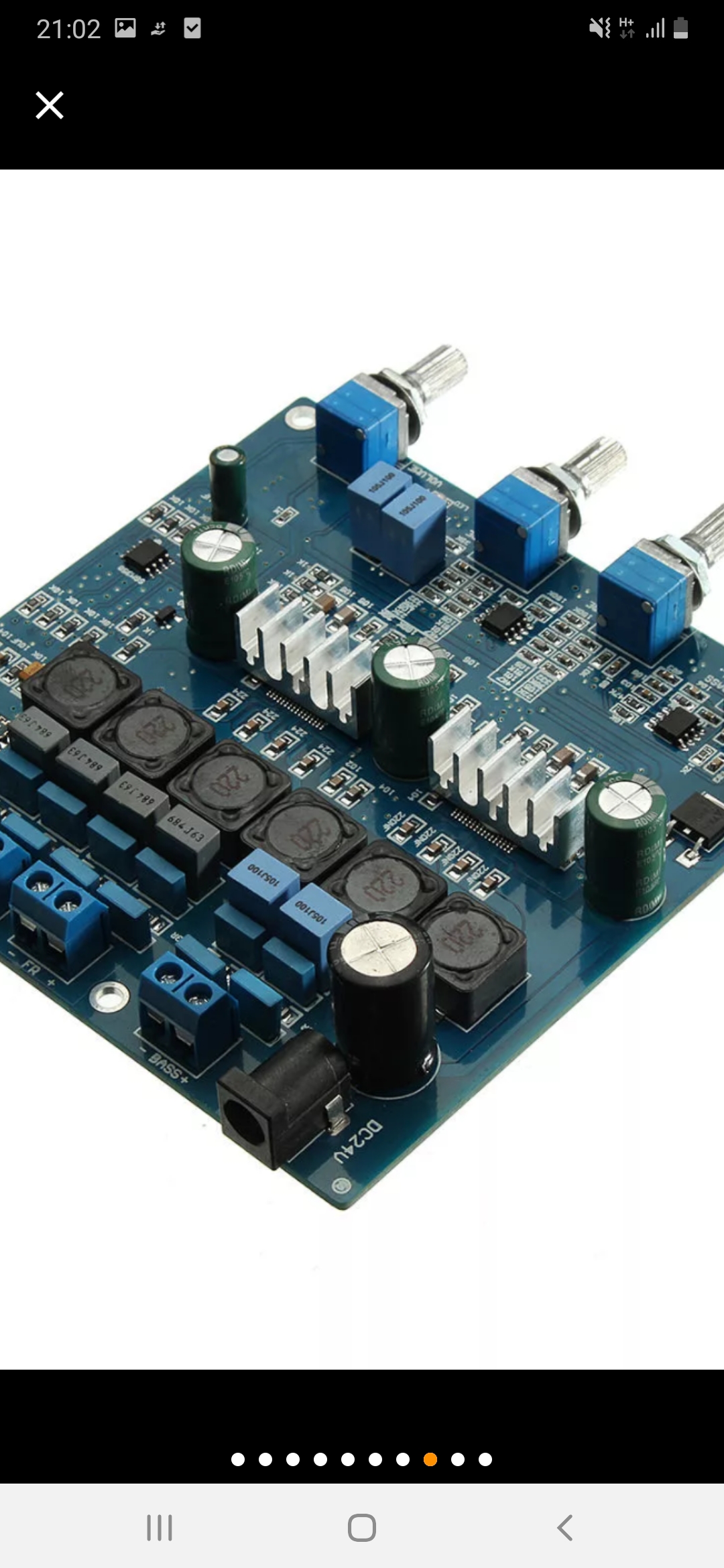

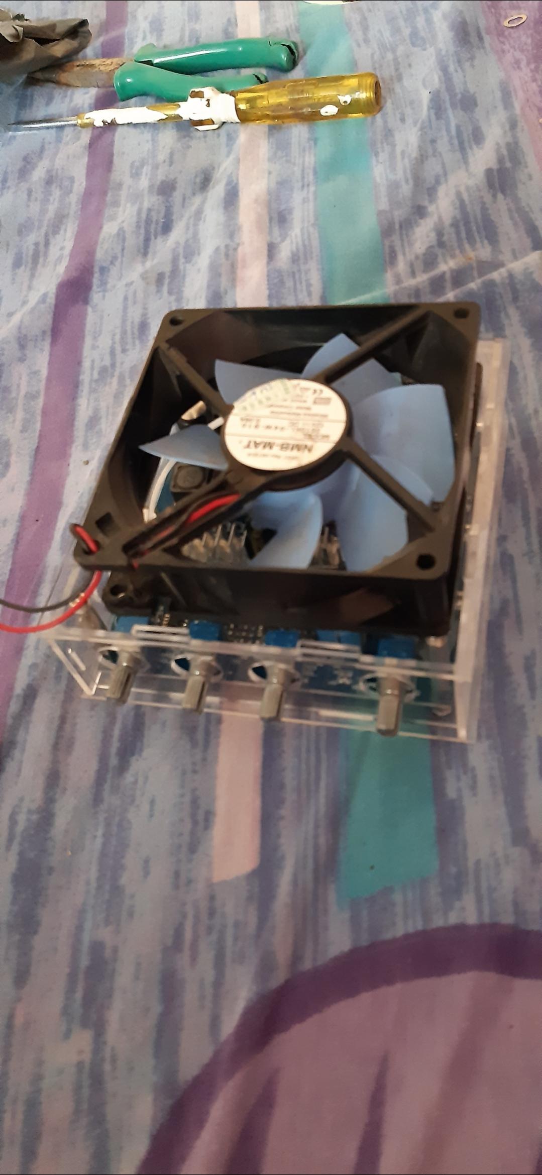

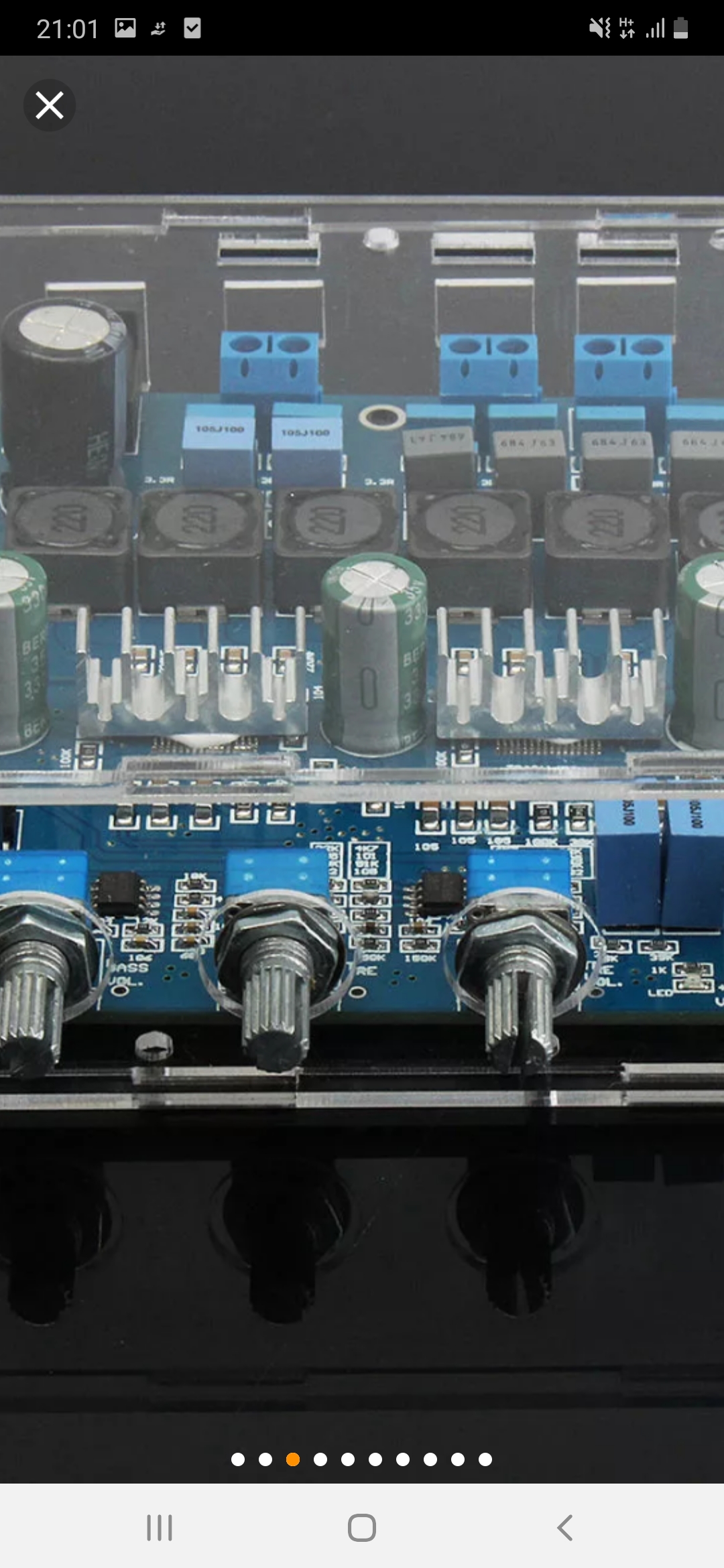

I am planning to buy this amplifier TPA3116d2 and I was wondering if these small heatsinks are sufficient enough on this amplifier.
I am planning to run 4 car speakers with one sub woofer from my Philip's hometheatre with this amp running on 12v.
Is it going to be ok with these little heatsinks or do I need to add any fan on top of it.
Please do suggest on this.
TIA.

Hi digitaled,
If you are going to use a 12V supply, the small heatsinks should be sufficient as such. My only concern is that the amplifier is enclosed in a plastic box. The heatsinks are not very efficient when enclosed like that. Eventually, drill some ventilation holes in the plastic below the board and above the heatsinks and use a low noise fan to draw air through the cabinet.
Do not use below 4 Ohm loading for the two stereo channels.

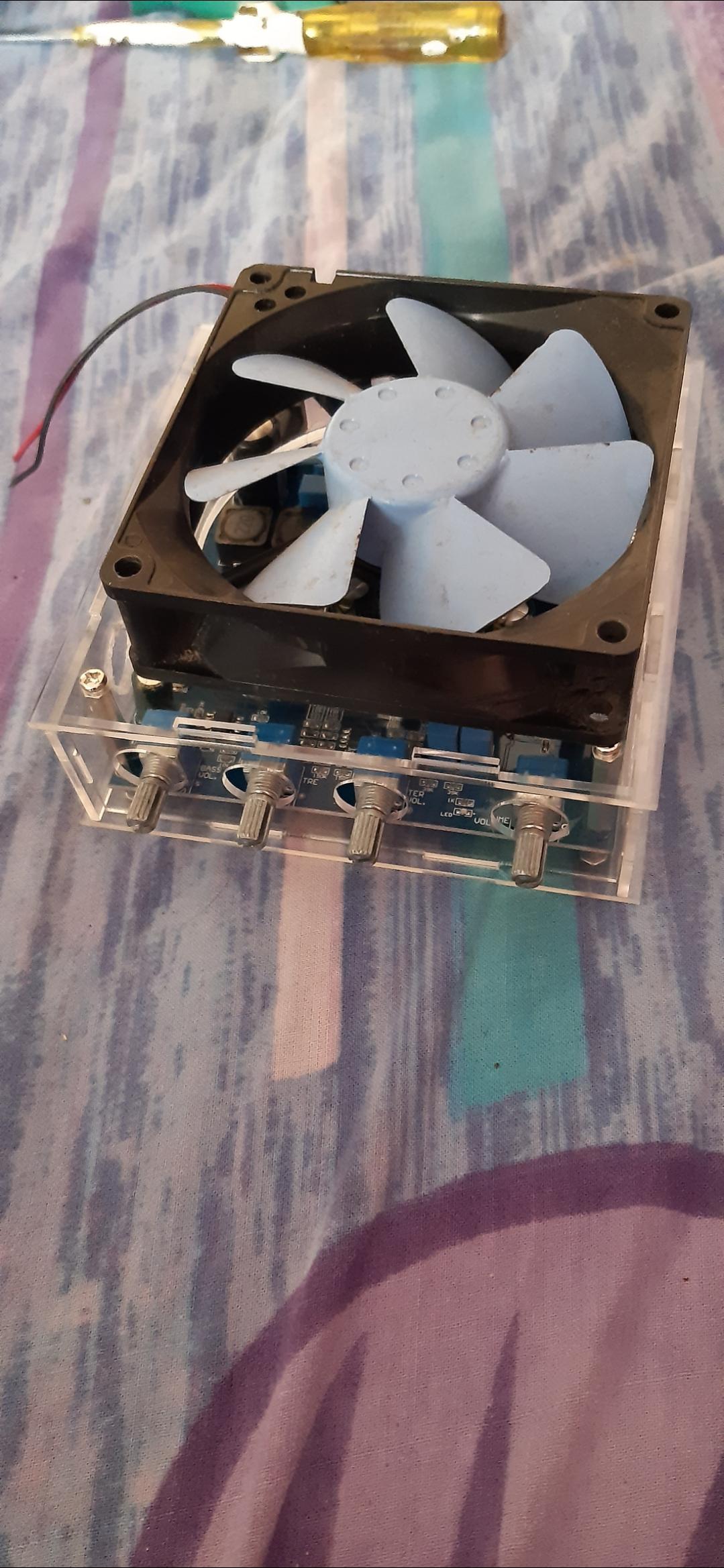

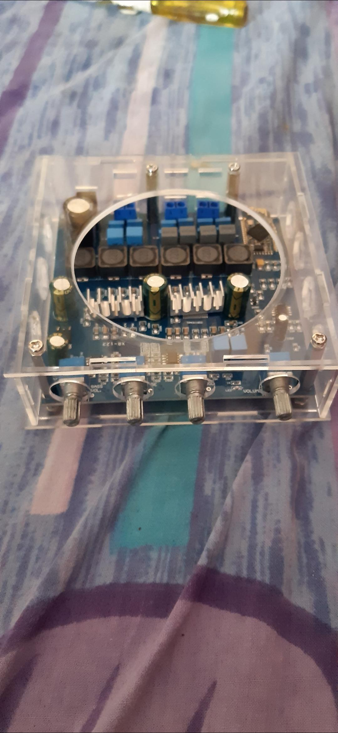

Thanks much for the reply and I will be using a small fan either on the sides or from top to cool it down.
Another thing is that it says it's a 2.1 amp however the setup that I have is
2 front focal component speakers and
two basic factory fitted rear speakers
and woofer from my Philip's home theatre.
I have tried running these with a low cost and low power lepy 168 plus amplifier which has 4 outputs plus subwoofer output and they sound amazing.
But as this amp says its 2.1 is it fine to connect 2 speakers per channel on tpa3116d2. Would it overload the amp or it's going to be fine.

The woofer goes evidently on the sub-output.
The problem is the 2 front speakers and the 2 rear speakers. Unless they are 6-8 Ohm, in which case you can connect a front speaker in parallel with a rear speaker (you get 3-4 ohm as result), you better connect them in series.
The problem with almost all of these "2.1" class d amplifiers is that there IS a low pass on the subwoofer out, but there is NOT a highpass on the two channel out.
This really kills the whole point of having a sub, as your main speakers still need to handle all the bass. 🙁

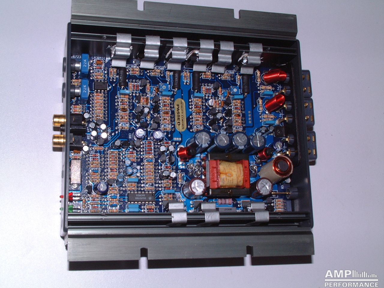

The wonderfull concept of car HIFI has been perverted by the "Boom-Boom style" of certain age/mental health groups. BOSE has done the rest to convince people like you that Car Hifi is for ear less cretin´s with size deficits in the public area.
My last installation was in my daughters first car, a VW Golf 3 and consists of Seas 25mm tweeter, 16cm cast basket mid-low and two Canton 25cm woofer.
This is driven full active, with 2x30Wrms and 4x140Wrms amplification, directed by a head unit that matches delays and response with a microfone, like Audessey.
Speakers are from Norway, Italy and Germany, amps Italian and the Head unit, sorry, by Pioneer. All these components would not be displaced in a very good home stereo.
You are invited to bring your favorite CD and have a drive. I´m pretty sure you will take a very long ride...
It is a very unusual experience, if you listen to fine music, while the world passes by like a 360° video in perfect graphical resolution. There is no need to hear loud, but the absence of distortion makes it possible to hear and feel music at live sound pressure levels. After a short while you accept that the stage, the music plays at, is much larger than the physical size of the car. It is like a concert in the first row.
The interior of a car is weird for usual loudspeakers, but if you do it right, can net you an experience not often found in home Hifi installations. Reflections can help you to project sound, instead of spoiling it. Oh, by the way, the installation is invisible, except the head unit.
There are very few, good commercial available installations, most highly expensive luxury car "Sound System´s" are just that: Sound effect producing gimmick´s for people with too much money to spent.
It is getting much harder to do car Hifi today, as the European laws actually prohibit you from installing parts in a car, that are not approved by the manufacturer. Off course VW, BMW or Mercedes Benz do not approve any custom installation, this is killing a whole Industry for the auto makers profit.
To me old cars get more attractive by the hour...
PS picture-Italian made 2x30W amp inside

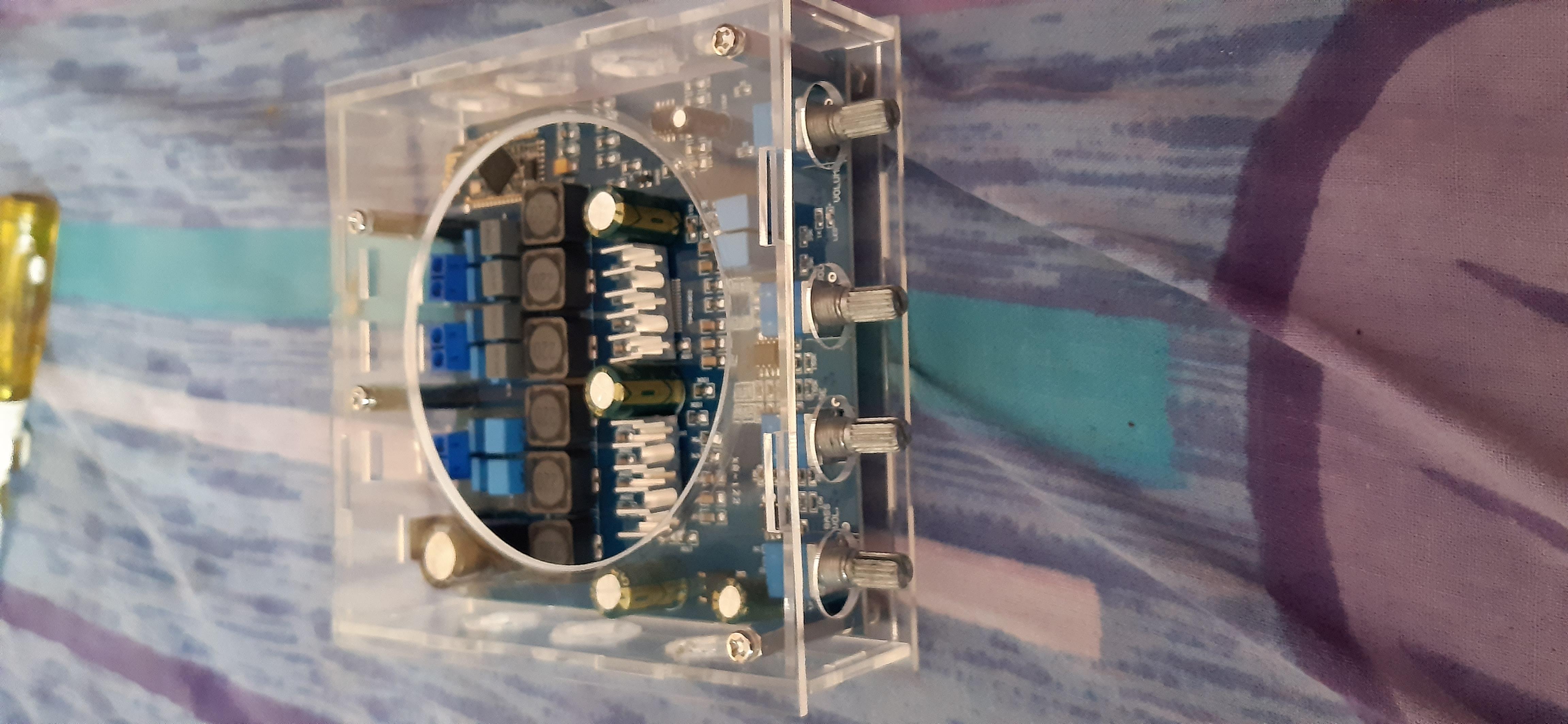

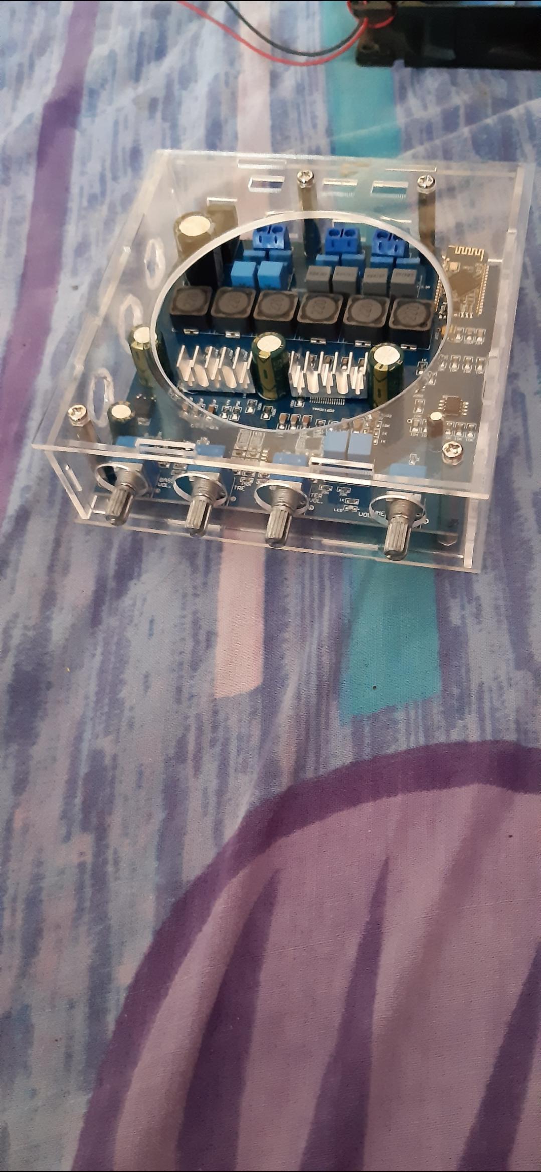

So today I got my amplifier and as suggested earlier installed a12 volt fan to it.
I was not having a small fan so use this regular size fan on top of it and on the sides I made some holes for the air ventilation definitely looks funny but it's going to to be hidden in the car so I guess it's fine until unless the chip itself remain cool.
Now here's a new problem that I have after connecting it to the 12 volt supply in the car the output is great its loud and powerful with all the speakers and the woofer connected but the sound was coming bit distorted.
it was little bit distorted not completly clear and then I tried in my home with a regular 12 volt volt adaptor and sound was perfect there was no distortion at all now.
Can you please tell me how can I fix this problem.
Do I have to buy some sort of power supply for any adaptor that can fix the distortion in the car.

Could you describe what set-up distorts and what components do not? Don´t get the picture from your post.

Your chassis looks good!
The distortion may be caused by the same phenomenon that irritated hansueli for a while. It seems that batteries are not suited for direct supply of an amplifier. They seem to react only slowly to changes in the power consumption while an amplifier is a very dynamic load. For temporary energy supply to the amplifier you need good power line decoupling capacitors. The amplifier has only little decoupling on-board. Connect some 10000uF (25V) near the power terminals of the amplifier and see if the problem disappears.
