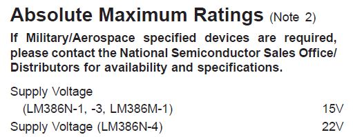

I forget which LM386's I ended up getting, actually bought them a while back then got busy and well, ya... kinda resurfaced the other day which is why decided to make the amp finally.
If I recall, the higher the last number is the higher the wattage for the speakers, which is why I think I went for the LM386N-3... though power wise, since using a 9V battery I think I'm safe in that sense.
