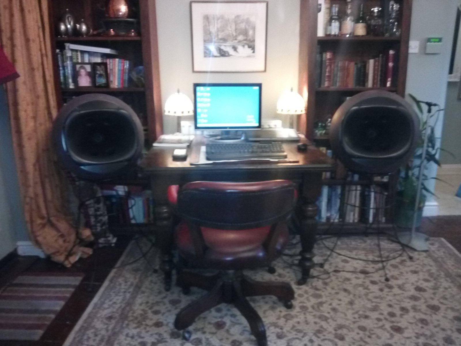

My latest iteration of the batcave system is a cheap 2" driver loaded into a tractrix horn
I am getting useable response from 200hz to 16khz. Below is a 15" woofer in a U frame with response down to 35- 40hz in room. Subwoofer support is in progress
The clarity is exceptional especially in the lower midrange and upper bass. The sound is very accurate and clear on axis with the point source covering most of the audible range

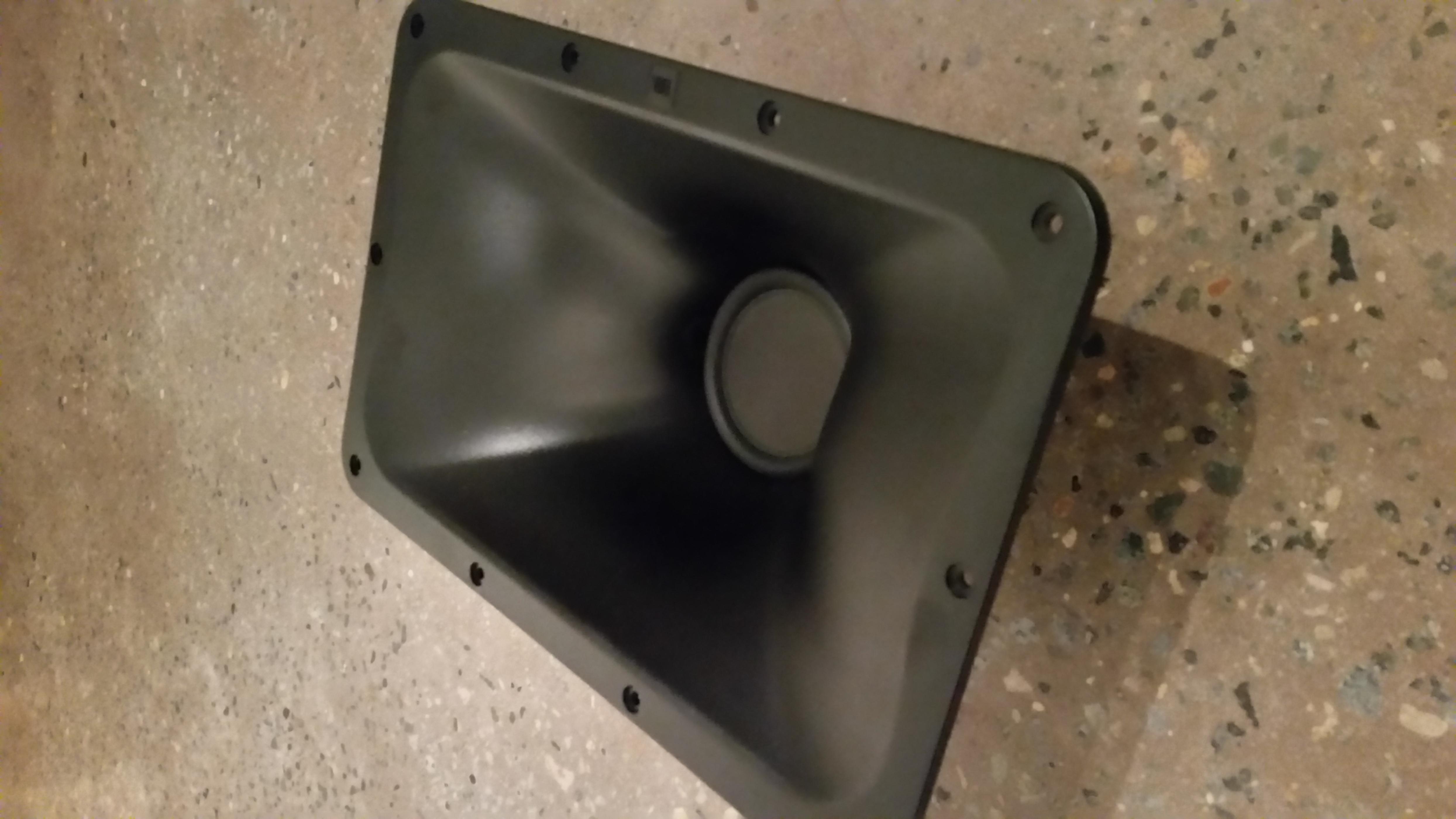

Next ill try some 3.5"-4" drivers in a JBL conical midrange horn pictured below

Note, the JBL is not a conical 🙂 They have some daft 4-letter acronym for this type, which loosely translates to "a normal horn with a bit of butt cheek mixed in"
http://www.jblpro.com/pub/obsolete/2404.pdf

The current set up uses a 2” Hivi / swans aluminium driver. The woofer is a PRV 15W700; this driver has a low Fs for a pro woofer and highish QTS so works well in the U frame.
Amps are alternating between a JLH class A amp (10W) and a GU50 tube amp (10W) for the horn and a pro audio amp for the woofers. Crossover is a minidsp 2 x 4

The 1.4” CD in the azurahorn sounds a TOUCH more dynamic and open. It worked better in my old room but in the highly reflective batcave they are harder to tame. In this room the tight dispersion of the large tractrix horn wins (at the expense of he sweet spot size) as does the ability to have one driver covering such a wide range
Thanks for the correction on the JBL horn profile. I stumbled on a second hand pair on ebay but I believe they can be purchased from JBL suppliers in oz. They have a 100mm diameter throat which should fit the scan speak and seas 4" full range drivers

I'll see if i still have the measurements. This was meant to be an experiment but i havent been able to stop listening to it!
The horn boosts the low end a lot and allows the fullrange driver to play easily down to 200hz without sounding anemic. I think in that sense it is better than a standard FAST arrangement at the expense of size.

The horn is a tracrix expansion with dimensions 24w x 16h x 21d in inches

The horn is a tractrix expansion with dimensions 24w x 16h x 21d in inches

I aquired the horns from a local DIYer. They are made of stacked MDF fillets and sanded smooth. I dont have the time or patience to build curved horns myself 🙂
