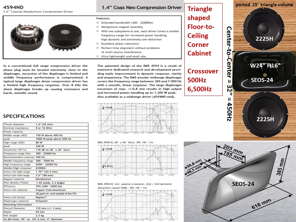

GOAL: High SPL Point-Source Illusion from 90-degree corner triangle speakers
WTW using your four JBL 2225h woofers in tall ported triangle volume, and a 8" deep SEOS-24 waveguide + 3.7" deep BMS 4594ND coaxial compression driver - crossover 500Hz and 6,500Hz. About $850 for 4594ND + SEOS-24. The SEOS waveguides has 90H x 40V polar pattern, and is shorter than the common horn profiles. Contact diysoundgroup.com to find out if they still have/get SEOS-24 waveguides($230)
I have not seen a proven design you can direct-copy, but a 500Hz LR4/LR4 crossover to the JBL 2225h and BMS 4594Nd could come from bi-amping, or passive parts.
If you can accept a deeper cabinet ~24" total, you can find a 500Hz horn(~17" deep JBL 2350) for your 2" JBL 2440(~5.5" deep) compression drivers and add a 8,000-20kHz super tweeter.

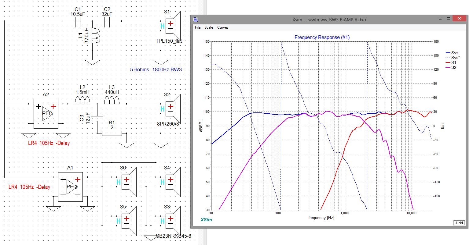

Best "small corner" high sound quality design I could think of today.There is just no Way i Can fit a 15” at an angle so it Can be a corner speaker.
WW-TM-WW using W = 8" diameter drivers less than 5" deep, built into a tall corner-triangle ported cabinet.
W = 8" SB_Acoustics woofer SB23NBACS45-6 (1x = $109.45) Madisound
T = Beyma TPL_150 AMT ( $340) USSPEAKER.com
M= 8" Faital 8PR200-8 ($195) USSpeaker.com PartsExpress
Estimate $973 for 6 drivers WW-TM-WW

Review a couple full range linearray builds to understand the complex DSP equalization that is required.These line arrays need EQ, no way around that.
A good WW-TM-WW design can approach a corner point source.
The controlled directivity treble from the TPL-150 is CLEAN... CLEAN... CLEAN
The coherence from a single Faital 8PR200 midwoofer is HONEST... HONEST... HONEST
The bass from four equalized 8" woofers is DYNAMIC... DYNAMIC... DYMANIC
The Beyma TPL-150 tweeter is a perfect 5.6ohm resistor, which simplifies the T-M passive crossover.
If you Bi-Amp between the TM and woofers, the crossover gets easier to adjust to your room.
