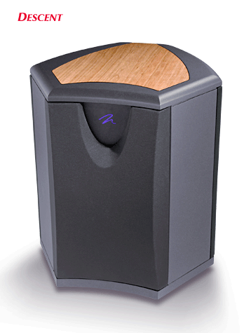

One of the best subs I've ever heard:
Notice the 3 10's are angled to cancel each others movements out. (push push)
http://www.martinlogan.com/descent_speaker.html#none
3 x 8" could do great at lower spl.
Rob
Rob
