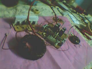

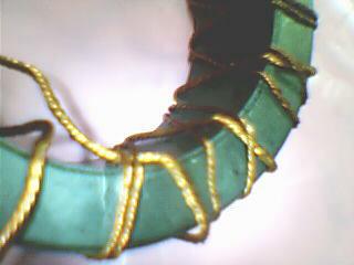

small crack in torroid!!future of torroid?
Presumably this is a mains transformer.....
As long as no gap exists (causing loss of inductance leading to overheating) there should be no problem IMO.🙂 You might be best to clamp it so a gap can't develop. Beware of accidentally creating a "shorted turn" if using a metal clamp arangement.
see the pic
this is the use.
in smps.

but with transformer,my smps not giving any o/p
switcher ok
mosfets.ok
rectifiers,ok
only this suspect remaining.
its giving me headache bec i spent ten times more than what the req core would have costed(its 14cm,only 5cm max req.)
hey
thepower supply being used is only 500ma.is it possible that such insignificant supply unable to bring up any appreciable change in flux so as to give o/p????
the test corei used earlier was 4cm dia and it worked.i replaced this core but not working.4cm has no crack@all.

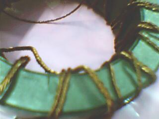

These cracks will reduce the permeability of the core, thus increasing magnetizing current and decreasing magnetizing inductance. It shouldn't be a big issue if the core is well clamped to minimize crack lenght, though.

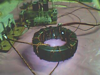

By the way, this is how a transformer wound in the right way looks like, it features 6+6:12+12 turns and it's intended for low frequency usage in the 30Khz range:
r u sure this big core is made of ferrite?
it can be iron powder and may cause saturation at a freq u were working with the small one .
i guess u got no scope , making things very difficult ...
check the supply voltage drop with a voltmeter while using the working core , then with this core . if with the big core the voltage drops drastically then its saturating i guess.

supply voltage drops to +5v from the +12v that the Vsource gives on no connection.but no such drastic drop with small core.
note::both cores are ferrite.i have iron powders' too.
now what to do?get it replaced,(very difficult)?anything else
try to use a trimmer (or a potentiometer) instead of Rt (timing resistor) and play with the freq , in the same time look at the supply voltage till u get the smallest drop . dont go over 100khz and below 10khz , i guess .

this is my second smps.one already working in car.the same huge torroid was used in that one.i tested that smps in the college using monsterous dc supply and power res.that smps supplied 900w continous!!(al setup was cool)i didnt go furhter but believe that it could go further to bout 1600w.
that one had no crack.this one has.size is same.

used heavy power supply,but to no avail.the voltage drop is not significant,so saturation can b easily rulled out.
o/p is still 0.all other modules ok(hooked them to other places where they can work and they did)
advise plz:smash: :smash: :smash: :smash: :smash: :smash: :smash: :smash: :smash: :smash: :smash: :smash: :smash: :smash: :smash:
take a multimeter , put it on resistance , look if the primary and the secondary are not shorted ....
check everything for short circuit -
between 1 primary and the other
primary - secondary
between one secondary and the other...
