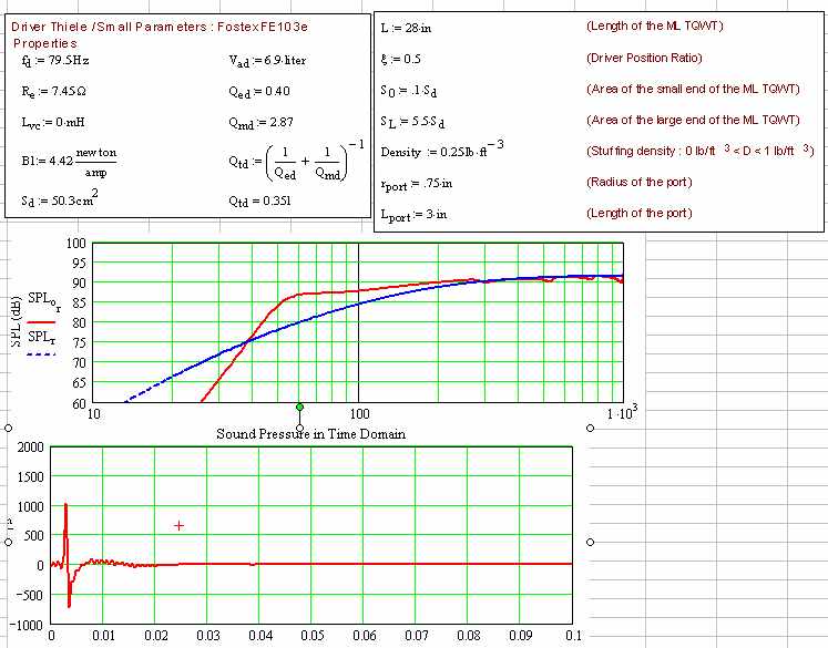

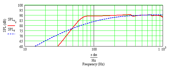

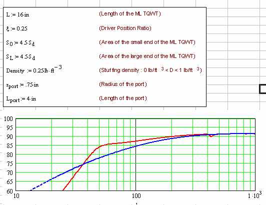

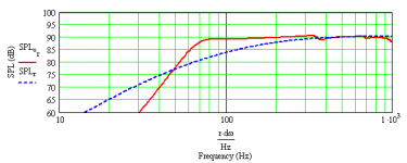

I'd like to offer a comment; It seems for both of these that the bass levels start to fall away prematurely. It looks as though you are trying to hit 50 hz, and as a result the response below 100 hz is depressed by at least 3 db.
I made a similar mistake on my project (bigger mistake, yours might not hurt so badly) in underestimating the effects of a depressed bass response. The rule of thumb that I heard was that this sort of enclosure can play lower than the driver's Fs (not necessarily a good idea)- all the way down to 0.7*Fs.. any lower than that is a much worse idea. I think that you might want to consider moving your target cutoff a bit higher; to 60, 70, even 80 hz- and use a small sub.
Hi Joe,
thanks for the reply, but I am not trying to go low, but rather, try to have a smooth roll off as I have notice that there will always be quite a bit of room gain under 100Hz. A flat curve to 80Hz and sharp roll-off is definitly not desirable. At lease in my case.

Many of us have concluded that the classic TL design is preferred unless the driver, for whatever reason (Q etc.) performs better in a tapered pipe.

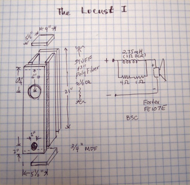

Dave Jones said:See the recent threads about the "Locust 1.0". It's a MLTL using the FE107E, which is like the 103, but with shielding and a somewhat smoother response.
I'm listening to a pair right now, augmented with a sub crossed over at about 70 Hz. Good stuff.
They are real easy to build, using 3/4" material all around. The port is just a 1" hole in the front panel. Internal dimensions are H 19.5", W 4", D 5.5". Driver offset is 6". Port (hole) near the bottom.

I'm using the Locust I's in a small room, and they are not at all boomy in the 70-100 Hz range. I have a peak at around 200Hz, but I think that's from a wall reflection. Those little speakers are simply not going to deliver loud, deep bass regardless of what kind of box you put them in. They are only 4" in diameter, and have a tiny xmax. I suspect that trying to stretch their low end response below 60 or 70 Hz would just create problems. I tried using them with some EQ on the low end, and they did not appreciate it! Now I use a sub with them, but on a lot of program material the little speakers sound fine all by themselves.

Thanks, Dave. I will probably built a box very similar to yours. Guess I go with the ML TL box as there seems to be no advantage in using the TQWT.
navin said:nice designs dave. do you have any pics? those boxes 21" tall 7" deep 5.5" wide look like they can be made a bit smaller if i use 6mm AL instead of 21mm wood.

There's a picture in this thread: http://www.diyaudio.com/forums/showthread.php?s=&threadid=36305
They are still raw particle board, BTW.

Those designs would go beyond "modification". Did you notice that the Locust I employs a BSC? Besides baffle step diffraction, I get a peak at about 200 Hz, probably from constructive bounce off the back wall. How is a second driver going to solve baffle step and early reflection problems?
Again, if deep, loud bass is what you are after, I don't think 4" drivers, either one or two of them per side, are going to be satisfactory.
I'm not trying to rain on your parade; I just wonder if you will really accomplish what you want with 4" speakers in a small box.
The Locust I sounds fine by itself on things like real jazz, string quartets and the like. I'm using a subwoofer to good effect for electronic music with deep, loud bass.
