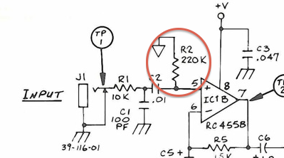

I built the preamplifier based on the Crate design and it seems to be fine. I later noticed that I had left out part of the circuit (red circle in the attached image). It ties the input of the opamp to a 6v reference voltage through a 220K resistor. There is a similar section on the next stage, only this time with a 47K resistor. What is the significance of these? I could not find such connections in the op-amp datasheet examples.
They are the bias resistors for the opamp input stage. If it seems to work without those (and assuming you have C2 in place) then its by pure chance that the opamp input is "floating" in such a way as to acquire some voltage.
They are vital... fit them.

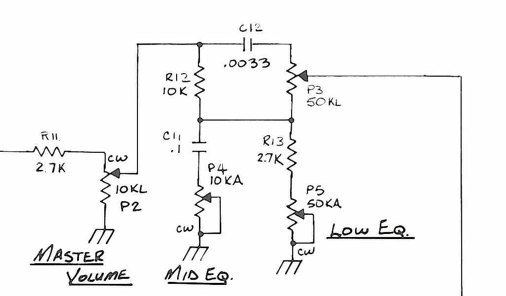

The basic preamp section is working well, connected to a TA-2020-based main amplifier. I tried implementing the tone controls section of the Crate circuit, but this does not work at all. The output drops to a whisper, you can barely hear it if you put your ear right up to the speaker. I've checked and rechecked my circuit and it looks identical to the one in the Crate diagram. I've attached the relevant section, does anything stand out that I should be checking? Also, the pot on the top right is not labelled, is that the high eq?
Thanks for your help!
Its a passive circuit and so does introduce quite a loss depending on pot settings.
With the left hand volume pot on full and the unmarked pot (yes, you could call that Hi Eq) also up full (wiper to C12) you should at least get plenty of hf audio coming through. Does it ?
In your opamp circuit above I just spotted the input coupling cap at 0.01uf. That's very small and means the response falls away below about 100hz.
