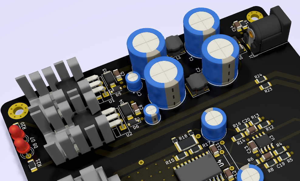

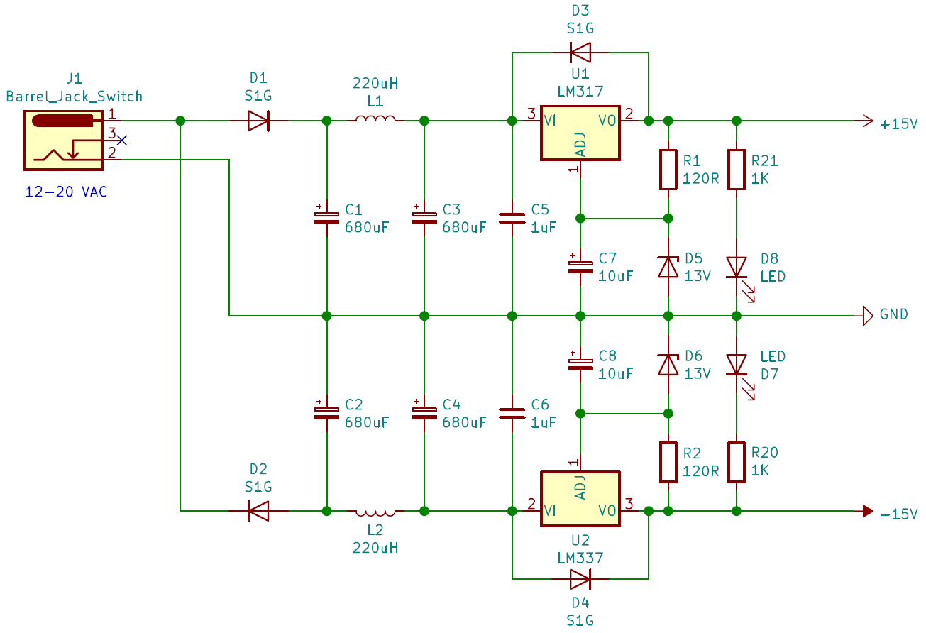

What about good, old LM317 / LM337? With proper implementation IMHO they are still more than enough for most circuits.
Here's power supply part of my headphone amplfier. External 16V 1.1A AC/AC wall wart is used with half wave rectifier. Input is CLC filtered but inductor can be replaced with resistor or even ommited. Zener diodes are used instead of resistors to set reference voltage to push noise even lower. +/- 8V output can be set with simply choosing diffrent zeners. There are two LEDs at both rails. Besides being indicators they run at relatively high current, providing constant load to regulators and keeping low output impedance. If you don't want to make your own layout I can share gerbers. Resistors and diodes are SMD tho, but 1206 is pretty easy to solder by hand.

Wow, this looks literally perfect! If you'd care to share the gerbers that would be very appreciated!
Yea I've looked at the SilentSwitcher and it indeed looks awesome, all though a bit too pricey for what I'm aiming for.
What type of connectors do you prefer? At this time PSU part of my board looks like this but I can change it to your needs. Should I keep barrel 5.5mm connector or do you prefer have terminal blocks at both ends?
5.5 barrel is just fine 🙂 Thank you very much for this!
