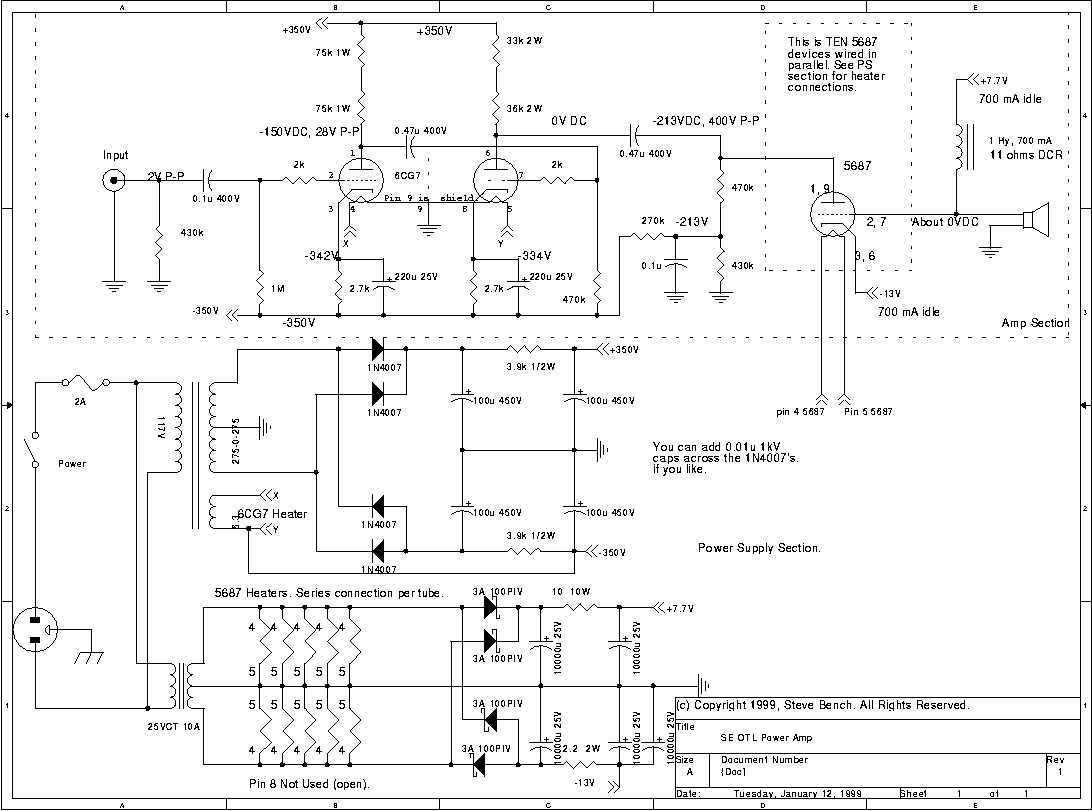

hello,
I was wondering if there are any OTL amplifiers using small tubes. I have found one which I attatch but I wonder if there are any other out there.
thanks
Grid and plate are swapped in the output of that schematic.
You also have a strong possibility of dc bias thorugh the speaker.
The only other OTL i've seen discussed lately was based on 6AS7, which while a dual triode does not qualify as a small tube.
Actually, there are several errors in the schematic. bias reisstors for one tube not ten in the output stage. 700V supply for triodes designed for 250V max, -213 V on the grid (currently shown as plate) of output with -13 on the cathode ....
Hopefully someone else can point you to a schematic of an amp that meets your requirements, and works.
Simple answer: either use a metric sh**load of tubes in parallel, or forget it. OTL is a fundamentally flawed concept around vacuum tubes. The impedances just aren't right.
If you insist, I recall there are some Russian types with very low plate resistance, analogous to 1/2 6AS7 in a 9-pin bottle. I don't remember the number.

6H13C ( with europeen letter is 6N13S ) but this is in 8 pins socket
direct equivalent of 6AS7G
of course , but you need a power plant to lite up 10 pieces of that tube for a decent low output impedance !
