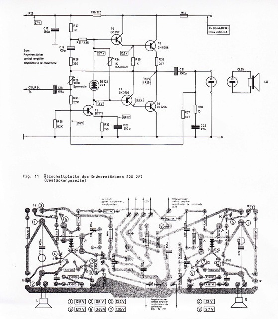

Just a small, low-powered commercial amp, a simple design.
Was wondering if any reasonable improvments could be done to boost it's 10 watt rating a bit to maybe 15 or 25 watts.
OR - improve on the current design for a bit more robustness.
Without going to extremes of course.

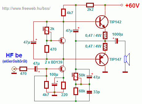

This is Lin's 1956 scheme with minimal differences 🙂. Later, a 1 BJT cascade was added to it to increase the gain. There are many industrial amplifier circuits from the 70s. There are more modern designs. The simplest is to use complementary Darlington transistors.

The amp post 1 has no negative feedback, and obsolete transistors. Sakis made a lot of money repairing amps in Piraus that had darlington output transistors. He said separately heat sinked driver transistor amps survived better in beach bars.
Add one transistor, boost rail voltage to 55-70 you have an Apex AX6. Which both sounds good in my music room, and has DC feedback to reduce the chance of DC assymetry causing clipping on the near side.

@indianajo
So you're saying that the 56K resistor feeding the input of this amp is not providing feedback?
missed that one.
somebody collected 100 of these old single supply amp schematics for somebody named Daniel, and I don't recall see any doing feedback that way. Must be a reason. Most fed back to the input transistor emitter resistor, if they didn't have a long tailed pair. When transistors were $1 for tiny and $11 for power, and minimum wage was $1.25, leaving one transistor out was a good practice.
I like having fewer wires to build point to point, plus the speaker cap prevents speaker damage if a wire pops loose. Surplus US power transformers are also a lot cheaper without a center tap.
The two 56K (56k/2=28K) and the 3k3 input resistor are an inverting input feedback network setting the gain to ~ 28/3.3 = about 10 (20dB) because some will be lost due to lack of open loop gain and the 220 Re.
1. The 220 resistor may improve DC stability but it's not needed for AC stability and compromises the zero-point input. The 220 also reduces the clipping amplitude.
2. The two 330 base resistors would be better as a single resistor to cross couple the drivers, and a smaller value is better for speed and shoot-through current.
3. Similar circuits were common when transistors were expensive, but today it makes no sense to skip a LTP in front of such amps for the pennies they cost.
4. A current limit would make the amp a great deal more robust. The standard circuit is two transistors, 2 or 4 resistors and two diodes, but a simple current limit is to just clamp the VAS to the output with a couple diodes, provided the output Re are appropriate. Sorry, I'm too lazy to look up the transistor specs and do the math for you. But then you have to protect the VAS transistor.
5. The VAS current is only about 37/4k7/2~=3.9mA. This may be a bit low depending on the speaker impedance and the EF transistor gains.
6. Cheap little amps usually run about 40V rail-rail because cheap transistors are typically Vceo~40V, and that is also about the power handling limit of TO220 output transistors. At 40V, loosing 4V to output saturation is an issue since 10% voltage is 20% power. A CPF (quasi) gives you half of that back on the lower side, but the bootstrap means a 2EF on the top is just as good and better for stability. Rather than calculating an RMS voltage, it's easier to use the fact that the peak voltage is twice the RMS power, so 18*18/8/2=20.25 Watts. 10 Watts is only 12.6V peak ie loosing 6V output swing on both sides. Some of that may be the 0.47 Re's but reducing them is a thermal stability issue.
