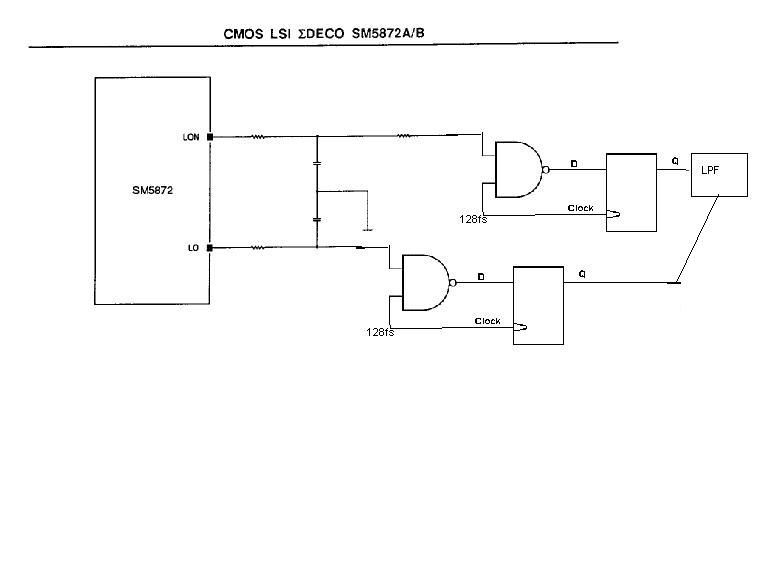

The sm5872 chip in Marantz cd63.
I was planning to convert PWM to PDM but i'm not sure it will work! (info' on the net is often conflicting)
I believe the PWM output from the SM5872 is 32fs (a forum member has scoped the outputs)
I do think the clocking frequency may be a bit on the high side (maybe 32fs?).
Any thoughts?
