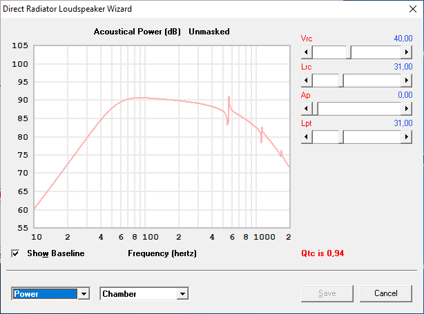

Unfortunately my pc, soundcard and measuring mic has been stolen, so i am not able to simulate any boxes at thia moment.. anybody interested in that? 🙂 Would like to see what kind och curve a box around 40-50L would provide.
interesting driver, however slightly high Qts.
here is the 830668 in 40 L closed box, for 2Pi (floorstanding), Qtc is 0,94.
you would need 126 L for Qtc 0,71 ("max flat butterworth")

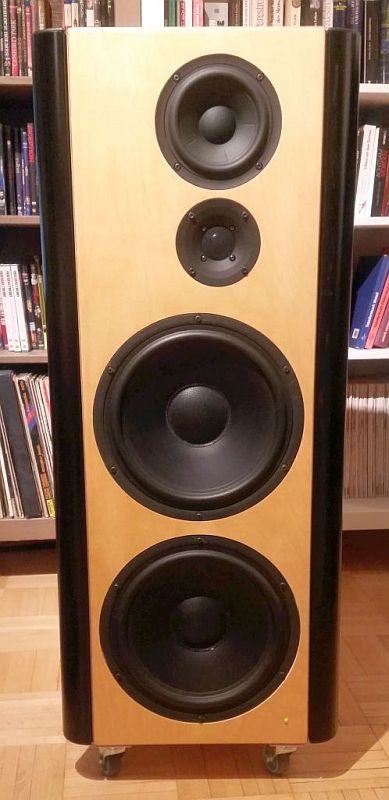

I use two of the 8 Ohm type per side in parallel, driven by one channel of a Hypex FA123 (125W), which is by calculation excacly enough to drive them to datasheet mechanical Xlim by low-bass frequencies. I put them in ~65l CB with resulting Qtc = 0,85, applied linkwitz equalization to 30Hz / Q=0,71 and use them up to 300Hz LR4.
Bass and low-mids perform outstanding crystal clear up to Pmax, you can see that the woofers deflect to Xlim, but without the funny bouncing you observe from cheap car hifi soup bowls; they are just "visually blurring", with very, very few DC offset. A guy in a german forum, who developed the current speaker line for T+A mentioned a few times that he tested and very likes this driver too. Performance at very low levels is also excellent thanks to the very few mechanical losses.
In my opinion you can't get better with a 10" if you want undistorted sound and clarity, only a few dB louder when you spend multiple the money e.g. for a Scan Speak Revelator 28Wxxx which has relevant higher linear excursion/power capabilities with also very low distortion.
Sensitivity is above average, especially for the 4 Ohm type (much higher than typically subwoofer / long-stroke drivers).
This is my beloved system (which I decided will keep as reference forever because it sound so neutral and clean - no, no, this means not that I will not build more speakers, LOL) where I use them:
