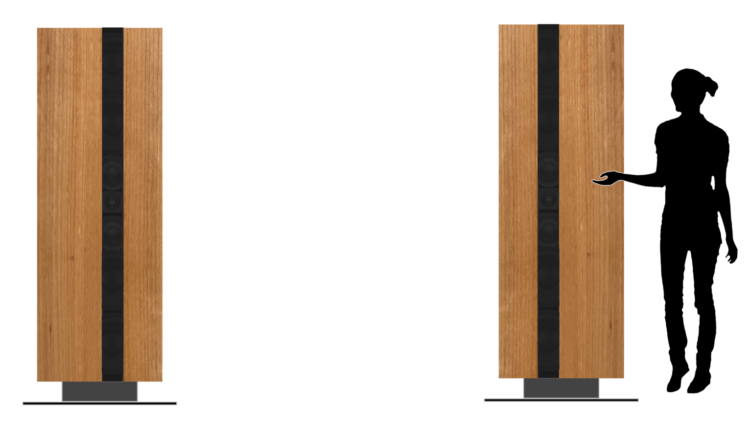

The concept I'm exploring is a SLOB (slot-loaded open baffle) with the catch that ALL drivers will fire through the same slot. The slot width will be around the size of the smallest driver, so its impact will be greatest at low frequencies. It is not a MEH (multi-entry horn) but a MES (multi-entry slot) (pronounced "mess" 😛).

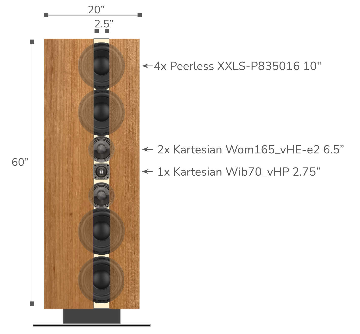

I am considering a WWMTMWW arrangement because I really like that in my Aura speakers. Using a wideband driver for the "T" makes it dipole across the whole frequency spectrum. I'm hoping for more bass, higher sensitivity and higher max SPL than the Aura speakers, and considering these drivers:
  • Tweeter: Kartesian Wib70_vHP
  • Mids: 2 x Kartesian Wom165_vHE-e2
  • Bass: 4 x Peerless XXLS-P835016 10"

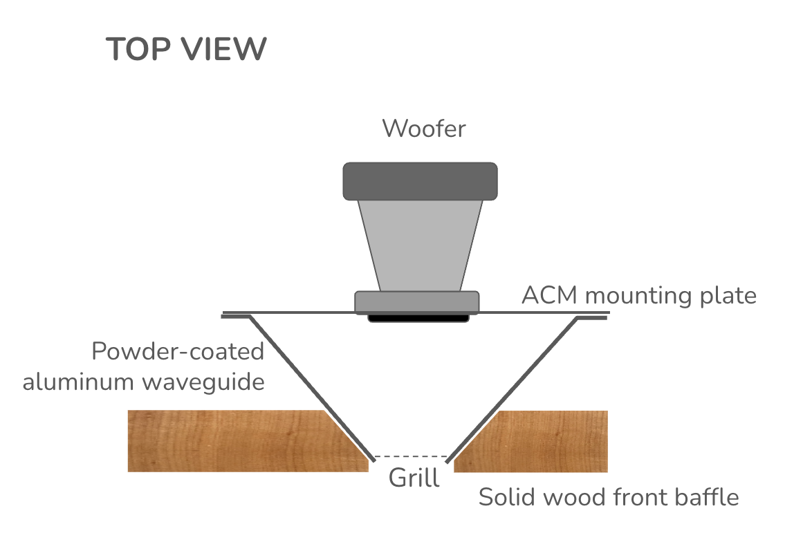

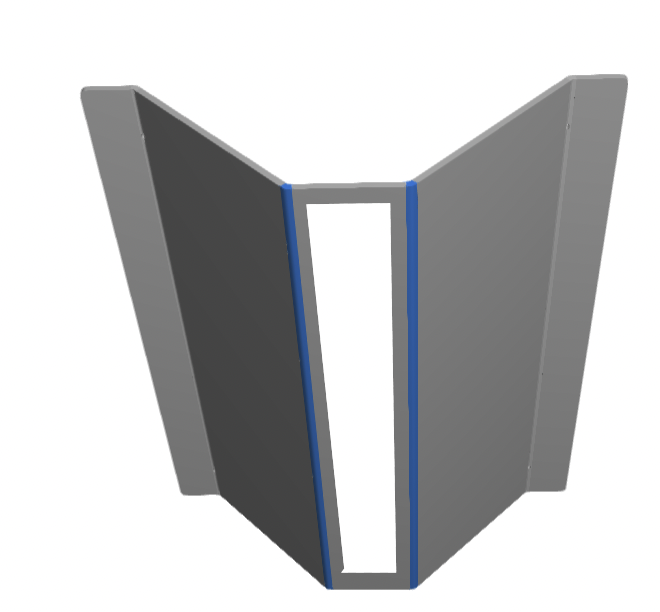

For the waveguide and the mounting plate, I will use SendCutSend, with the waveguide looking something like this:

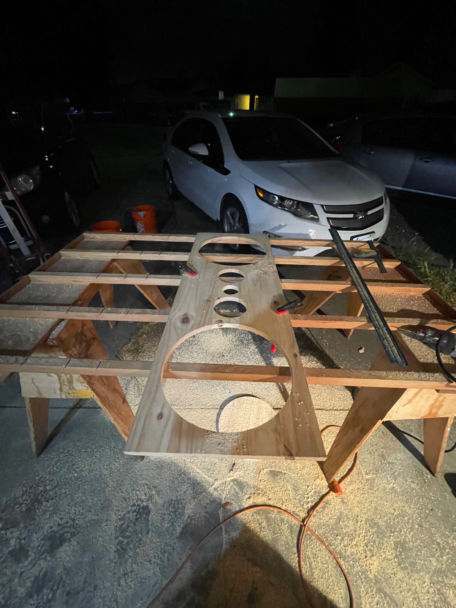

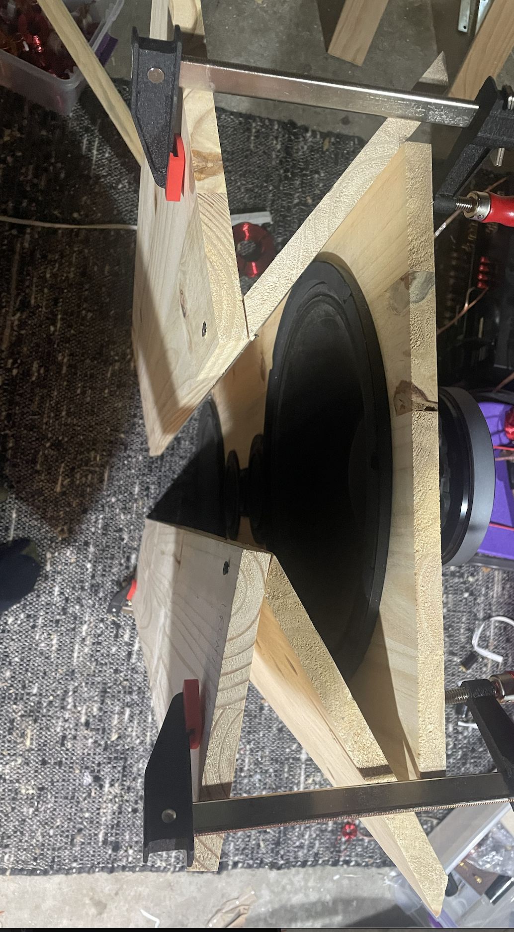

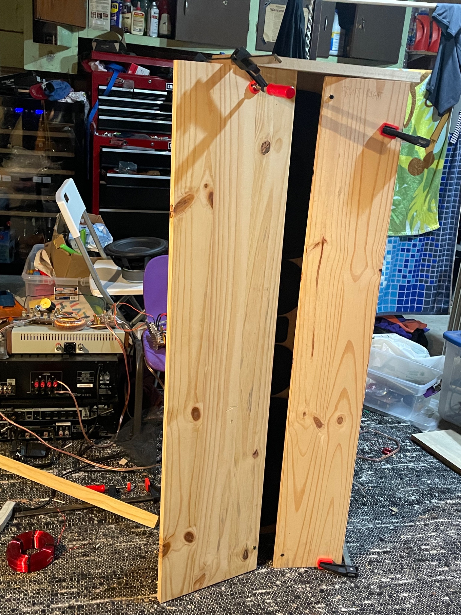

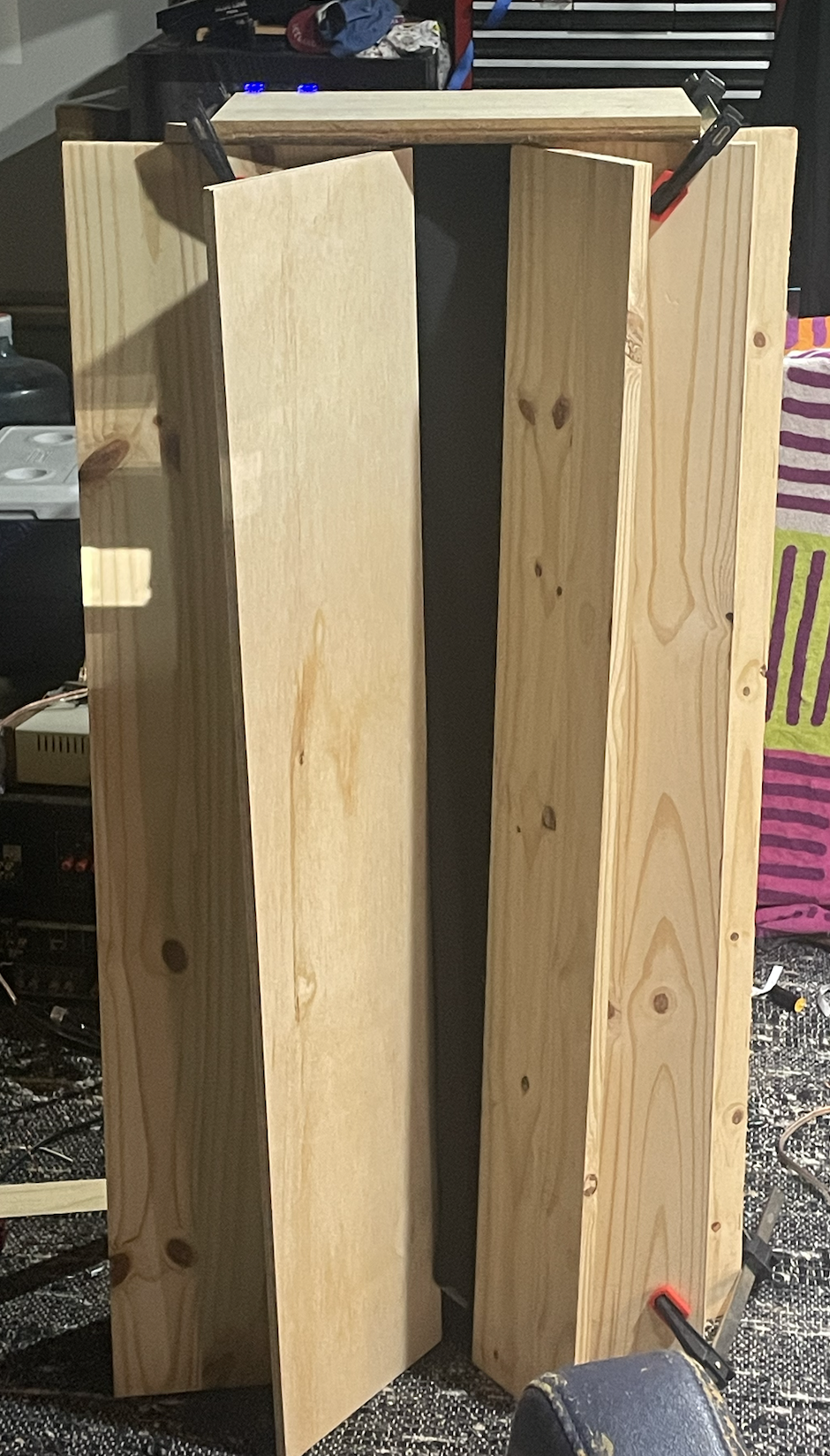

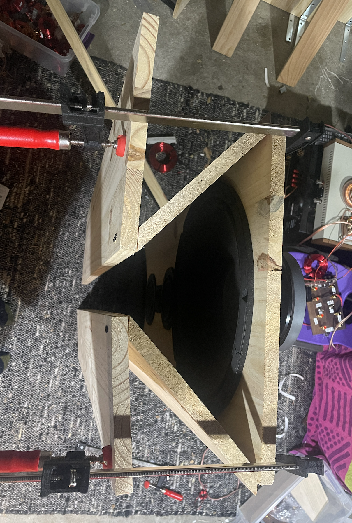

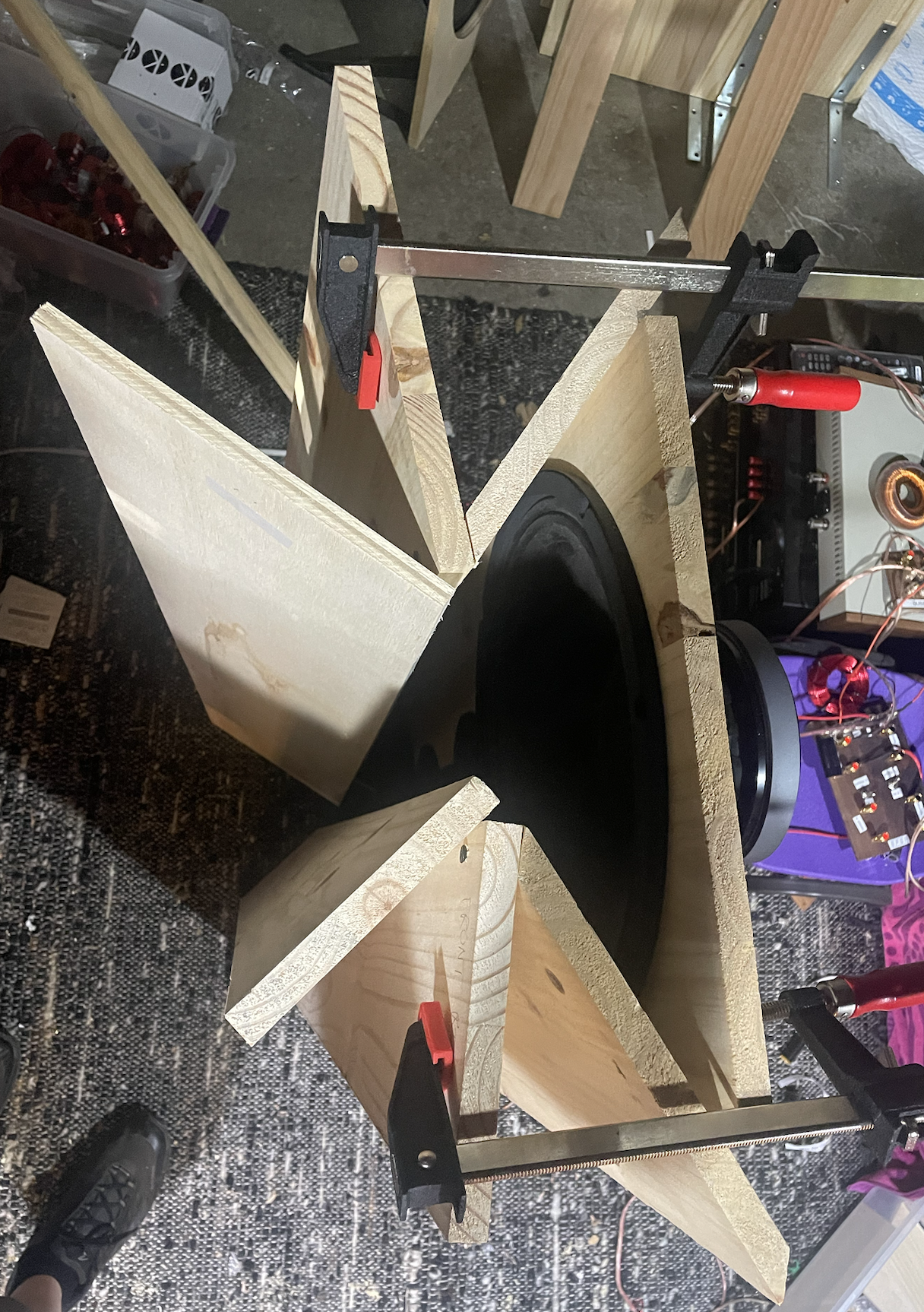

I was up late prototyping in my garage with some pine boards I got from Lowe’s. I don’t have the Peerless drivers yet so I used a pair of 15” SB 15OB350 I had lying around.
Keeping in mind this is a first, unoptimized pass, the initial impressions are encouraging. The Wib70_vHP is a killer little driver that sounds great in the “midtweet + some bass” role. Highs are tweeter-like, and it can handle an impressive amount of power while still sounding smooth/effortless for such a little driver. For the mids I went with the Wib145_vHE to keep c-to-c smaller. They are very nice drivers that stay clean as I push the volume (I maxed the volume on my stereo receiver, wore ear protection, and it still sounded good). The SB 15OB350 is great for the price and works well here, but I want to keep exploring other options for the bass. I may stick with 2x15” for bass instead of 4x10” because it is a bit more compact.
The slot definitely boosts the bass, and the slot-loaded OB concept works really well here. I don’t need any attenuation of the mid or treble for bass to sound balanced, which is impressive for an OB speaker. I’m used to applying a TON of attenuation with dipole speakers, so this is a pleasant surprise.
The biggest downside to this initial design I’ve noticed is that the sweetspot is very narrow horizontally. The treble falls off quickly as I move left or right away from the slot. Listening on-axis is glorious though. I’m curious how a stereo pair would image but that would require building a second prototype (with kids and a full time job progress is slow). I think reducing the chamber depth may help with the horizontal dispersion.

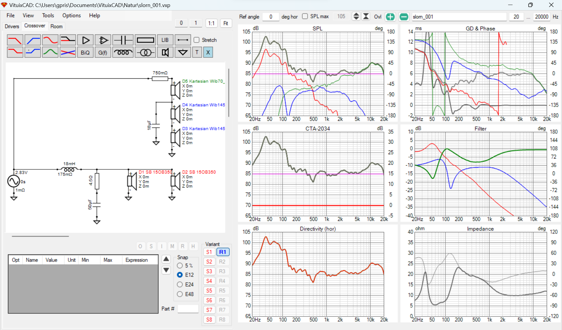

The crossover right now is just a Zobel on the 15” drivers with a big series inductor (the label fell off so I’m not sure how big, but >=12mH). Plus a single cap in parallel with the mids, with a .75ohm resistor in series with the T-M-M chain. The resistor helps tame the high frequencies a little bit. The zobel helps a lot with the 15” drivers to reduce their mids.

I modeled the current setup's crossover in VituixCAD. This doesn't take into account the baffle or slot, so the frequency response (particular below 100hz) is much flatter than this makes it seem. Also the peak in the high frequencies isn't as bad as it seems because it is very directional and the slot seems to absorb some of the high frequency energy. Still I might try an LPAD or shelf on the midtweet to see if I like it more than the .75mohm resistor.
I'm gonna need to read that other thread to see if I can model the baffle & slot.

What are the dimensions of the baffle and slot?
Have you seen other speakers that fire mid and treble through a slot, like this? I'm not sure I have. Isn't the slot going to do strange things to the mid and treble?
This could be because the slot mouth is effectively the radiating surface - it's like have a three-inch wide tweeter (or however wide your slot is).
OK, I noticed the dimensions above - 2.5 inches slot width. I don't see the slot depth though - maybe 8 inches? I ran a quick sim in Basta, but I'm not going to post it - it's not pretty. 😆
The sim assumes that the slot acts like a vent, basically. For the dimensions I entered, there's quite a strong resonance just above 100 Hz, and then the slot tends to suppress the mid and treble output a bit. Is that really what happens? I have no idea. Maybe it's more like a huge compression driver? (I wouldn't have thought so, to be honest, as the slot mouth has a much larger area than the mid and treble radiating surfaces.)
I'm playing around with those by moving where I clamp the front baffle/waveguides to the backplane. For example:
First photo:
  • Chamber Depth: 7”
  • Slot width 2.5”
  • Total front width: 20.5”
Second photo:
  • 4.5” chamber depth
  • 5” slot width
  • 22.5 total baffle
I have not seen other speakers like this, which is why I'm excited to try it and share my findings.
Depends on what you mean by "strange things". With the deeper chamber I found it sounds pretty good directly on-axis, but off-axis the treble falls off very quickly and it sounds a little bit muffled (as if behind a closed door). With the more shallow chamber and wider slot mouth, these effects are mitigated substantially and it starts sounding really good. The sound is definitely not as open and airy as a simple flat-baffle dipole, but it is not overly "boxy" either. The bass is noticeable deeper and more impactful than a similar-sensitivity flat-baffle , which is a big benefit.
I've also been playing with a more "1-D horn-like" front and from initial listening impressions it seems to improve the sound and directivity (I don't like the look as much though).
