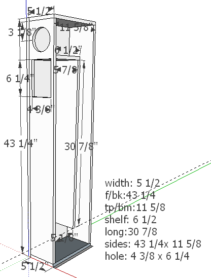

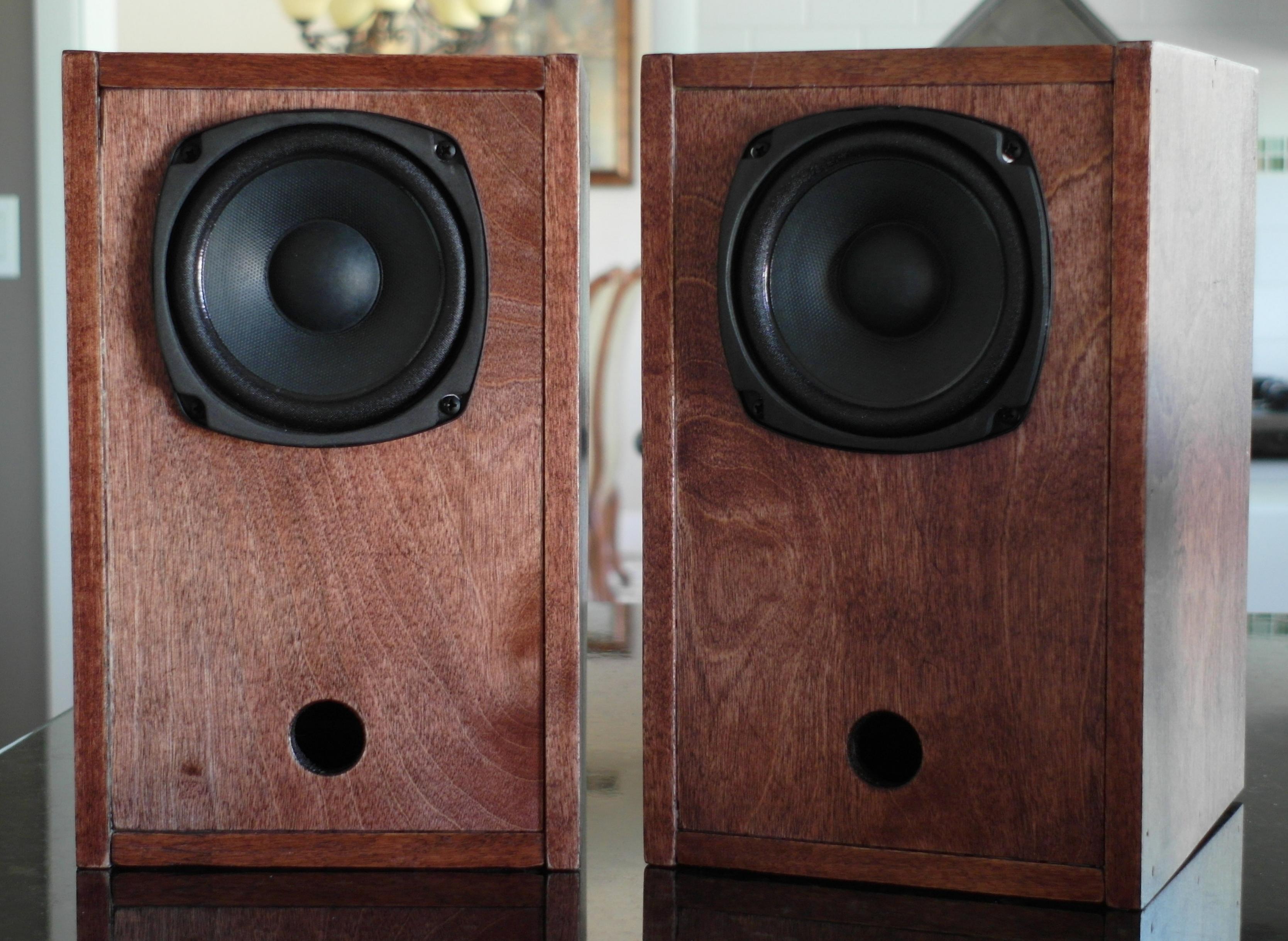

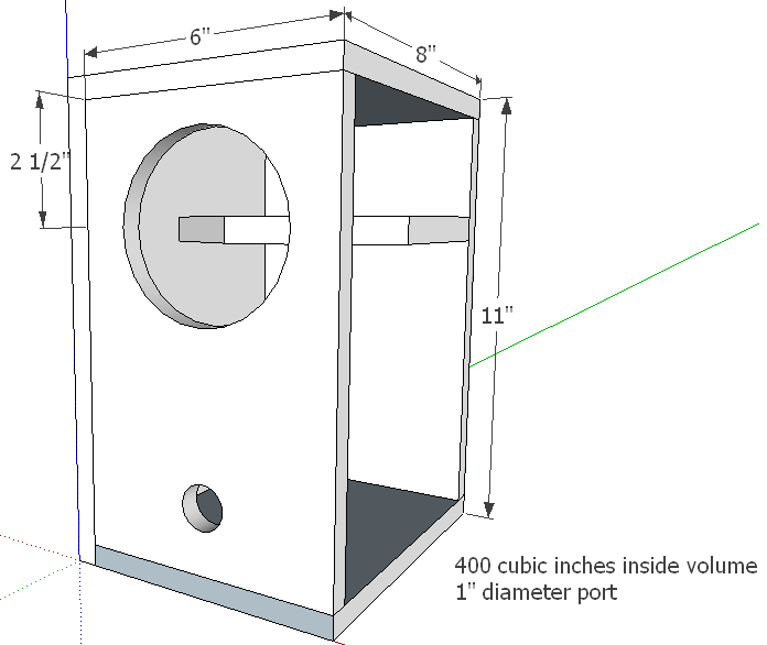

I have fond memories of Pioneer A11 (el cheapo) fullrange 4.5". For me, it was excellent for my needs mainly jazz, vocals, etc. Since the original is not being produced, I ordered these "replacement" GRS 4FR-8 Full-Range 4-1/2" Speaker Pioneer Type A11EC80-02F 8 Ohm
I used the recommended vented bookshelf below. I am very surprised at the quality of the sound for $8. Bass is extended and extension to high frequency is more than adequate. For my use with low power D-amps, 91dB sensitivity is definitely a plus. In my opinion these are better than the original Pioneer A11...

Greg, I listened to your video with the drivers in the taller cabinets, and I think the sound was fantastic! Who would have thought that a driver in a lower price range would sound so good? I may do a build with them for my garage workshop, as I currently have no music out there. Thanks for sharing your findings and the demo video.

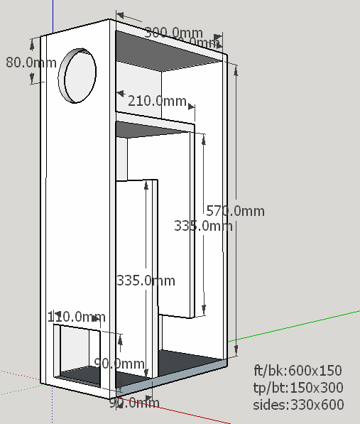

Likely u listened to the cabinet with the rectangular vent on the bottom, I plan to build the one with vent near the driver on the top, soon. Will share my thoughts after finishing the taller cabinet with the same driver.
I think that new box will definitely bring out every possible attribute of the driver, and I look forward to your findings!
