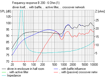

It is not about listening off axis, but precisely on axis. Driver height of the B200 above floor is 80 cm. Younger people in Germany (or Western Europa) tend to have their ears at about 1 m height when seated. So Visaton had to tilt the driver to make people listen on-axis.
If you look at these measurements of the B200, you find the 15° curve not worse than 0°. But 30° has really lost many high frequencies above 5 kHz:
http://hifi-selbstbau.de/images/stories/chassis/visaton_b200/B200_1A_SPL.png
If you keep in mind, that many people in this country have their ears at 1,6 - 1,7 m when standing, you need to slant the baffle to allow for good listening in that position too.

Hi Oon,There seems to be a baffle compensation filter built into the crossover, hence no real need to listen to the speaker off axis to get a flat freq response.
that's not a baffle compensation, but compensating the step in the driver response. You can see the different influences of baffle and crossover in a Boxsim simulation:
If you look at the NoBox' on-axis response on the Visaton website, it is gently rising from 300 Hz up. But the NoBox must be toed-in to give a (somewhat) linear response at the listening position in a standard stereo triangle.On a more generic note if one were to listen to the speakers off axis, for example the speakers facing directly forward would it be necessary to incorporate a baffle step filter at all since the center position is actually off axis.

With both drivers you can't achieve a good balance between on-axis response and power response IMHO. If you EQ the B200 for 30°, you will have a nice power response, but far to much at 0-15°. If you EQ for 0-15°, the off-axis response will be dull.
The AN doesn't even give you the chance to EQ for a defined axis because everything off-axis is a lobing chaos.
The sharp step from 600-2 kHz can't be EQed fully with a passive crossover. There will always be a certain "presence" with those drivers, which makes them attractive at first listening, but can lead to listening fatigue when recordings are already "present" by themselves.
I would try to get the best balance at the listening position by toe-in of the baffles, not by EQ. Slanting the baffles will help too.
