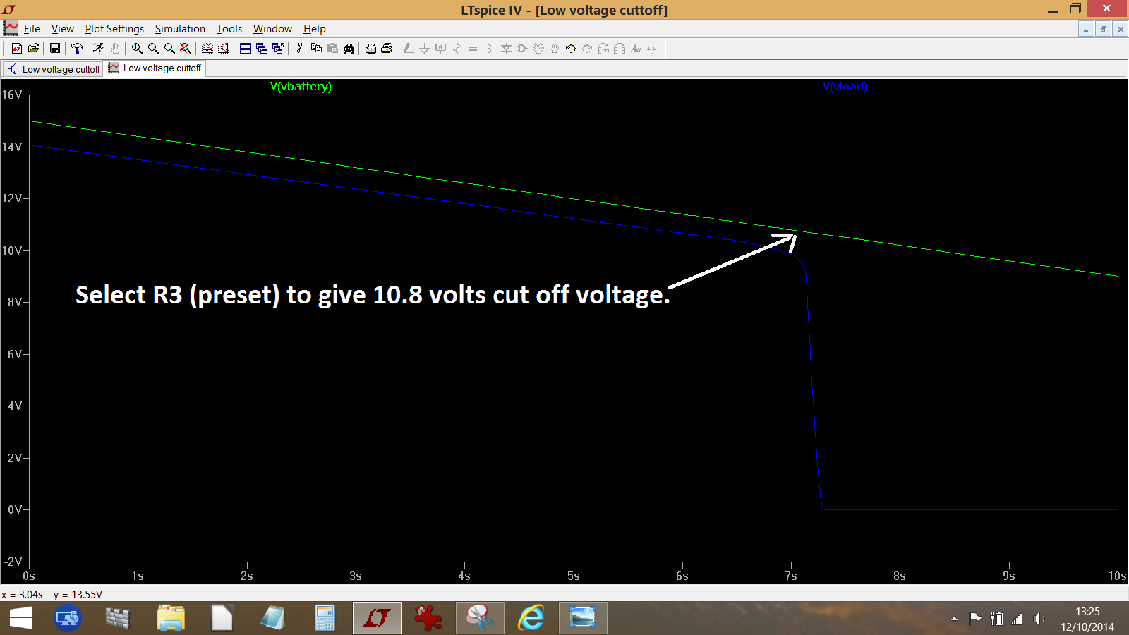

You need a simple low voltage cut off circuit such as this that will trip at 10.8 volts and prevent the battery discharging further.
Over discharge of SLA's will kill them as will charging with an inappropriate charger.
