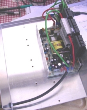

Well, it hasn’t caught fire yet!! 😉 I've mounted one of my two SMPS in an alu enclosure. It's a modular layout and is predrilled to fit 1-4 smoothing caps. The 50W 10R load resistor barely gets warm, and the Intel PII heatsink is pretty much at room temp. I guess I over-specced the heatsinking!! 😀 I'll be comparing this with my SLA battery with a float charger.
I’ve been thinking that with up to 4 x 68 000uF smoothing caps, the bleeder resistor(s) on the skynet will be vastly underrated. I assume that when I switch off the main switch with the smoothing caps fitted, then all that juice is going to be dissipated through the SMPS bleeder? If I could identify the bleeder, then it would be possible to desolder it and attach flyleads directly from the PCB to the 2K2 50W bleeder I preinstalled. I would rather have a longer time constant for discharging the caps than the heat I had last time I was messing about with a 10w 10R across the battery!!
When I first powered the Trends TA-10 from it, I listened to M2 by Marcus Miller and it was sounding very good indeed with a decent soundstage. Might just be that it’s a good recording, though and after a few days, I’ll dump the battery back on there just to see what’s missing / different.
Jobs to do over the next few days include making up the leads for the smoothing caps, fitting the caps to a DC supply to give them a headstart on running in, and just keeping the discs spinning. I’m also wanting to fit an LED powerindicator onto the spare +12V supply pin. I also intend to get the SMPS and battery supplies onto the scope to see what the supply quality is like.
