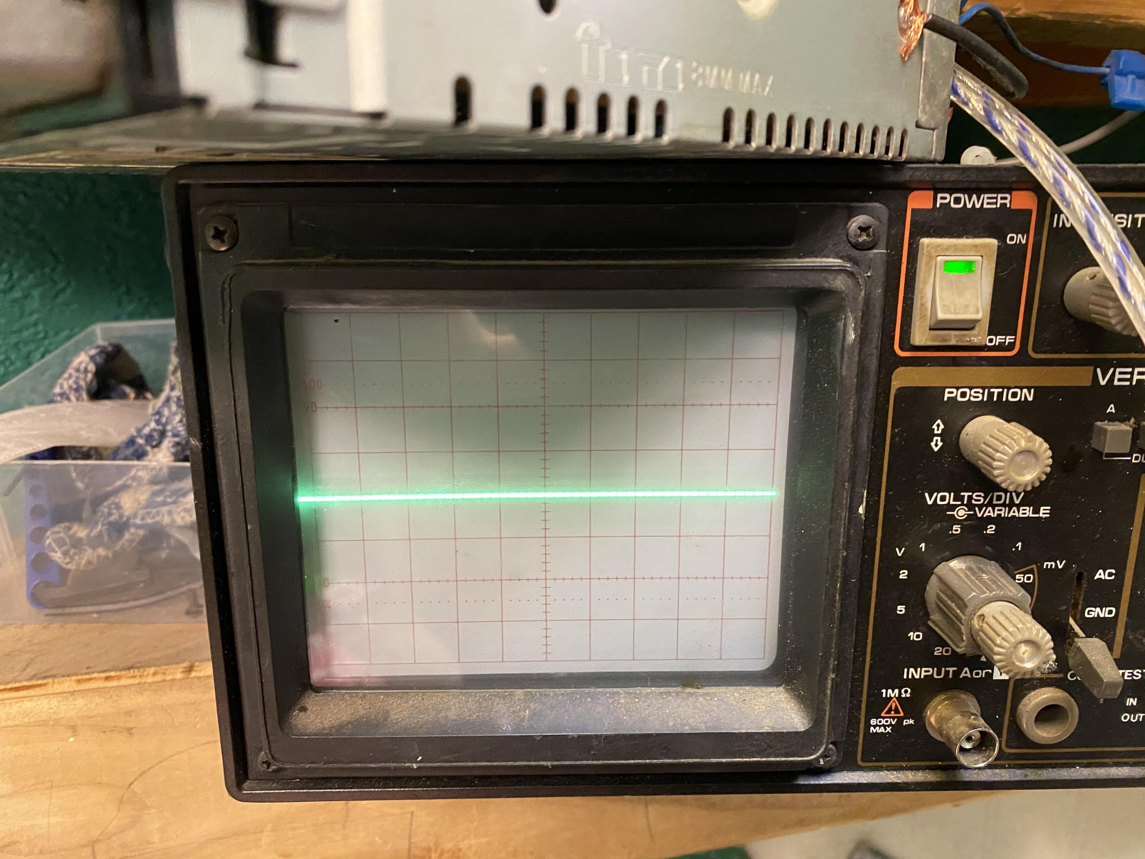

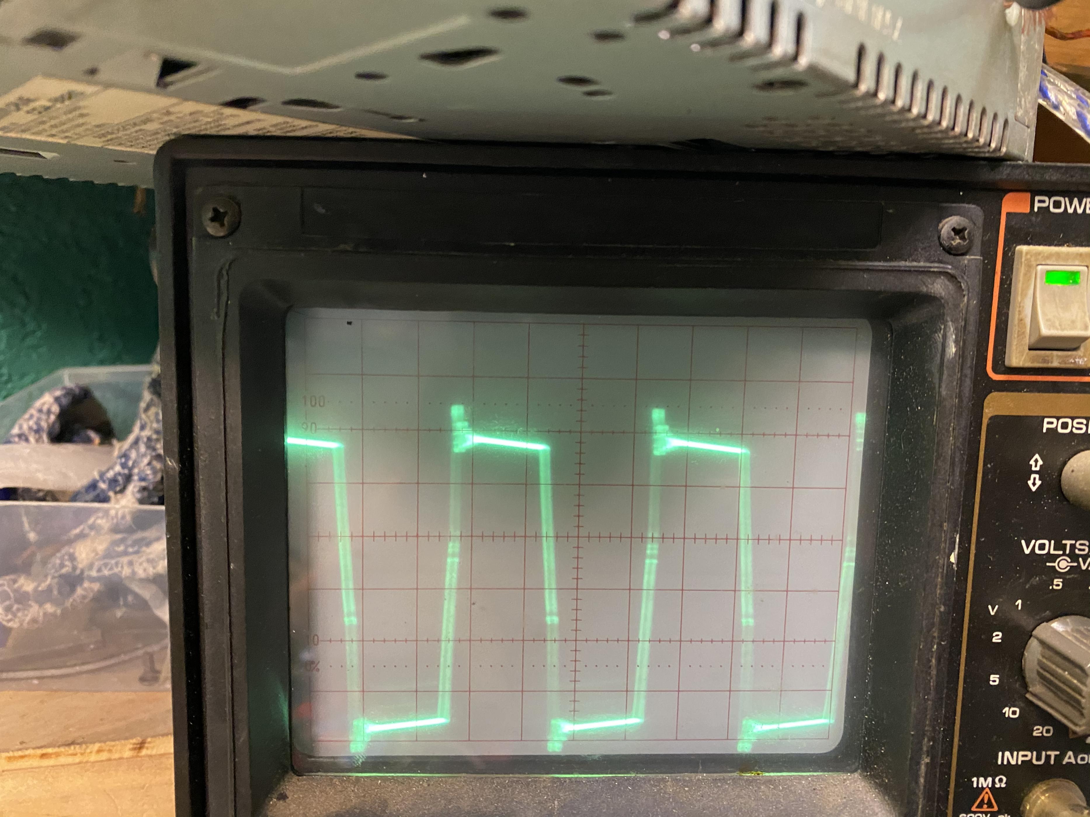

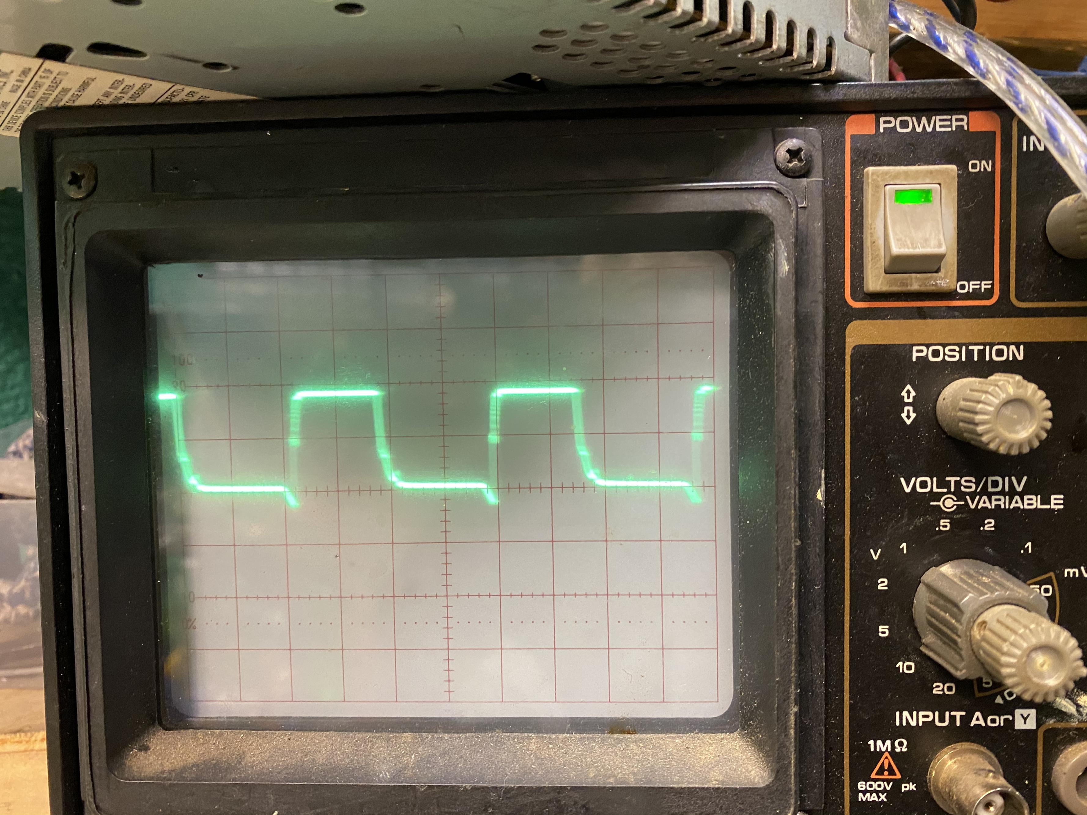

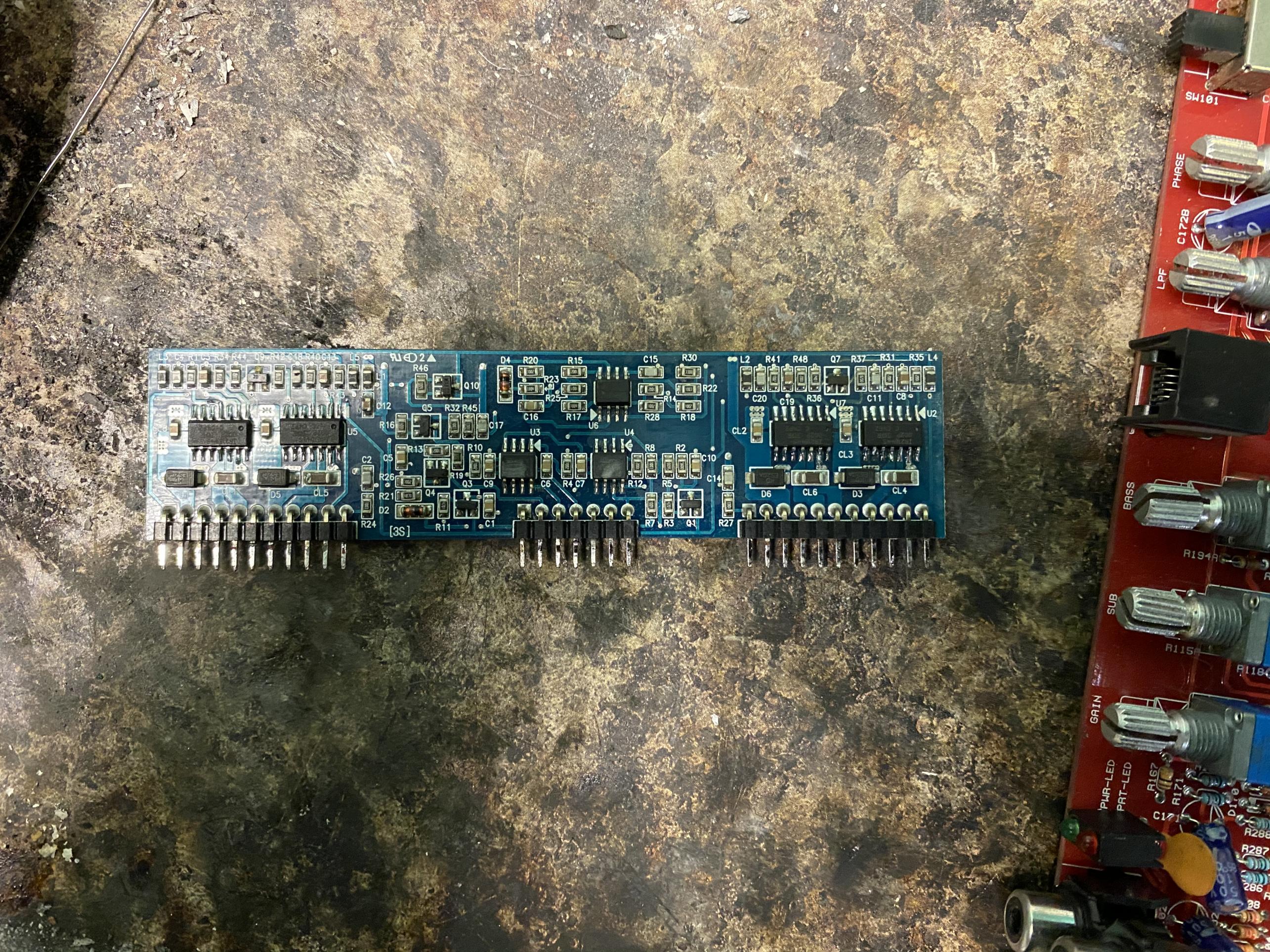

Wondering what is wrong with the drive circuit for 1 set of fets .
Here’s what I get on that bank .
Scope set to 10us 5volts/div

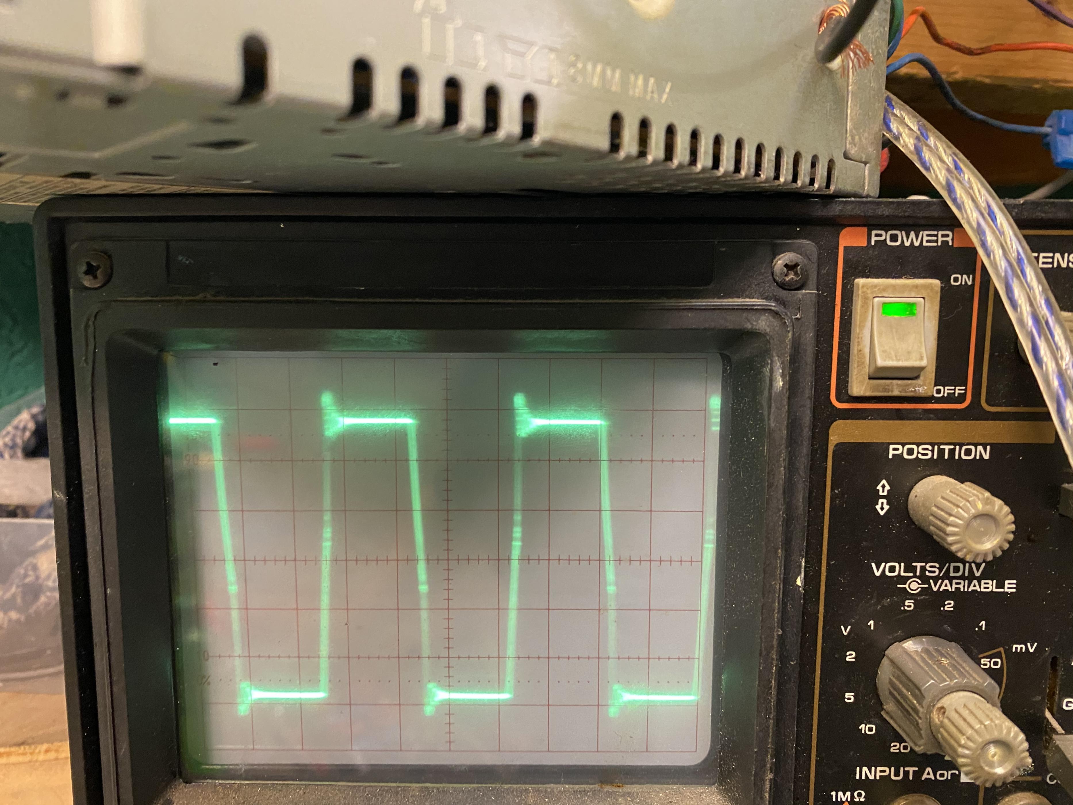

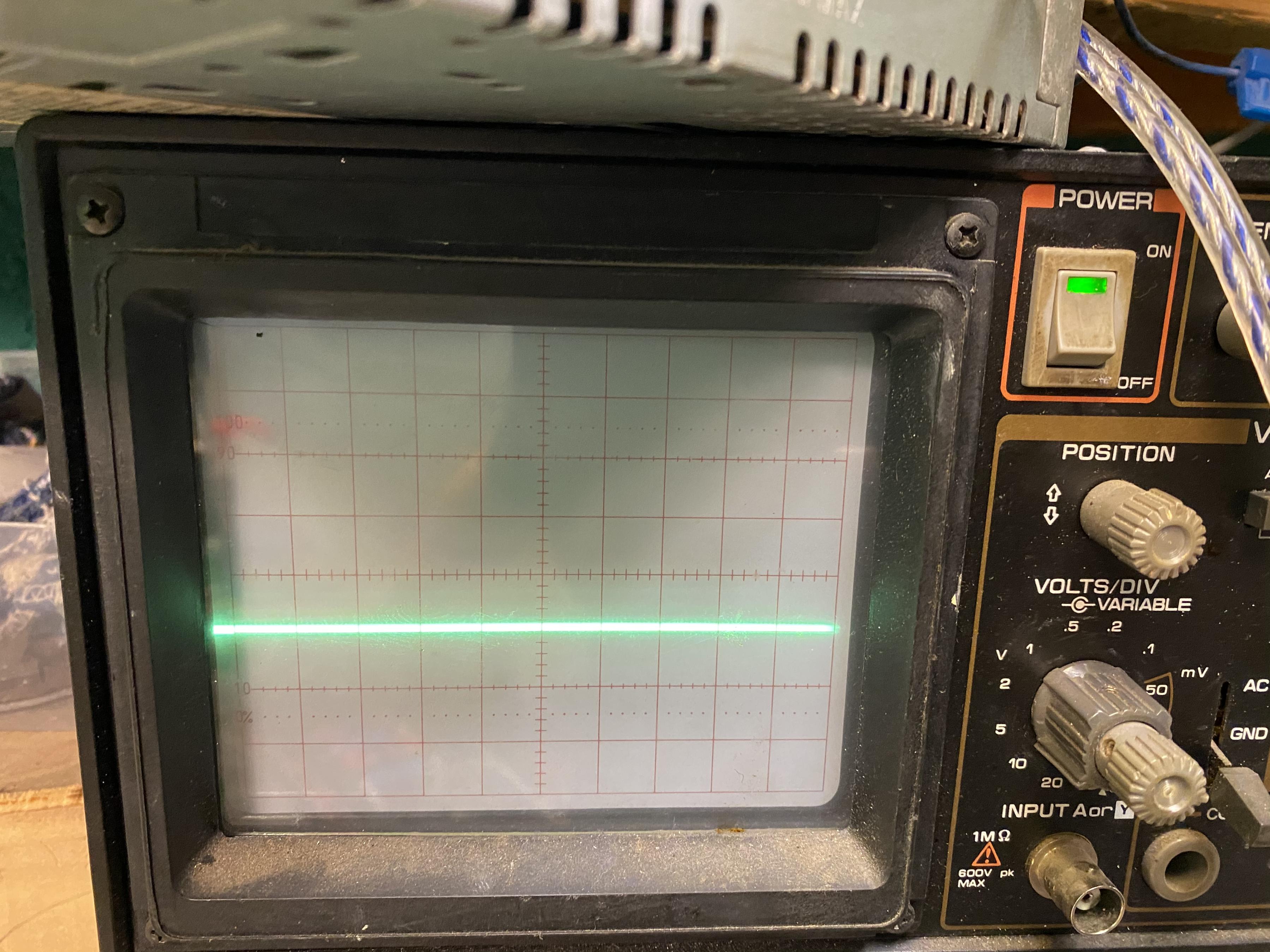

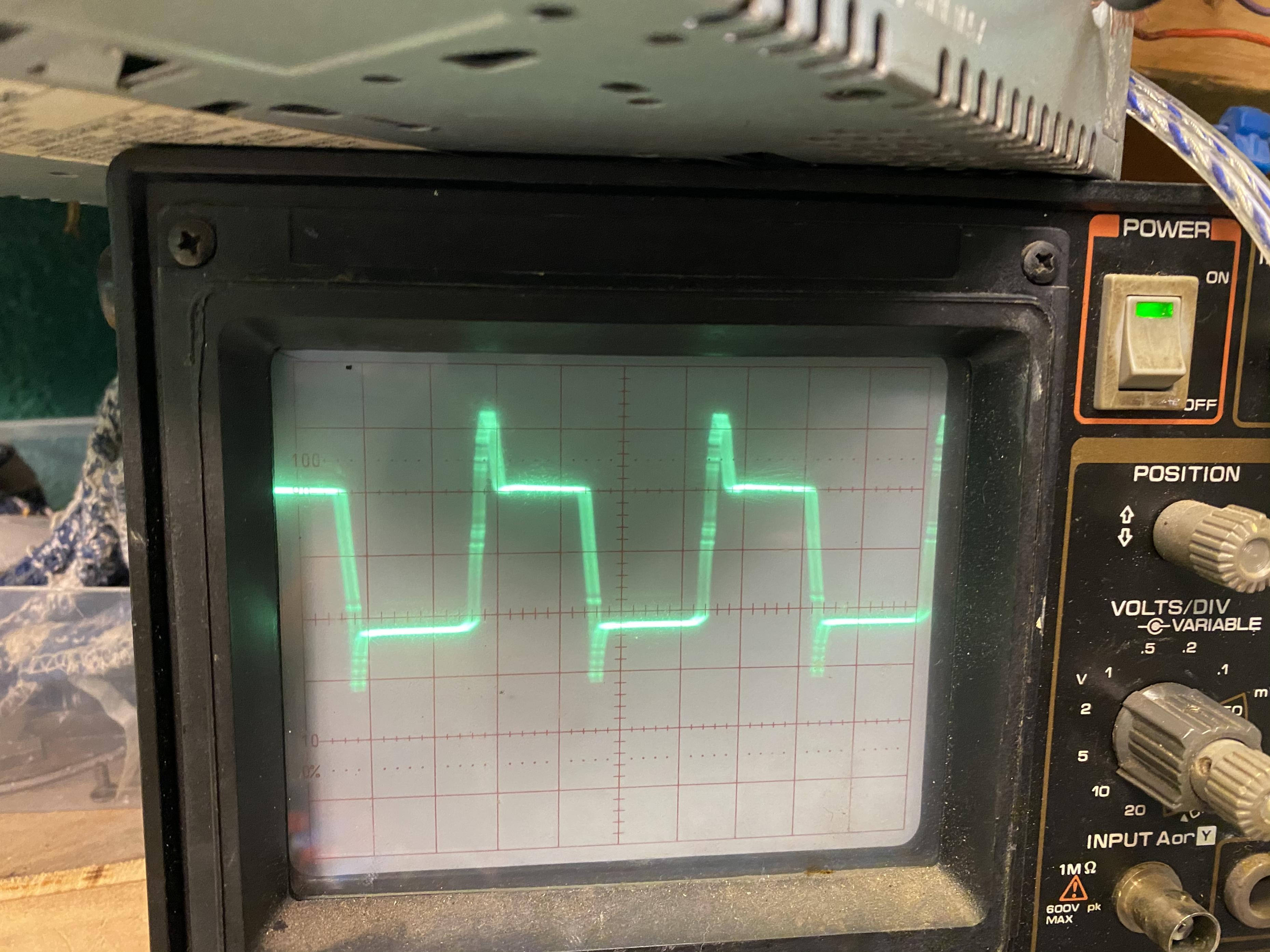

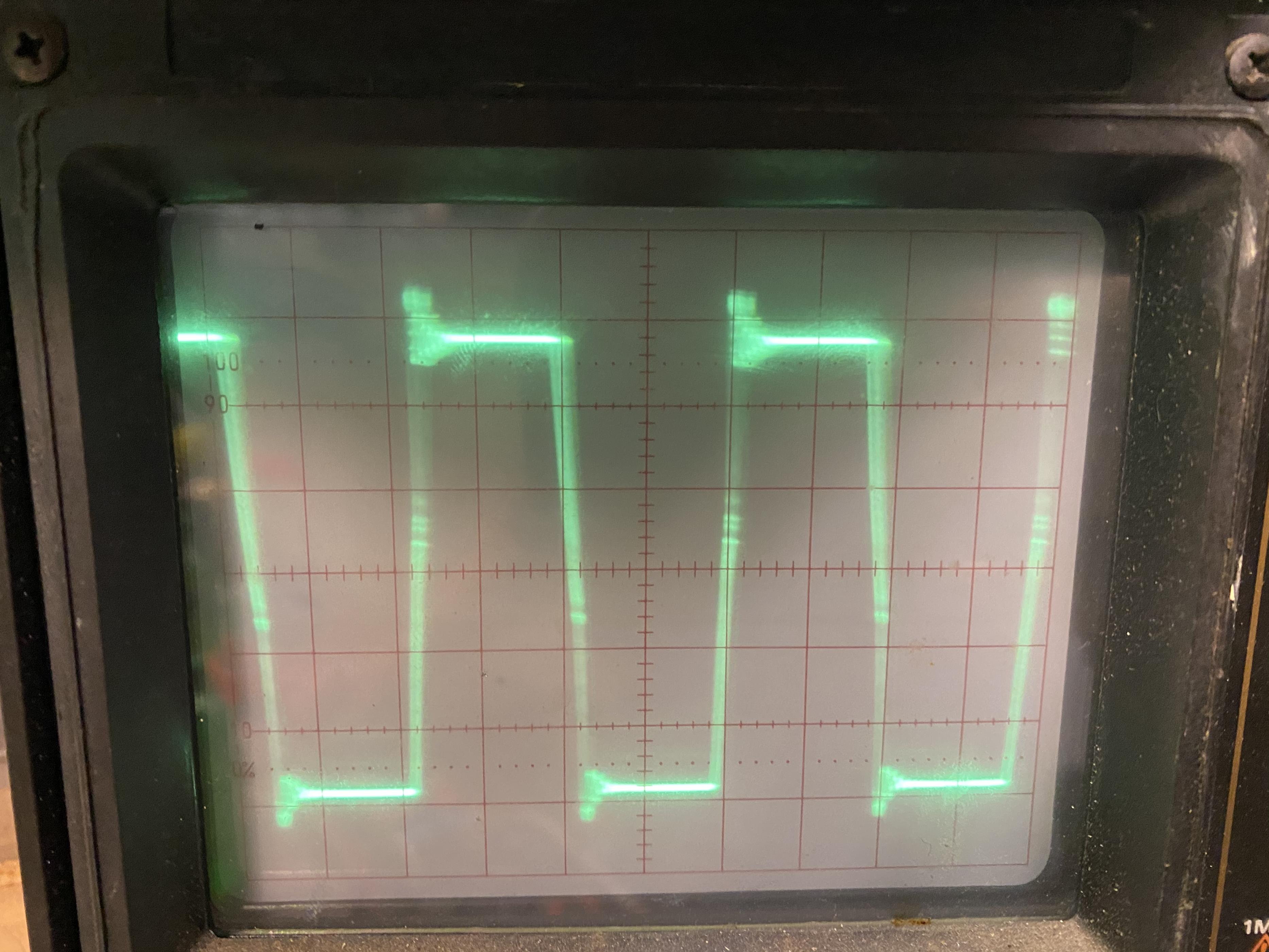

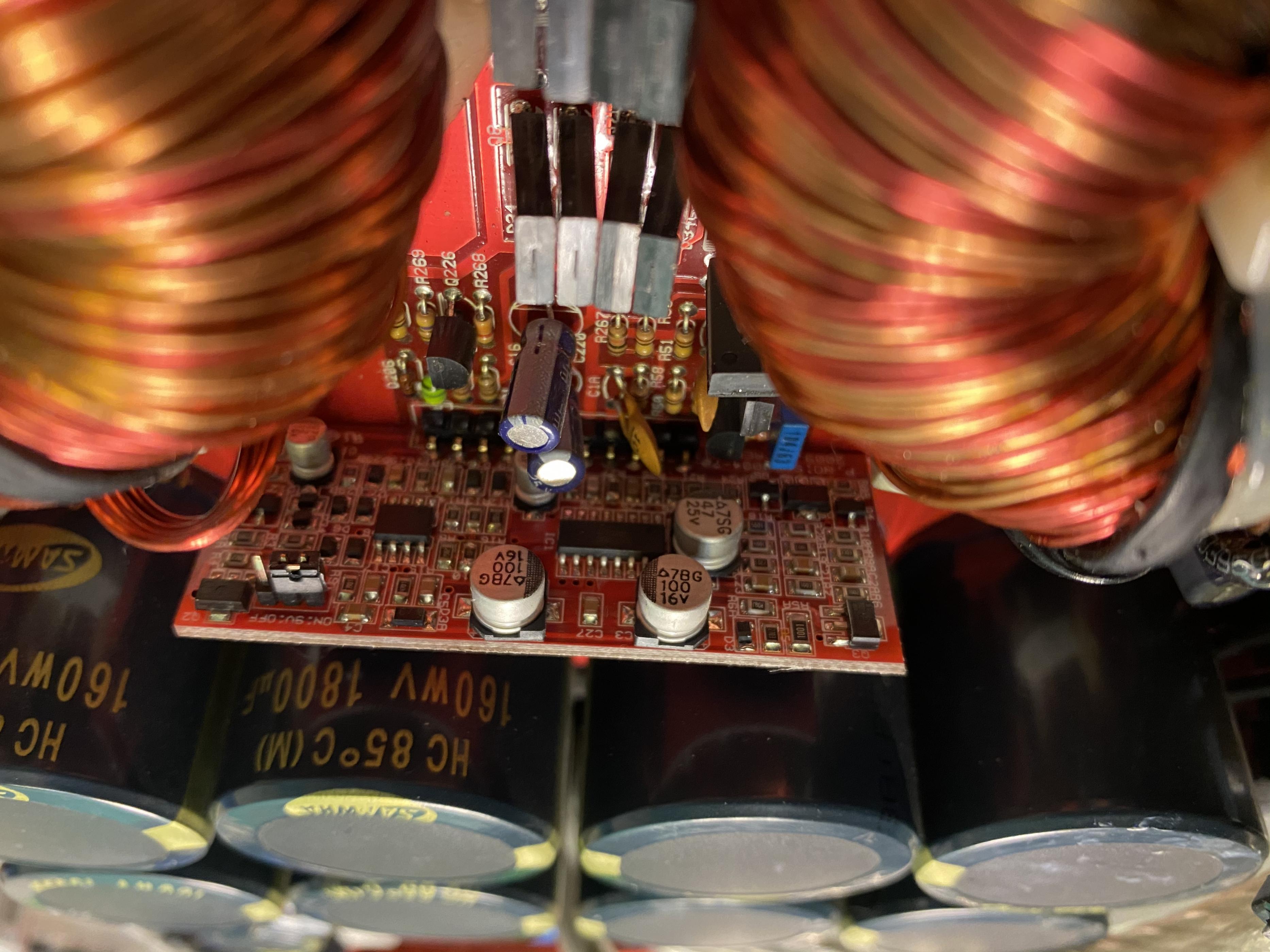

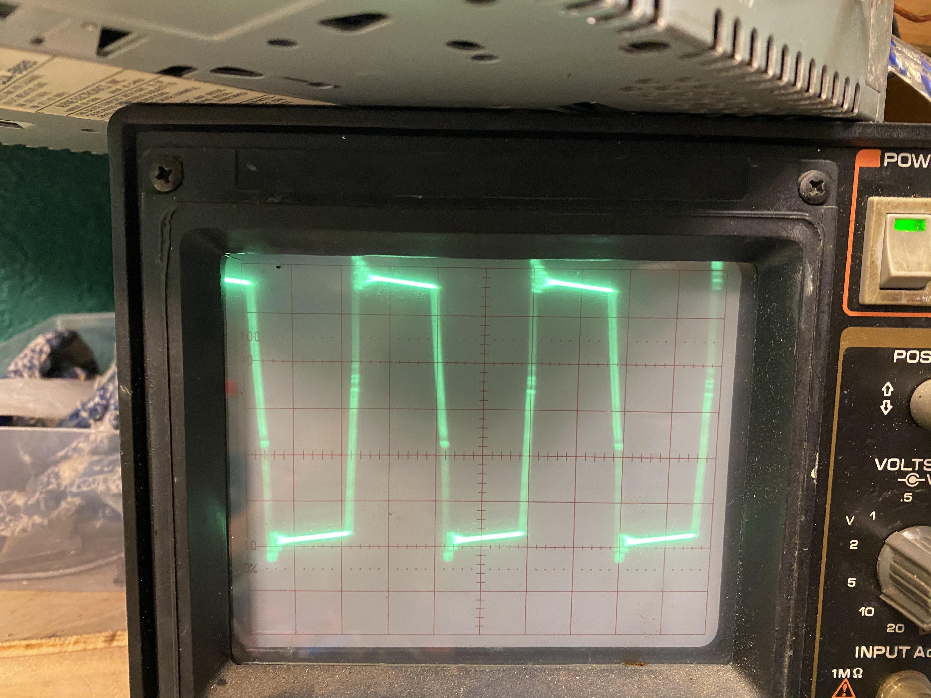

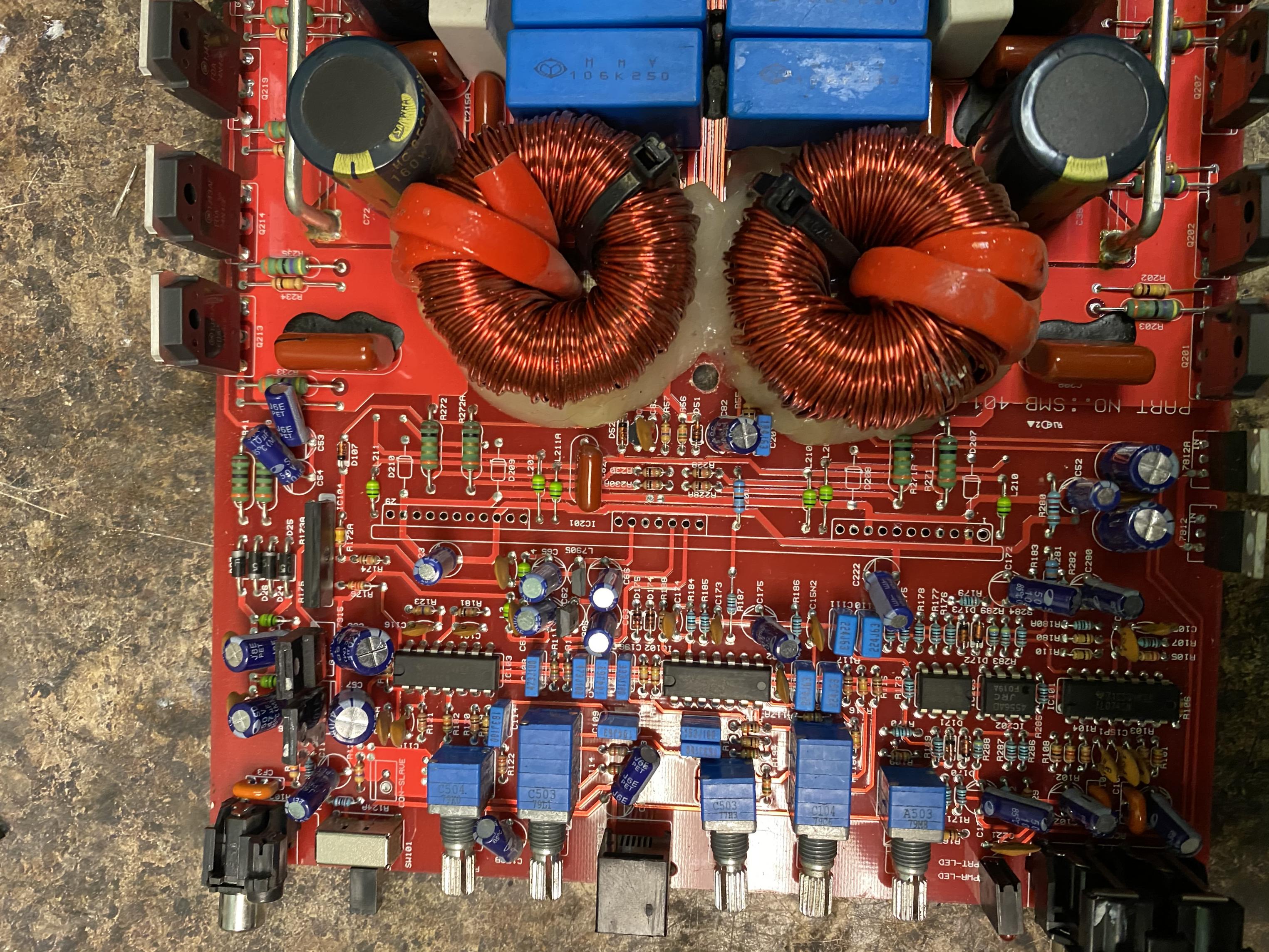

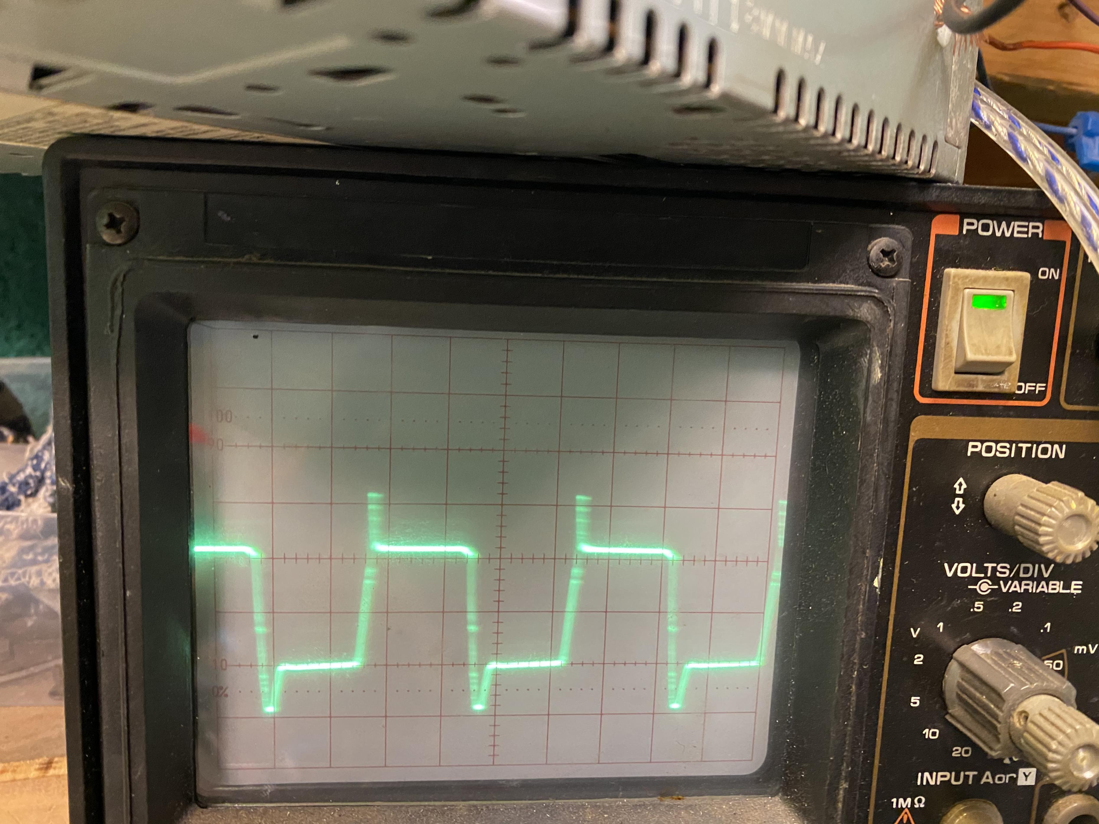

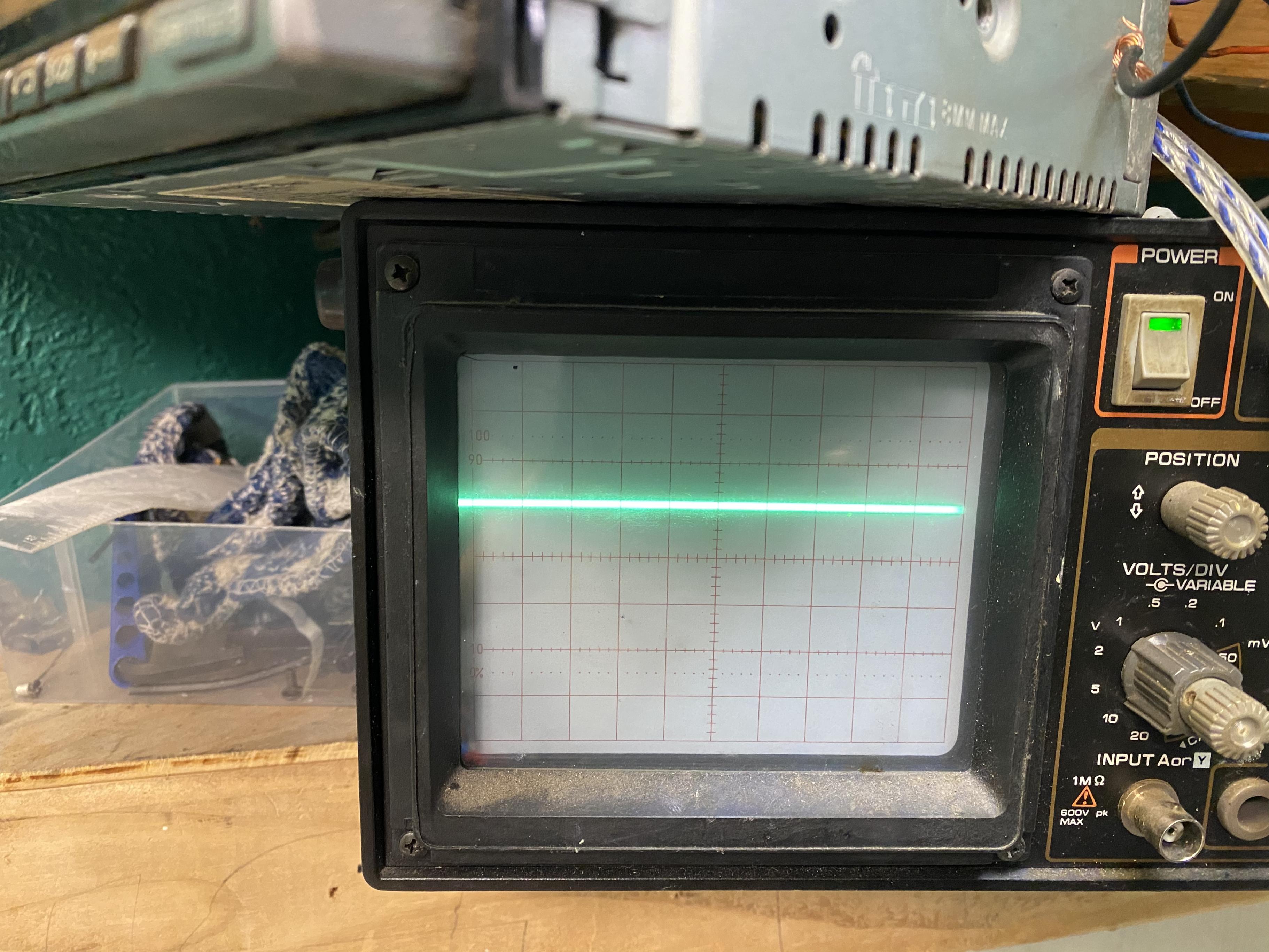

I took the audio driverboard out of the amp just to be safe so I do t blow new outputs or driver ic’s while testing .
With the audio driverboard out of the amp I have the same issue .only 3 volts on both 15 volt regulators
