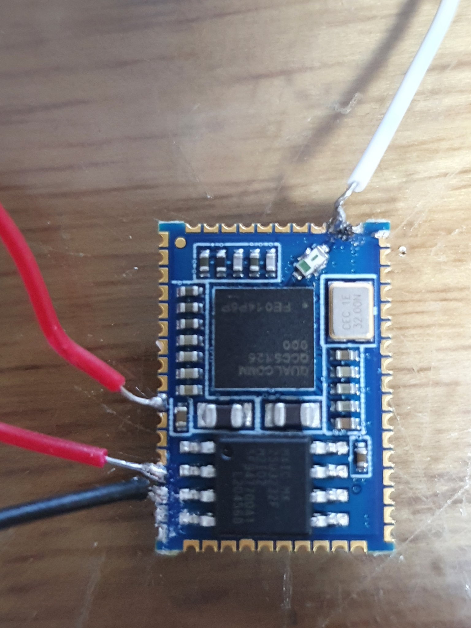

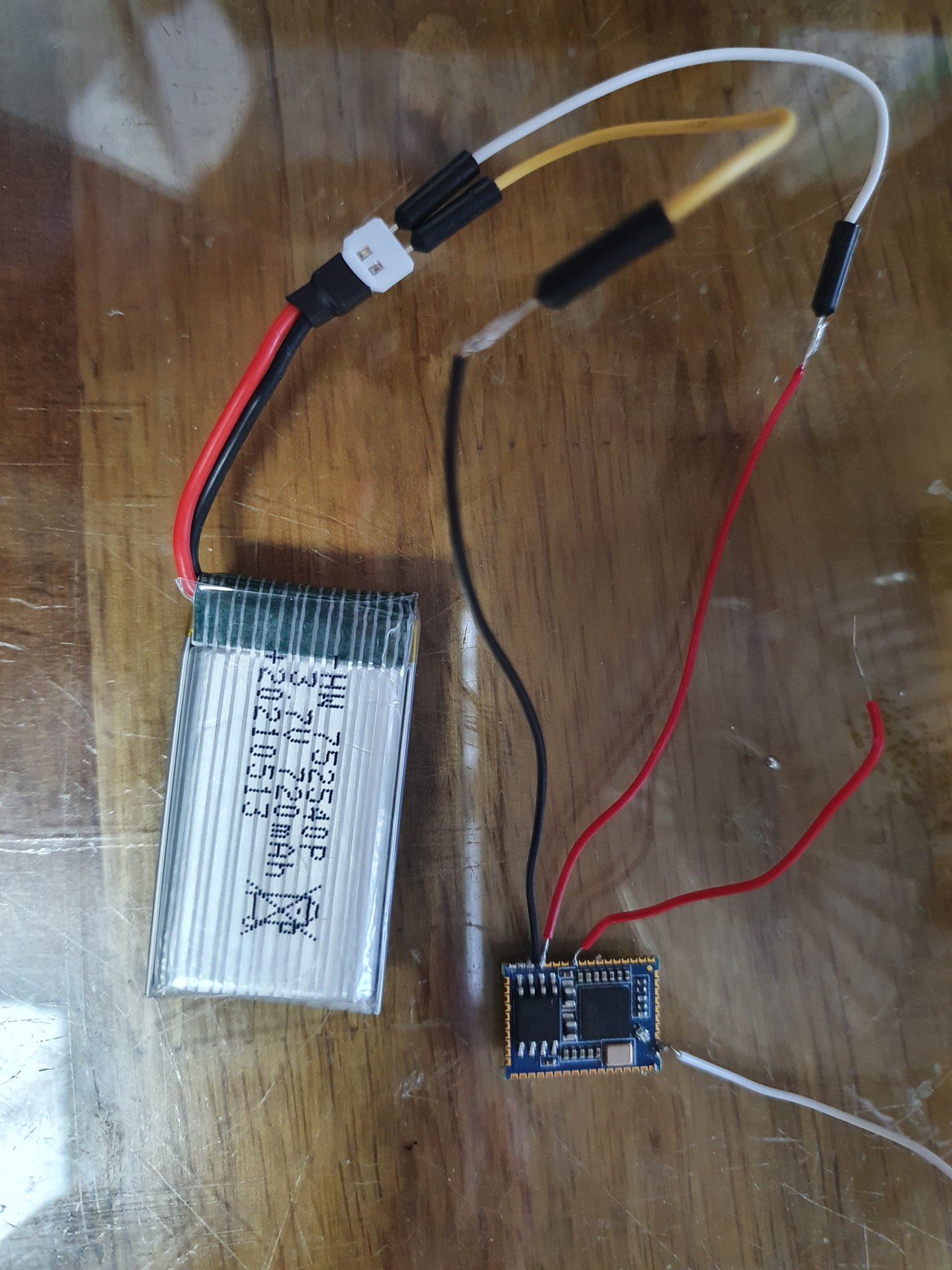

I connected the battery (4.2V) to the correct pin number, but the LED does not light up
and Bluetooth is not found.

Maybe the + and - are switched so led won’t light?

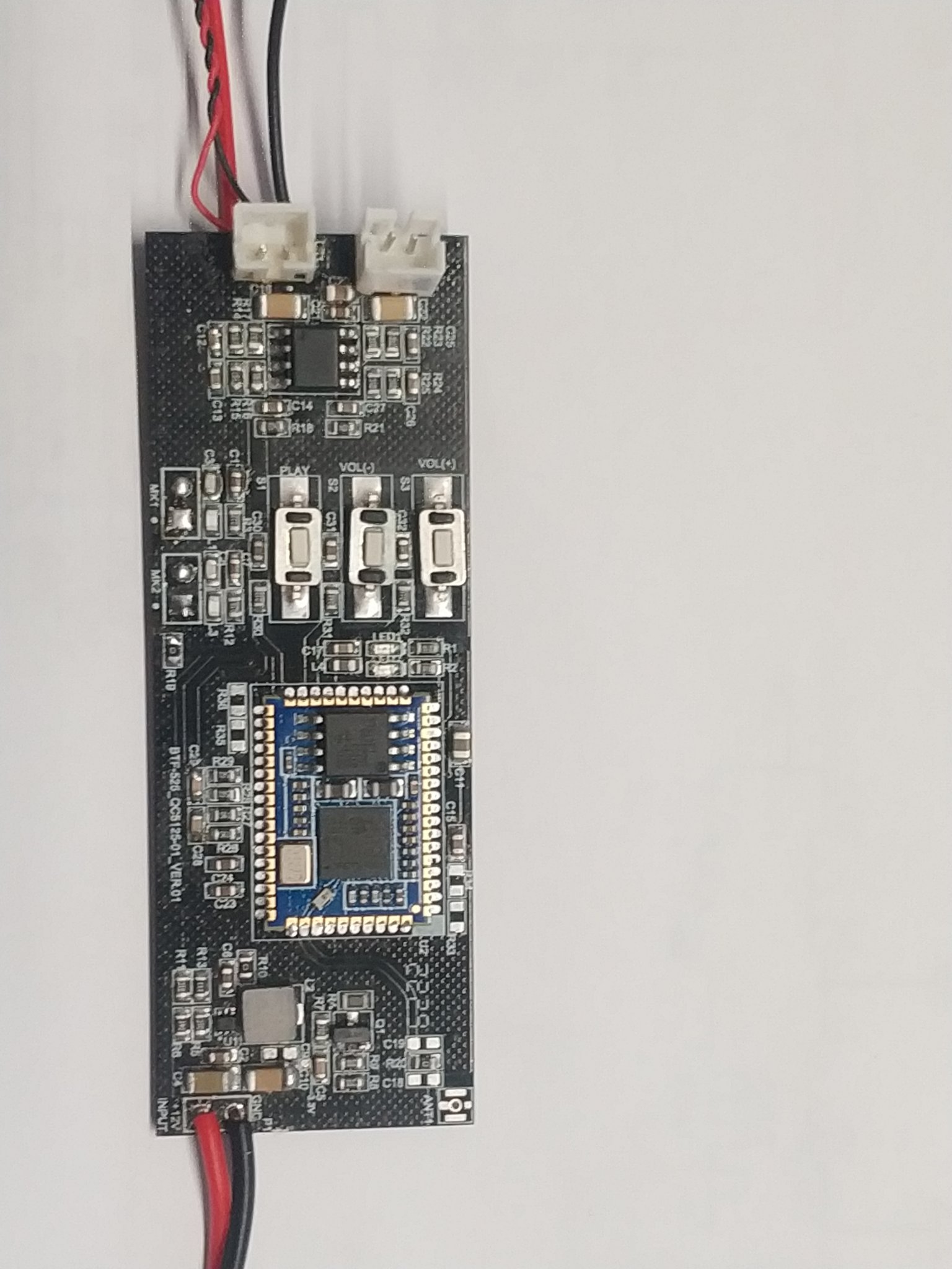

Also, what Bluetooth board is that?
Likely some variant sold of this
https://www.aliexpress.com/item/1005003772932044.htmlthat's made by SJR, a Chinese OEM.

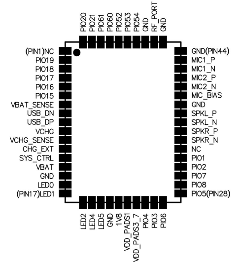

Datasheet is here http://www.tianjiarun.com/zb_users/upload/2020/04/SJR-BTM525_SPEC.pdf
Commonly used in products with BT receivers like https://www.aliexpress.com/item/1005002035641180.html

OP, can you make sure that the pins you soldered match with the datasheet?
Then, once you have, make the wires short enough so they can never short, and hook up the wires that the datasheet describes as required for battery operation. The pin descriptions below have more description; or search for 'battery' in the datasheet (ctrl+f)
