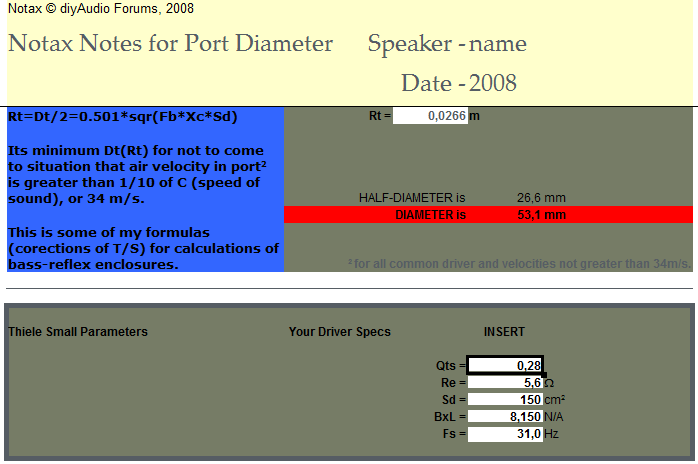

There's a lot to say and investigate. I would leave you with this. There's a software zip made by me attached, from the work of Notax@diyAudio in the port calculation, following is extensive experience. Hope you appreciate.😉
http://www.diyaudio.com/forums/multi-way/120887-port-calculations.html

Did you use the formula already (.zip)?
It gives 53.1mm min. as you can see from it, with Ron E Fb~40Hz.
Ron E thanks for the sim
Inductor yes i use the formula .

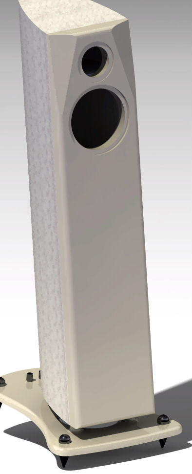

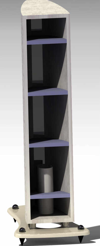

to be more precise i will put some picture with the project in question .
for driver - Usher 8948A and 9950-20 .
internal volume without driver , filtre and port is 25.6 L
final volume is 22-22.5 L.
for the port i mean "underneath"
i could try on back or front ! but underneath is easier and port size is a problem
and for FB i thought is ok a 42hz - 65mm - or 70mm diametre /
internal volume may be reduce if necessary later

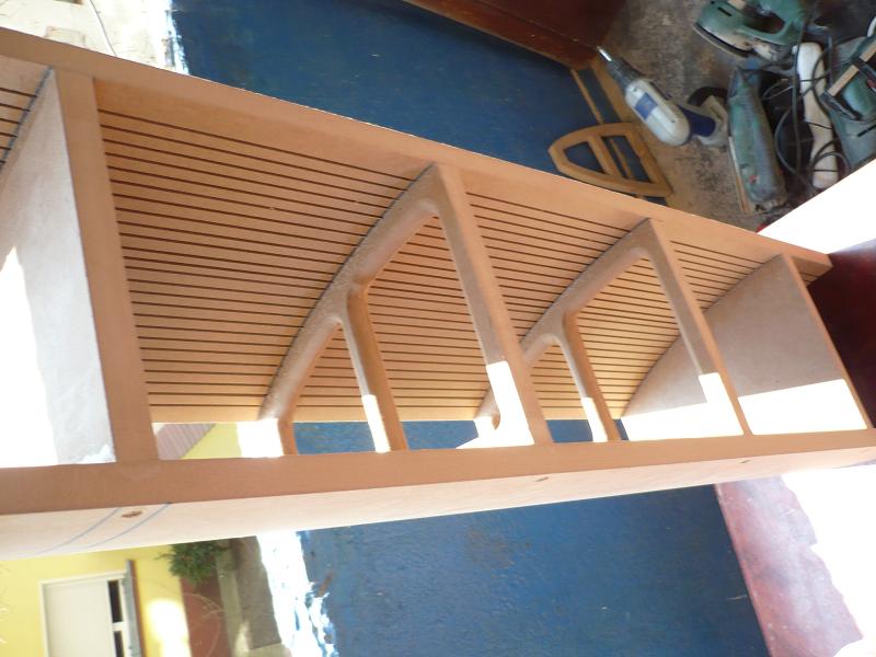

offtopic grooves in the MDF were filled with resin fiber

I don't see a problem with the location of your port at the bottom of the cabinet. In fact with that cabinet shape it's your only practical choice.
Judging by the first photo you have plenty of gap between the entrance of the port and the floor, as well as clearance around and through the supporting base plate, provided the base plate is a permanent fixture, and the spiked feet can't be removed.
(With the stand resting directly on the floor without the feet there would be insufficient clear airflow through the gap between the baseplate and bottom edge of the cabinet, IMHO)
The effect of the port exiting near the floor will be both a slight increase in the relative output of the port due to boundary gain (as described in my previous post) as well as the box tuning being slightly lowered in frequency due to mass loading from the floor, however at that distance the change would be small.
Box tunings never quite come out right at exactly the tube length predicted anyway, since T/S simulators don't model the exact shape and dimensions of a box, treating the system as lumped components, so you always need to adjust the length of the port somewhat to get the tuning at the desired frequency. (Make sure you leave room in the design to change the length of the port +/-20 % around predicted length during the tuning process)
As for whether 65-70mm diameter is enough, that really depends on the output ability of the driver, and I'm not familiar with that driver. Assuming you have a full set of T/S and mechanical parameters for it I would suggest modelling it in WinISD Pro (freely available) and take this approach:

i made some print screen with simulation in bassbox ,unibox and winisd
there are some big differences , one to another .
in bassbox for example even F3 is change after changing port area and let the same FB . 40HZ .
Bassbox Air vent velocity is much smaller then winisd including the vent resonance peak !
group delay and cone displacement is lower .
Maximum port size in bass box is 8.2cm - bigger then that - length is written in red for warning .
how much resonance pick influence sound quality ?

my enclosure may have internal volume between 22 and 28 Litre - difference cam be filled with sand .
i was thinking to use a port that may be adjusted later - 7.5cm - 20cm long =- wich possibility to introducing inside it - another port wich 7.5cm on exterior and 7.1cm interior - and length depending on mesurements .
what suggestion , opinions ... can give me .
