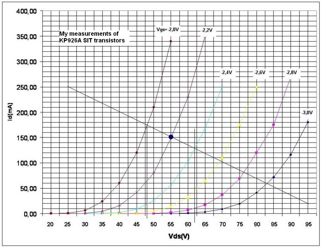

Lars, thanks a lot for the interesting datasheet. As of KP926A, I did some measurements by myself, enclose it. Enclose also datasheet in russian just for some minor information.

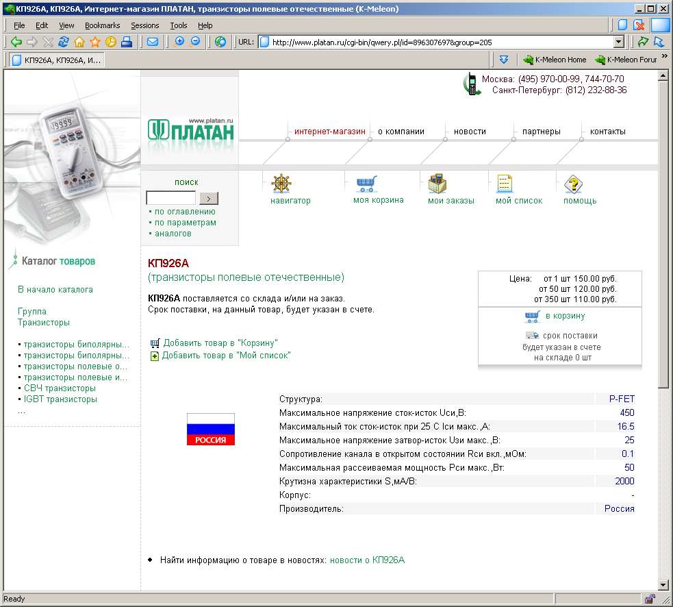

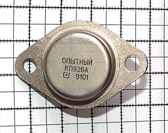

Hi Vladimir,
I really like your preamp and I would like to build one myself but I have a problem finding a source for KP926A (google wasn't my friend this time). Can you recommend the on-line store or some other way to buy these SITs ?
I suppose this is the device you used:

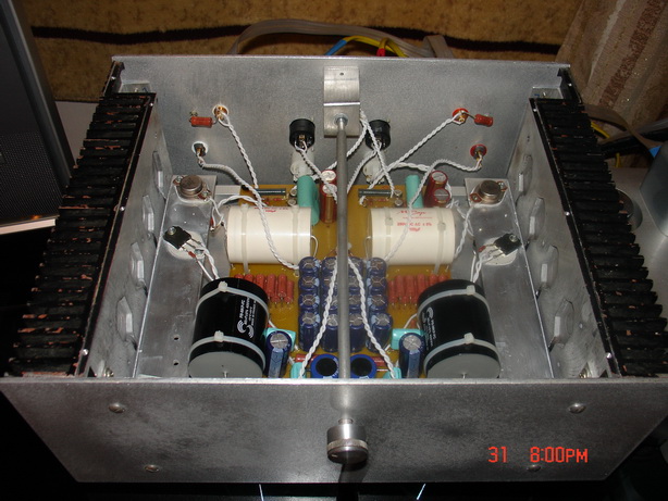

I have addes Solen 80uF polypropilene to the power supply of amplification stage, now can state that the SIT-preamp overtakes JC2 in every aspect.

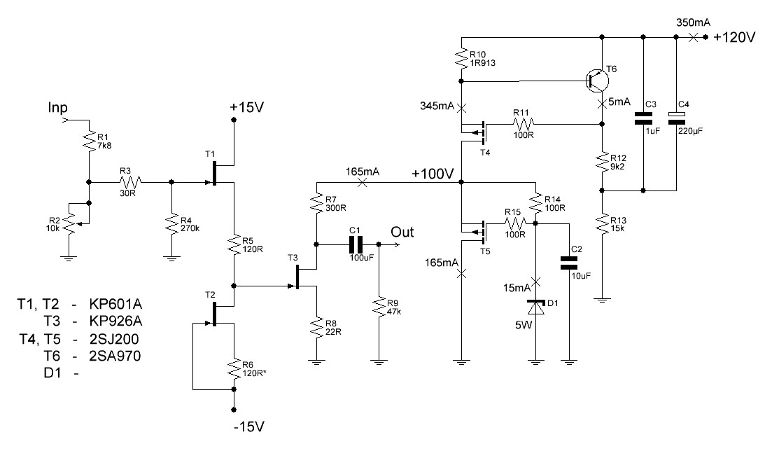

Thinking about further possible improvemens of simple SIT Preamp schematics, I plan to make parallel stabilizer with current source on the top of it for the amplification stage. Could somebody comment it, especially the choice of active components ?
Active device 2SJ200 are very good as old Hitachi L-mos. I don't like the zener diode as voltage reference. Try Norton equivalent as J. Curl. However, i think is better to put a big capacitor in parallel at the output of the 2sj200 to close the AC path of the output stage.
Also sincerely i think your amp is almost a SE Power amp than a preamp.

Francesco, thanks for your comments. Indeed, this schematics could be considered as a current amplifier (Rout=200 ohms) for speakers like Fostex etc. It sounds good, but some doubt is remaining that with shunt type power supply it could be even better. Now I escape from the power supply modulation only due to big polypropylen cap. I should also check the Norton equivalent.
