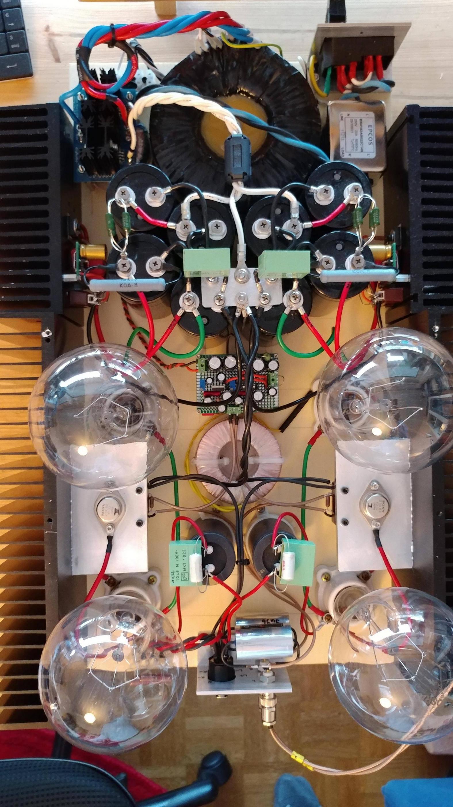

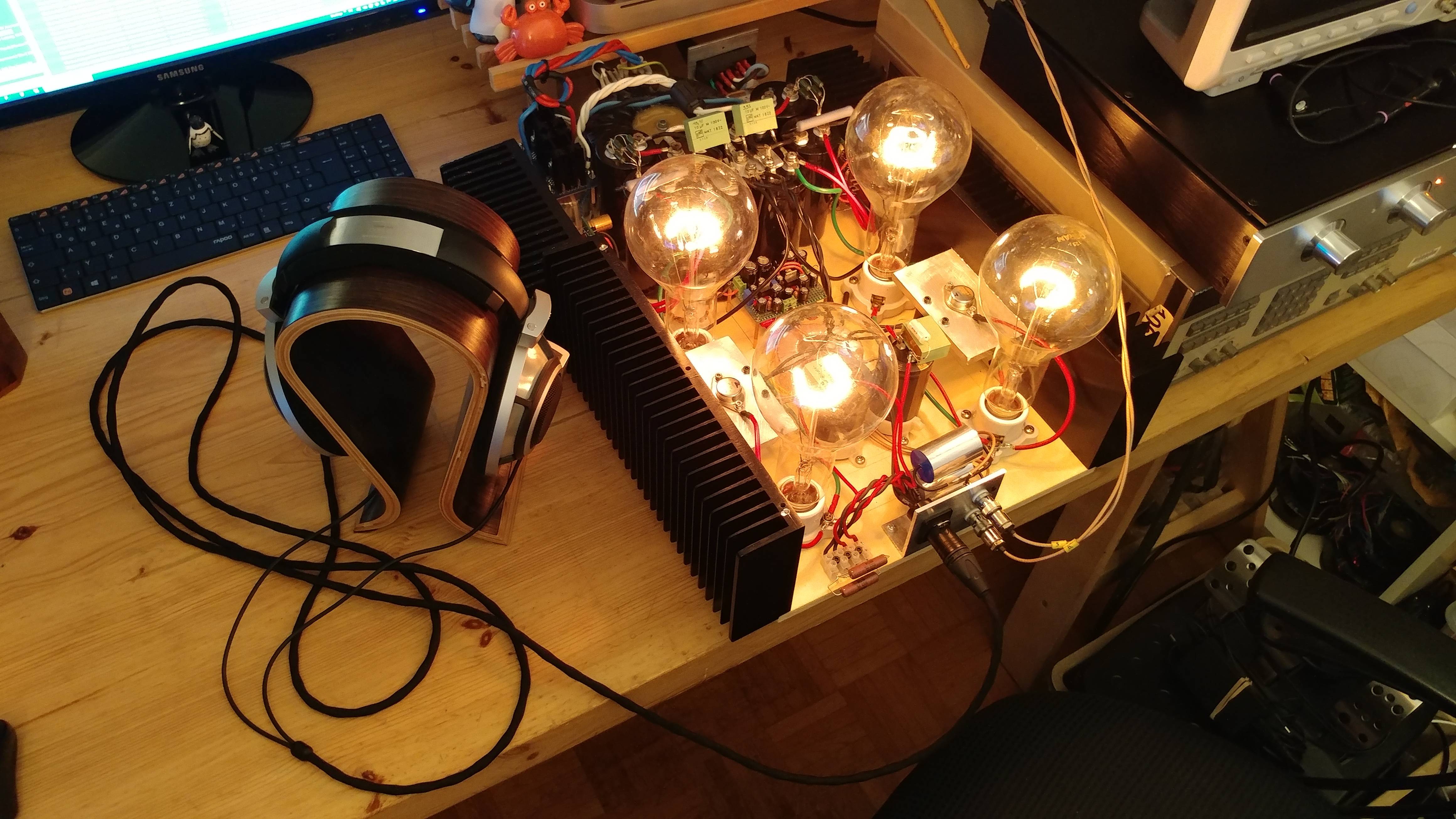

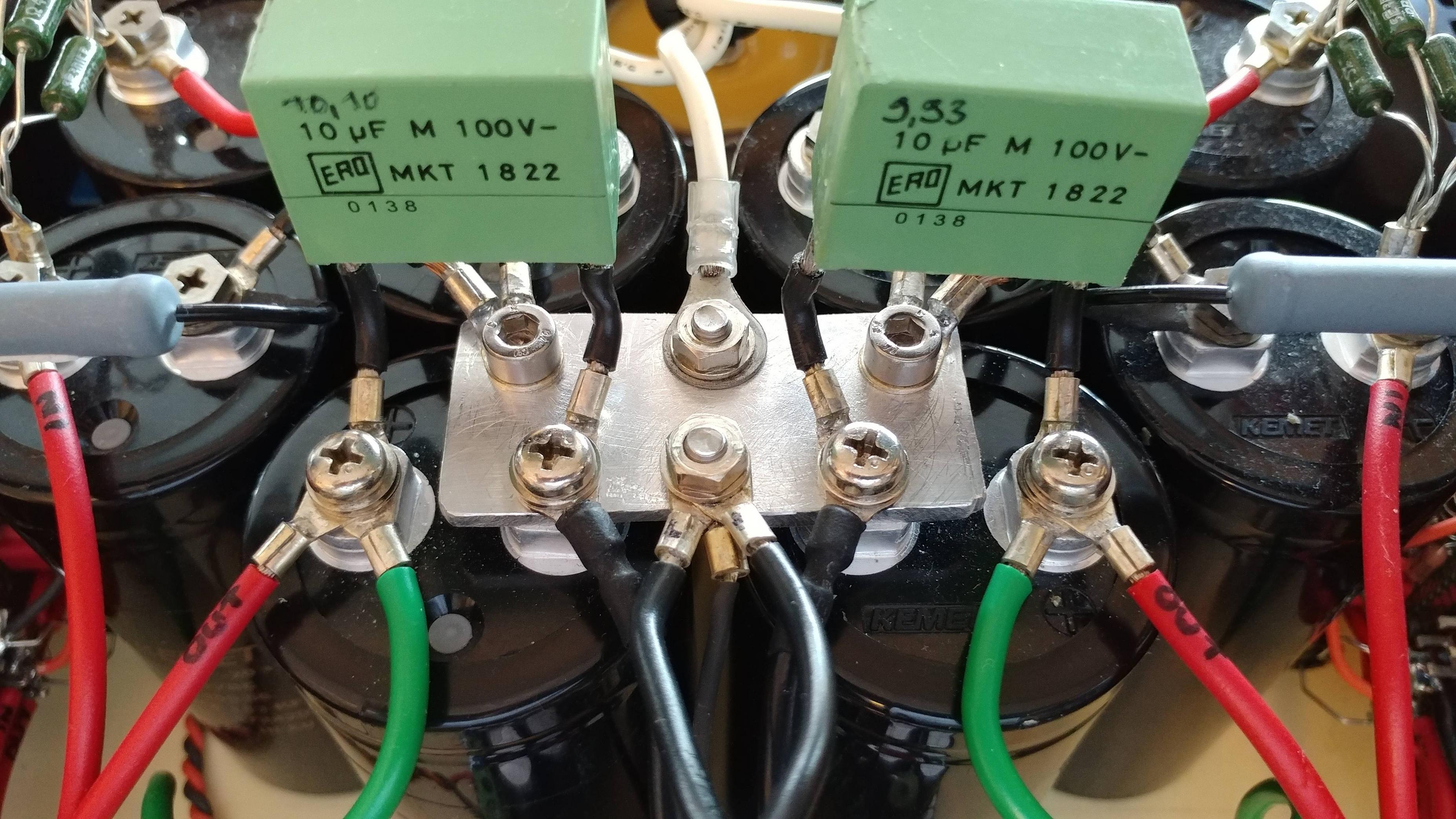

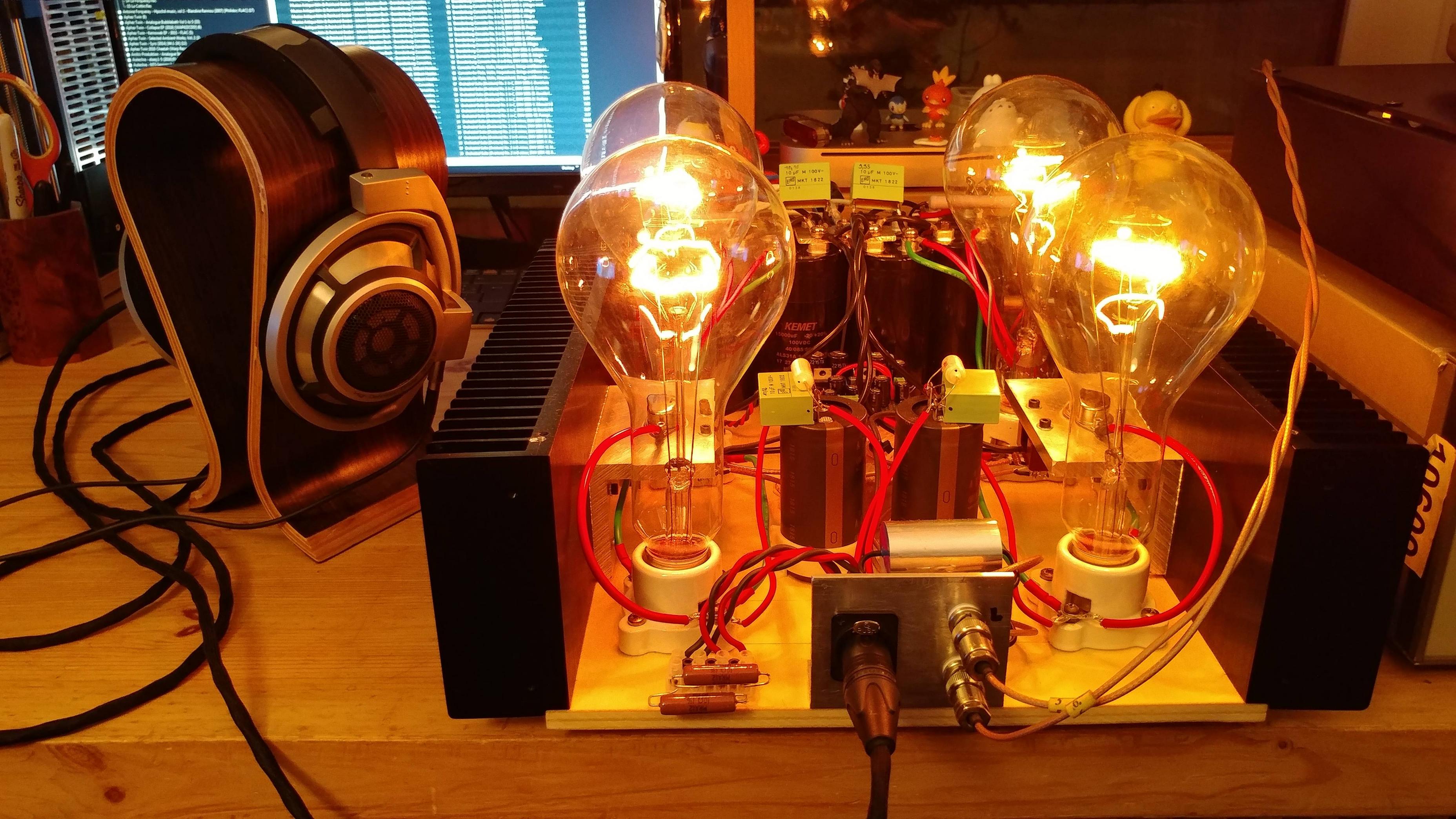

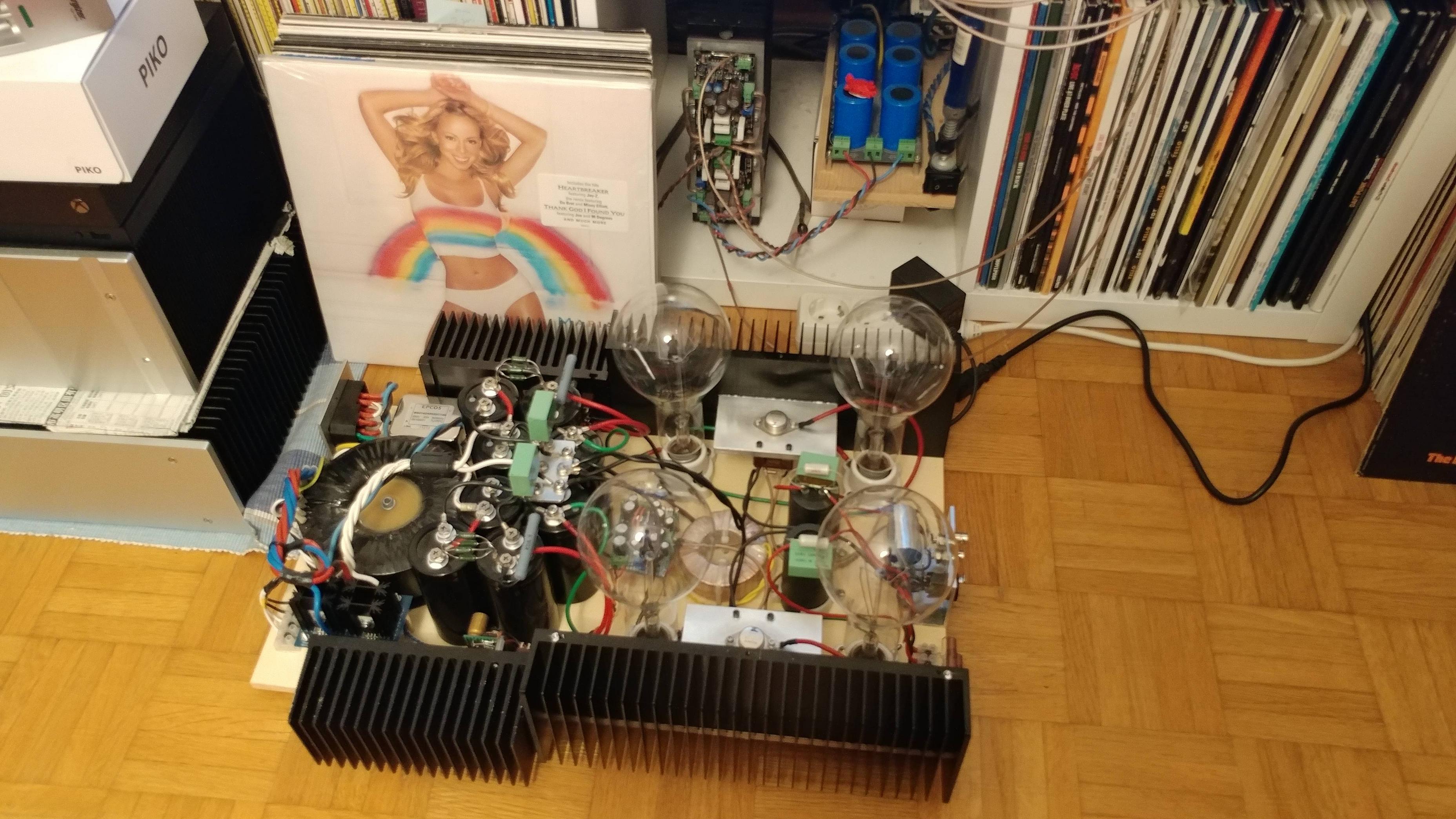

I have built L'Amp: A simple SIT Amp for my HD800, and I must say, it's magnificent.
It's huge, it's heavy, it's overkill, it gets hot. In other words, perfect.
The last pic gives you an idea about the actual size of the amp...
