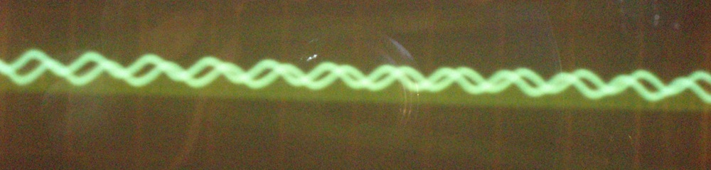

So the amp switched on. It produces audio at quite high volumes but there is some distortion in the sound. It may be caused by my setup, or the fact that I dont have one output transistor in circuit.
Also there was 0,44VDC between speaker terminals without any input. When switching amp on there is about 0,2V but it slowly rises to 0,44V.
Photos of how 100Hz sine looks like on the speaker terminals. First photo is 1V/1ms, second one is "close-up" 1V/1us.
Do you recommend replacing all outputs, just one or the bank of 4 outputs where the defective transistor was?
At least replace the group of 4 that had the defective transistor. Carefully check the gate resistors to confirm that all are within tolerance.
