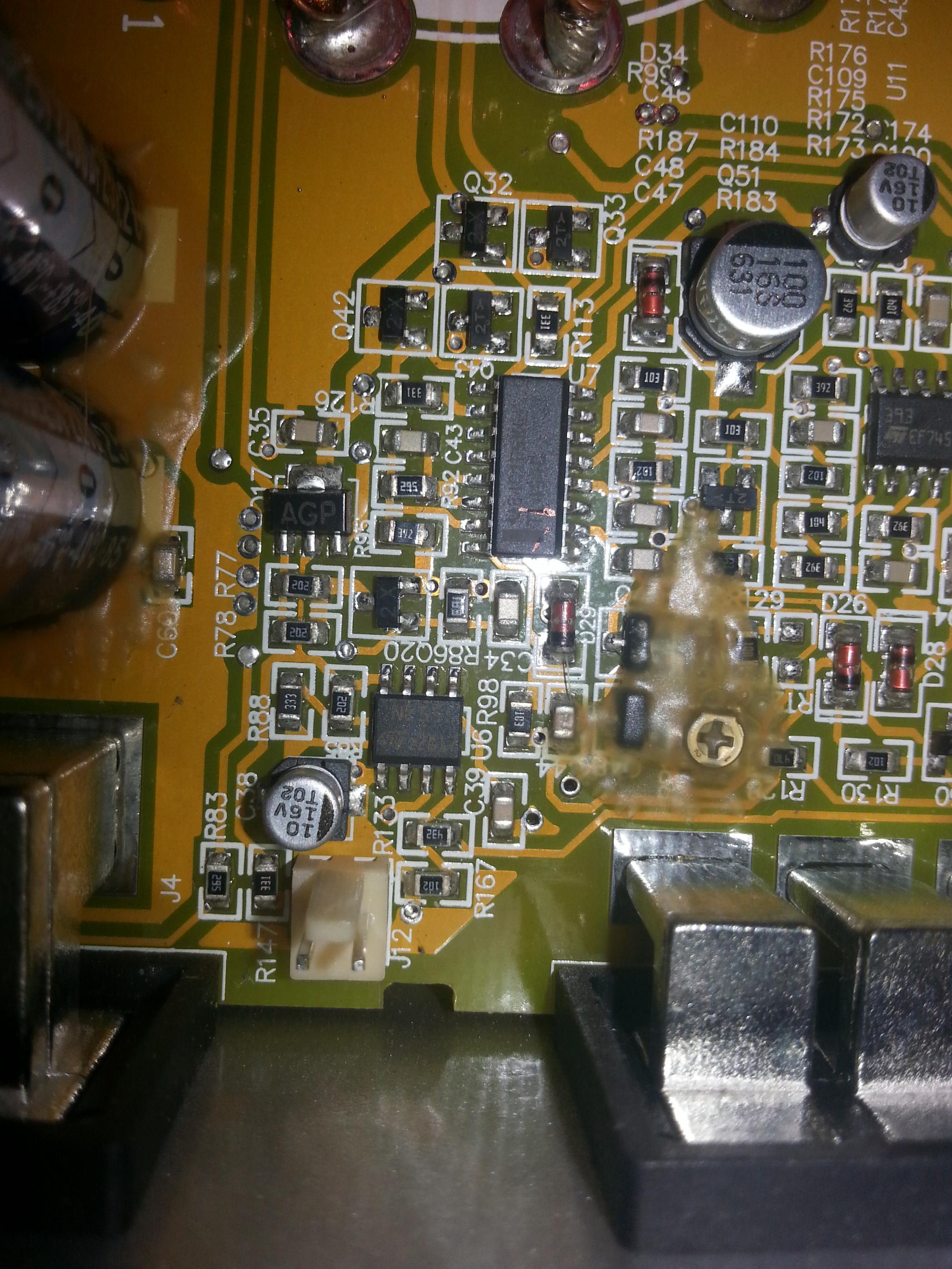

My Sla1500 recently broke down and wonder if i can get some help trying to fix it.

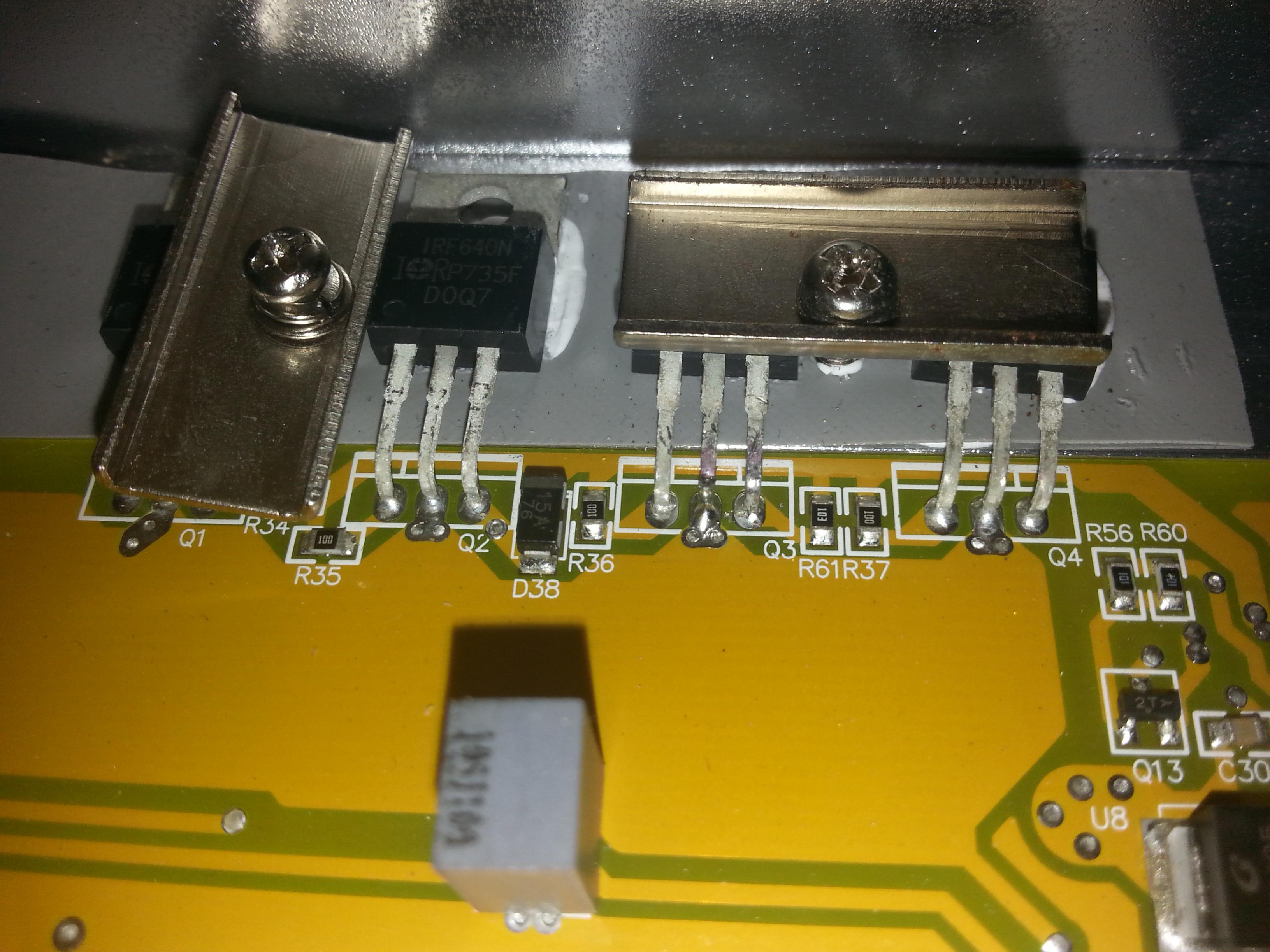

It goes straight into protection when starting it up and power light is flashing. Noticed that 2 mos fet pins of Q3 was broken so soldered them back but still in protection so started measuring the TL494 chip and accidently brigded pin 1 & 2 and the amp stopped going into protection but still unable to play any music.
Here's full read out.

Also accidently touched pin 9 & 10 togheter due to fat pins on the multimeter so it burnt mosfet Q29,Q30,Q31
P60NF06 7sanx V6, I have purchased a few P60NF06 Gk11 V6 to my sla 3000 that broke down and wonder if i can use them on the 1500?

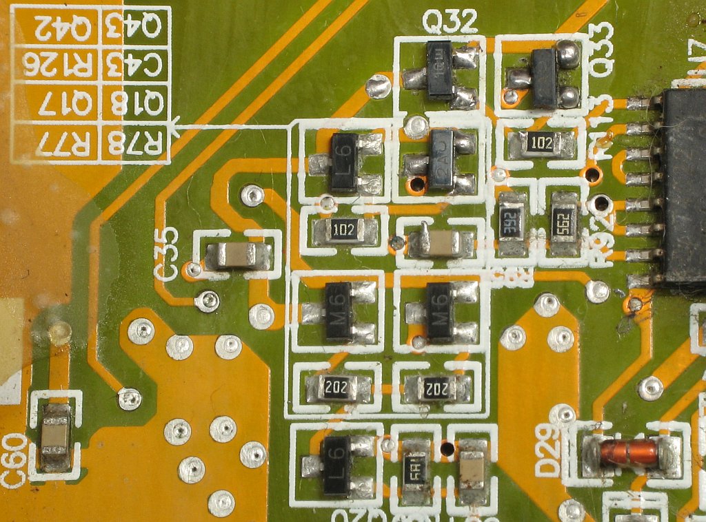

I have not replaced anything yet im to shakey to solder so have to call my brother for that, Q43 & 42 look good, no visible damage on them, and i dont have any spares for them. T or +2 thingys.

Q43 & 42 are marked X 2 on top of them, at first glance i thought i saw T or + 2 marking, sorry about that.

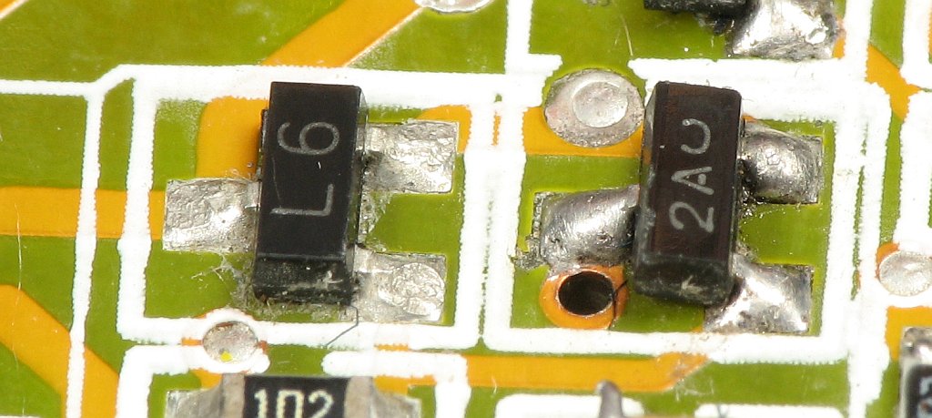

Are you sure that you're looking at the right transistors?
They cannot have the same part numbers. The originals are typically marked L6 and M6. In the photos below, the PNP driver failed and has been replaced with an MMBT3906 (2A).
Quite positive. But was marked Q42 - 2X and Q43 - 2 T>

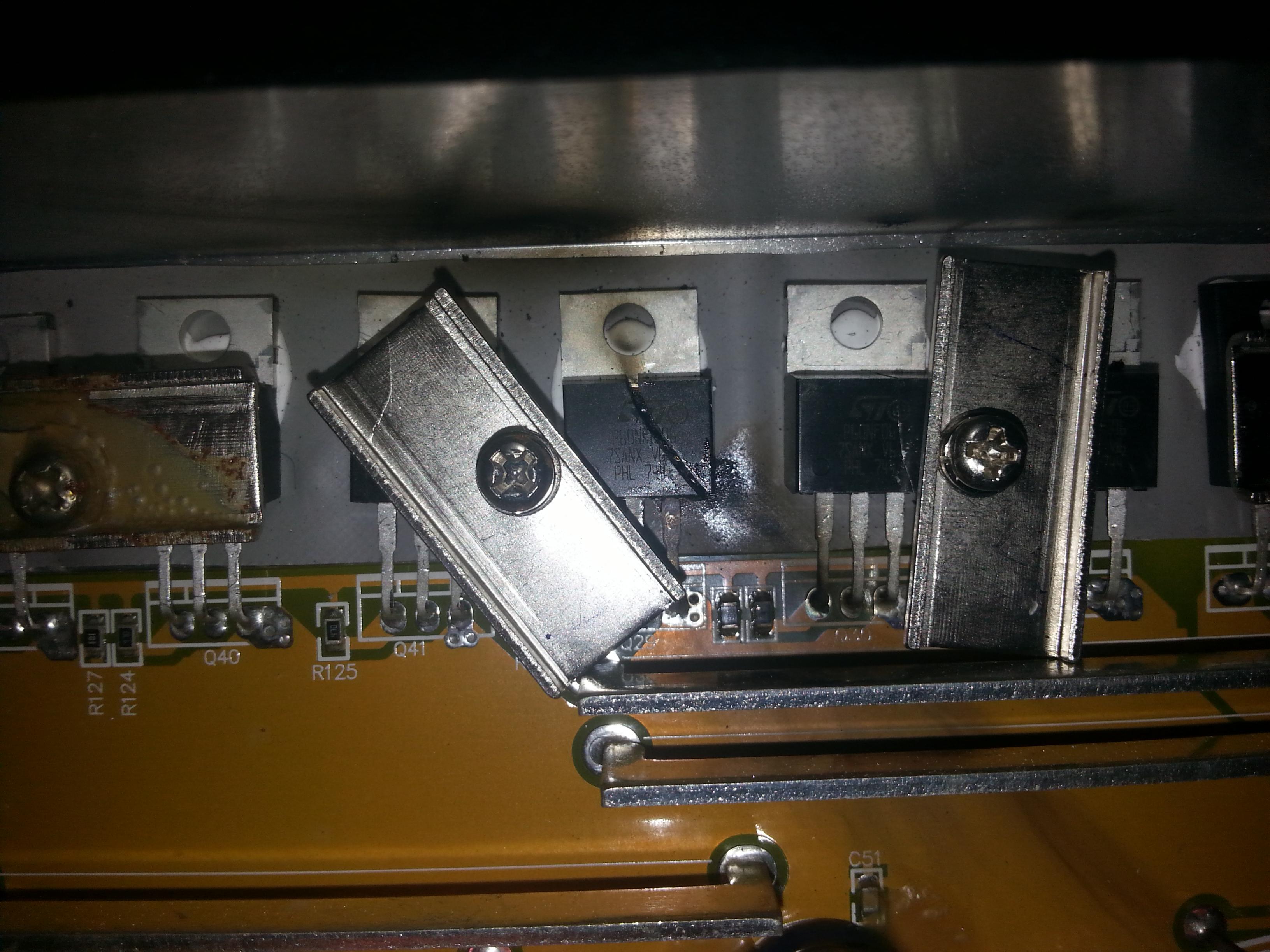

Exchanged the 3 P60NF06 7sanx V6 with the P60NF06 Gk11 V6 i had, but when i was going to power it up to check the TL494 they broke again (burned up making the holding metal glow red hot) So i consider this amp quite dead.
