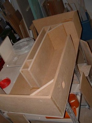

nirvana Member Joined 2007 2009-01-25 3:06 pm #1 2009-01-25 3:06 pm #1 what do you think about singular speaker design for my Supravox 215 signature bicone ? QTS : .856 I want to replace my giant BIB. Attachments 1_singular14.jpg 29 KB · Views: 299 Scottmoose Member Joined 2005 wodendesign.com 2009-01-25 4:41 pm #2 2009-01-25 4:41 pm #2 Nope. High Q + highish Vas = large box. You're not going to get a decent response out of it. Status Not open for further replies.
