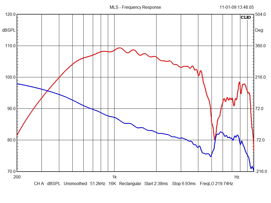

I have had both the BMS 4592ND and the Community M200 in a Jabo KH53 horn. Within the 500-3,500 frequency range, the M200 sounds more natural and relaxed than the BMS - maybe due to the lower compression ratio. The frequency range of the M200 is restricted (especially compared to a coax like the BMS), but within its range, it is excellent!
IIRC, djk (R.I.P.) had a friend who could not differentiate between the M200 and a TAD 4001 in the same horn, in the frequency range mentioned before. Besides, the M200 is fairly priced.

After BMS midrange i also try M200 - and yes its more relaxed sound. But it won't go lower than 600hz.
Well, in a sufficiently large horn the M200 will definitely go lower than 600 Hz. The attached file is raw measures when mounted in the app. 350 Hz Jabo KH53 horn.
