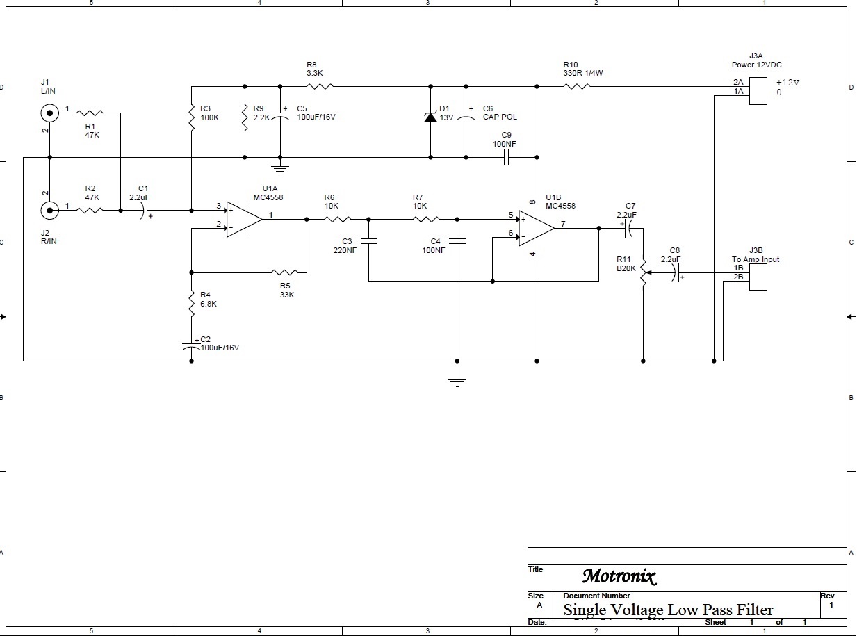

Single Supply Low Pass Filter if it help you? N-Joy 😀
Thank you so much for the schematic diagram. I was just looking for something like this.
I have still some problems (Sorry😱):
I doubt whether I will find any Zenor diode of 13V in my local market (12V Zenor is available, will that do?)
And C6 in your diagram shows "CAP POL", what Capacitor should I use here?
You can use 12V Zener this is to stabilize the power supply voltage and make sure it not over the 12V. but... this diagram can work up to 24VDC so you can not use this diode at all. the capacitor can be 100-470uf 25V elect.
