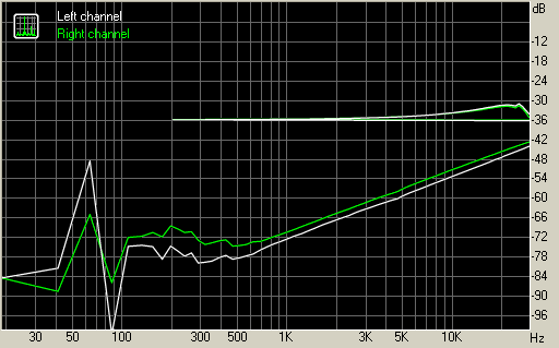

FWIW, I use a single 6SN7 for both channels in my preamp. Here's the separation curves. I think the limitation is the volume control, not the tube.
Don't sweat it. 😀
