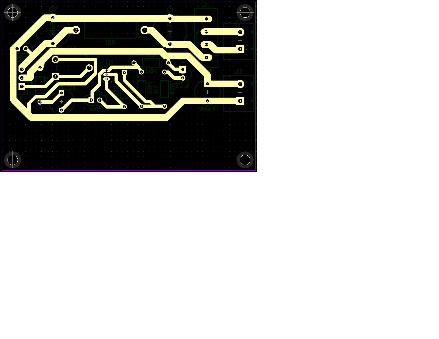

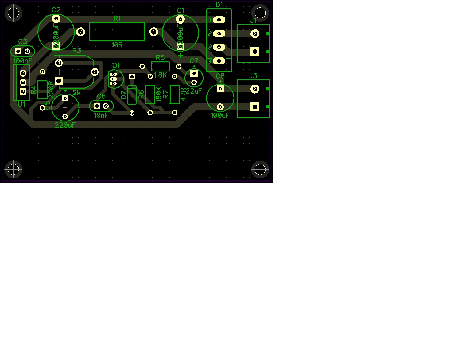

Hi guys, I would be grateful if someone might cast an experienced eye on this PCB layout I have come up with for a single rail LM317 denoiser board. 🙂
It's sized to replace the old PSU board of a preamp I have built, it will be interesting to compare this to the old LM317
Hi all, I am trying to put together a PCB for a single polarity LM317 Denoiser and with the help of a few other members I have gotten this far.
The point of the exercise is to be single sided so that it can be etched at home if desired, there are many excellent fab PCB designs available but I haven't found a simple single sided one.
Still to do is to align the resistors vertically if possible, change the type of potentiometer and to make a single PCB but dual mono layout.

TO220 always to the side for mounting on casing or external heatsink. Even with a clip on heatsink heat is better kept away as far as possible
Larger footprint for C1 and C2 (or use 2 footprints) and please align them
Larger footprint for C7 (or use both)
Align C5, C7 and C8
Align R4 and R5
Revise GND PCB track!
it would be OK to have a bit wider PCB tracks especially where power flows
Use a film cap close to the input pin of LM317
Larger connector for J1 and J2 i.e. Phoenix MKDSN (or use both footprints)
Choose standard footprint for R2 as that format is pretty obsolete by now (or have both footprints)
Use smaller footprints for resistors that don't dissipate power
Put the 10 nF horizontal and a bit to the right
Q1 to the right and D2 a bit lower
You could put D2 vertical and R6 and R7 too maybe it creates space
I think all resistors can be aligned (and mounted vertical) except for R1

Thank you very much Jean-Paul, as you can probably tell I am rather new to this. 🙂
I tried to make. The ground a continuous run, paying attention to flow. Please forgive my inexperience but what exactly do you mean by revise it?
Reroute it.

Is this for small current application? If it is not a limit imposed by design software, I would use much thicker PCB traces for ground and current carrying lanes. Rectifier could be rotated by 180 deg. and ground will go all around core circuit, so some copper pouring (zones) can be used.
Thank you tombo, will do as you suggest.
The circuit will not supply more than 150mA or so but the track width was just the standard 1mm of the program.
I’ve not experimented with copper pours, is the idea something to do with performance or something else?

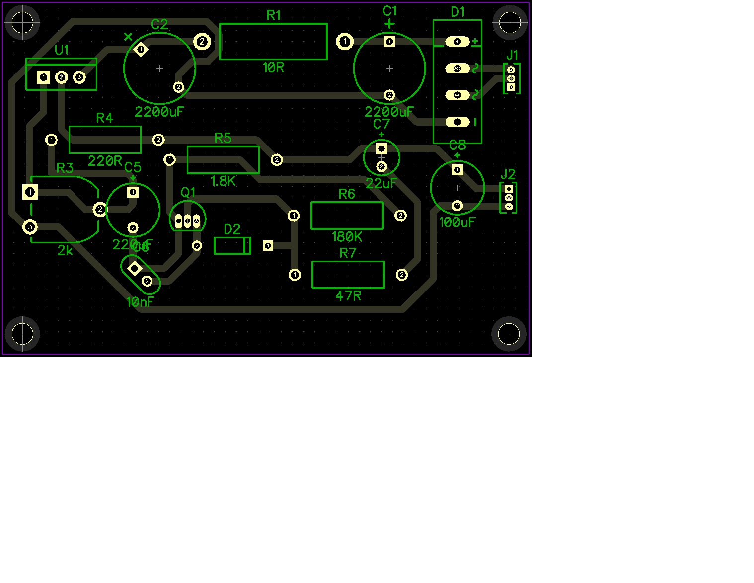

The latest effort, involving most of the easier suggestions in post #1278
I'll work on getting the resistors vertical and making a dual supply version.
Thanks for all the help once more, chaps.
P.S. What size for the Input film cap, C3, 100nF, 1uF?

That's better. 100 nF wil be OK. BTW you could put footprints over each other giving the possibility to use 2 sizes of for instance connectors and caps. The way you changed the connectors does not make the standard MKDSN fit as the holes are larger. If you rotate R3 90 degrees to the left and change pins 1 and 3 you can make it nicer for R4 and C5 (way shorter track). Q1, D6 and C2 can then move further to the left making it possible to align R5, R6 and R7. C7 and C8 can then also be aligned vertically.
C1 Could be a few mm further from the diode bridge, C2 can move to the left. If you move them both a few mm to the upper side and add an extra footprint for larger filter caps you can experiment or reuse the design for higher voltages/currents.
R1 could be replaced for a coil which has a smaller footprint as it is mounted vertically. If you change the diode bridge for separate diodes you could use Schottky diodes, fast/slow recovery diodes in other words you can use any diode you wish. You could then also add caps parallel to the diodes.
You could also add footprints for a snubber network.

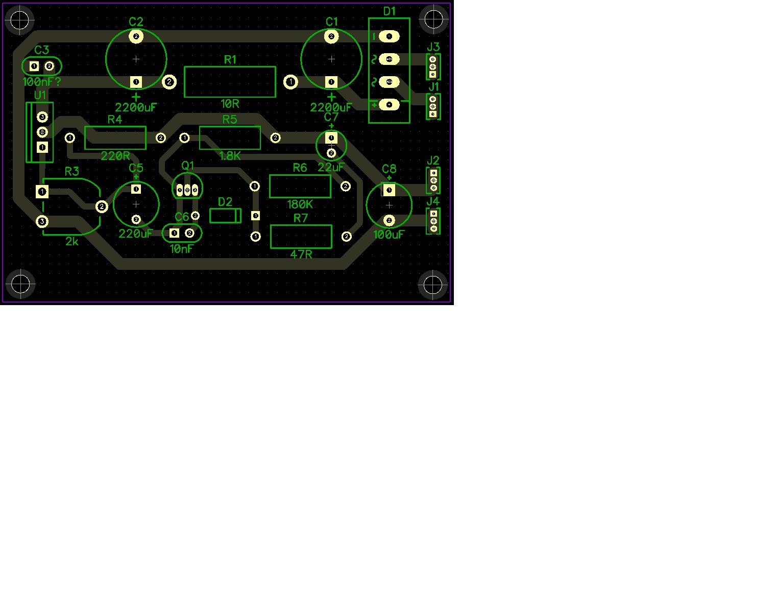

This is the latest, tried to get as man resistors vertical as I could and keep the caps in alignment.
I am trying to keep the traces as short as possible as a point of principle, is placement more important or the former?
