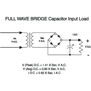

Here's all you need to know: https://www.hammfg.com/electronics/transformers/rectifier
If you use simply tape off the centre tap and ignore it, you will have twice the voltage and only 62% of rated current when using a capacitor input filter as using the centre tap and two diodes.
Interesting and loosing me a little.
So this trafo is 35-0-35 and was hoping to get approx 50vdc. It's for a power amp so I want all its current. Not sure this is going to work for me.. atleast for the class d amp I had in mind . Might be better to use it as a dual rail and feed a solid state +/-
35 + 35 = 70. 70 times .71 = 49V.
So use the Full Wave version above, the bridge version will make 100V.
Real life the voltages will be lower from the load... I'd expect about 42V - 45V when loaded depending on how many VA the transformer is and how large of a cap you plan to use...
