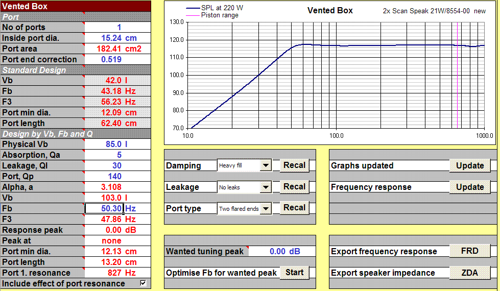

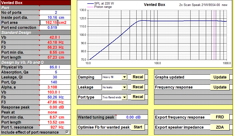

I'm using Unibox to try to calculate port tube size for dual Scanspeak 8554 drivers. If I use a single port tube in my 3 cu foot box (sorry already bought and mounted drivers there) it tells me I need a 5" or 6" diameter port tube. Is there any benefit to using dual port tubes? Will one sound any different than the other. I was planning on using dual flared Parts express tubes.
Should I put the port tube close to the woofer or far away?
How do you decide what frequency to tune for? (for now I have chosen 40hz since the bass guitar is the lowest instrument I commonly listen to)

As for the question if double vents are better than a single one:
If we are comparing vent with the same total cross-sectional area, ie the summed area of the two vents is the same as the area of the one vent, there might be a slight advantage towards the double vents.
The reason for this is that for the same airspeed (which is different from volume flow, nb), it is harder to develop turbulence inside a narrow tube.
However, using rediculously narrow tubes, like 1 cm diameter, increases the flow resistance, and that is typically bad.
It appears I can use two port tubes 10" long - 4" diameter to achieve the same thing that one 9.5" long - 6" diameter tube can do.

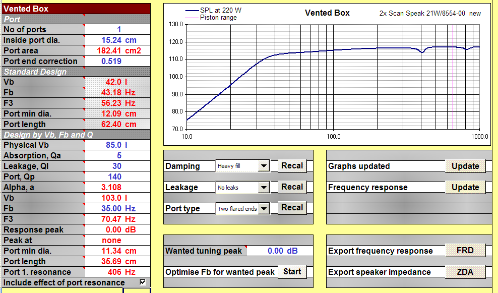

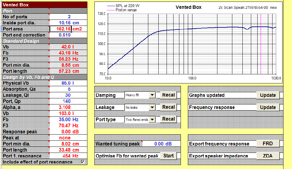

Should I take the port resonance (as modeled by Unibox) very seriously? It shows that I could possibly have port resonance varying from 400hz to 800hz only 12db down from the port's peak at say 40hz.
Should I measure port tube length from the tips of the flare? I am using a dual flared Precision Port from Parts Express.
It appears in modeling that lowering the port tuning can increase resonance. This is probably due to the longer port length.

Daveis said:It appears I can use two port tubes 10" long - 4" diameter to achieve the same thing that one 9.5" long - 6" diameter tube can do.
Should I take the port resonance (as modeled by Unibox) very seriously(is it audible in other words)? It shows that I could possibly have port resonance varying from 400hz to 800hz only 12db down from the port's peak at say 40hz.

Daveis said:Should I take the port resonance (as modeled by Unibox) very seriously? It shows that I could possibly have port resonance varying from 400hz to 800hz only 12db down from the port's peak at say 40hz.
Port pipe resonances are a reality and yes they should be taken seriously. However, there are great difficulties in modelling their amplitude correctly, since it depends largely on the placement of the port in the box. Port placement is rarely considered in simulators (I don't know about unibox, though).
And yes, the longer pipe that is used, the lower frequency the pipe resonances will occur, and they will be stronger.
Also, the tuning of the port is also somewhat hard to model exactly, partly due to the largely unknown amount of isothermalization from the box stuffing. It is often a good idea to verify the port tuning by measurement and adjust the port length until a close enough tuning is achieved.

I am using 24db/octave at 800hz. I notice that port resonance in all cases I've considered is under 800hz and will be competing with the bass driver. I suspect this is the norm.
