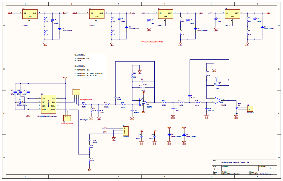

The original design comprised regulators and a sixth order Sallen-Key based VCVS to convert the square wave from the source into a clean sine wave.

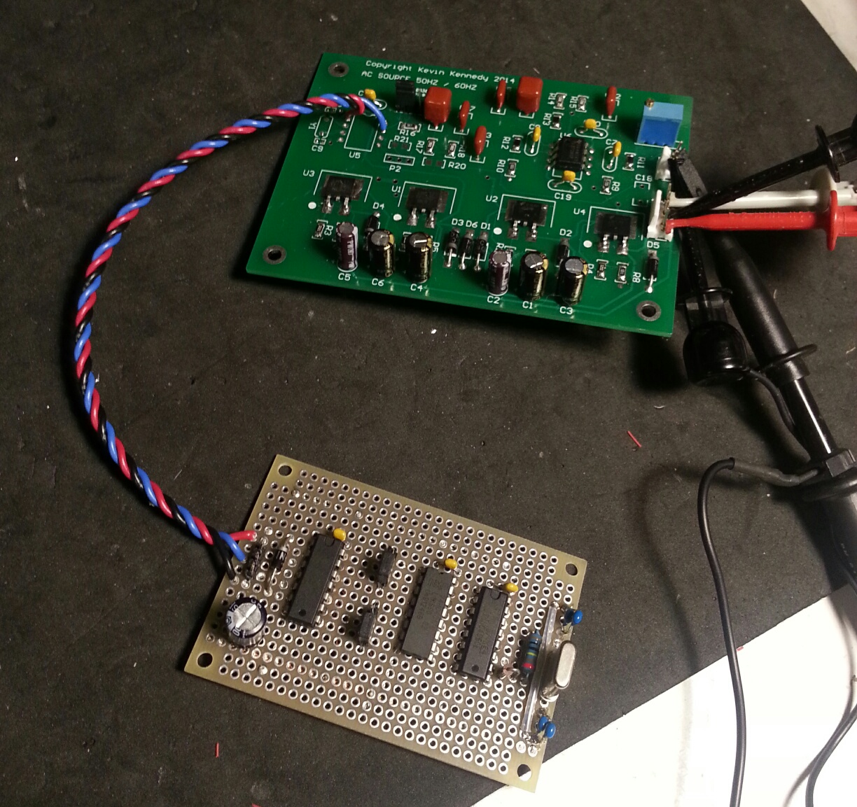

I laid out the original project in Altium, but in a story too long to share here no longer have access to a license. The additional board was hand built p2p on vector board.
Currently what I have is built on a number of PCB I laid out and a hand built prototype of the oscillator/source.

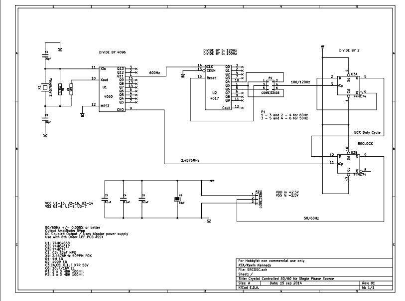

Oscillator:
Anyway referring to the oscillator schematic (KiCad), the binary counter used, a 74HC4060 incorporates a competent crystal oscillator. I chose to use a 2.4576MHz crystal to reduce radiation of harmonics resulting from the use of a higher frequency crystal, and because this frequency subjected to binary division results in a value friendly to simple further division by a 74HC4017Johnson counter. I chose a divisor of 4096 which results in an output frequency of 600Hz, a further division by 5 or 6 results in 120Hz or 100Hz respectively, and a final division by 2 via a D flip-flop gives you a duty cycle of 50% and 60Hz or 50Hz with a single crystal, three cheap chips, a few caps, and a couple of headers for configuration are it.. Not elegant, but functional. I probably should not have used 74HC series parts due an amplitude asymmetry that results in DC offset at the output of the filter. (It can be nulled.) I have not yet evaluated 4000 series CMOS equivalents, but they may work better, the 74HC74 would have to be replaced with a 4013 requiring some minor changes, but the 4060 and 4017 slot right in for the 74HC series parts or would had I had sockets on hand.. LOL
LPF Filter:
This was also surprisingly cheap compared to through hole switched capacitor filters and performs more than adequately, note that it was really designed for 50Hz, but I have not retuned it for 60Hz (there is such a version) as this would degrade the 50Hz performance substantially.. The filter is about -3dB at 60Hz compared to 50Hz a compromise I am happy to live with, and the current filter is down more than 50dB at 150Hz relative to 50Hz, and is even better at 180Hz when outputting 60Hz.
The filter is two cascaded 3rd order moderately high Q LPF filters, Q is ~2.2, no attempt has been made to be clever or to optimize anything other than stop band attenuation - it's not necessary for this application.
Bipolar power is used in order to try and minimize power up LF transients that might trip the amplifier protection circuit when driving a transformer. (Transformer behavior when confronted with DC) The jury is out on how effective that might be. Long mute period may be needed, or even ramping up the drive signal to the amplifier.. To be seen I guess.

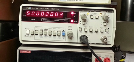

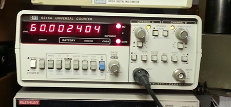

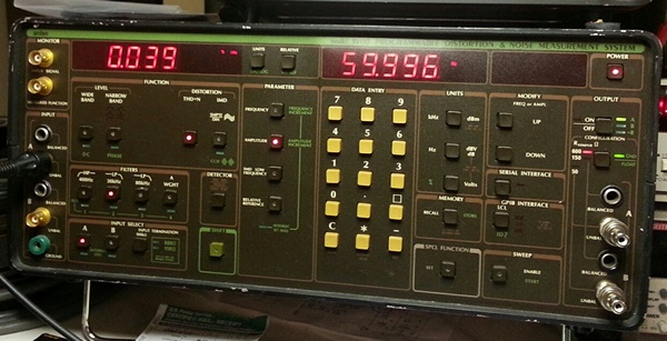

Some basic measurements..
For frequency related measurements refer to the HP counter as it is more accurate than the Amber frequency counter.

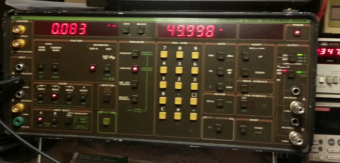

THD measurements are done with the 30kHz LPF engaged. (No significant difference without it) Measurement set is an Amber 5500 with the high performance pack.. (LOL)
