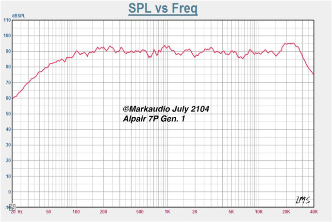

You'll still need some EQ or Qts boost ....
I may use some light passive eq before the amp to boost bass as typical listening will low be enough to accommodate, do you mean parametric EQ to fix the more complex issues with response?
I was totally satifisfied with bass quantity from the sealed 7p and the quality was excellent.
Don't see how that's possible, as there's very little bass to speak of looking at the sim.😕

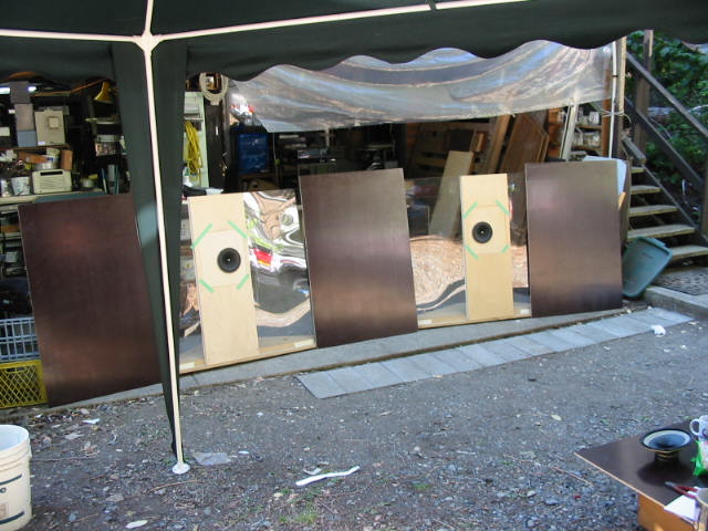

So i made quick and dirty baffle from some pine planks for just one of the drivers, a couple of 400x1200mm planks side by side for 800x1200mm baffle.
It has *some* bass, not non-existent bass like the other smaller baffle but not enough either, however much more importantly it sounded absolutely awful on this baffle... so that settles that.
There is a good reason almost none is building single driver OB speakers. Most are using some kind of woofer support like the slot-loaded-open-baffle.
If I plug the math into calculations I got from Linkwitz Rileys dipole max-spl spreadsheet we have 20cm3 displacement for the alpair 7p. Even with a 800 mm wide baffle with a fequal of 120 hz (dipole spl = monopole spl) the max spl at 100 hz is 91 dB @ driver xmax.
Thats not a lot, and that is with excessive 800 mm wide baffles.
The driver would perform a lot better if you highcrossed it at 200 hz or higher given a ~ 300 mm wide baffle and used woofers to cover below. Probably closer to 250-300 hz if you want to use a smaller baffle.

If you put the A7p in an infinite baffle it will have a system Q = Qts = 0.5. This is a bit lower than most prefer. A little EQ will help but it is a 4” driver with limited excursion so quantity will be limited.
