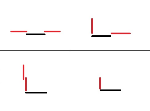

Testing different frames gave some interesting and useful results.
L frame seems to be the way to go, but maybe has it's limits.
The driver position changes in different configs and therefore so does baffle response in different configs, the exact effects are not super clear.
A wider front baffle like 1st example really does degrade imaging quality and additionally (or as a side effect of the imaging) it sounds less detailed..
Only thing that sounded worse was a u-frame, it gave most bass though.
2nd example was marginal improvement but making baffle narrower was more benefitial.
3rd example with most extreme L-frame was ok, better than rest, it just sounded a bit off and it is difficult to say what exactly was the cause...
Reflections off the side? maybe with some damping material it would improve.
Decreased distance from back wall? not sure if the deepest part of L-frame counts as the 'back' , didn't bother testing it further way cos my space is already too limited to accommodate that.
Some mild type of cavity resonance starting to form? I thought it had some slight similarities in sound to the u-frame.
Compared to the final example, the shallow L-frame, there was not much improvement to bass response anyway.

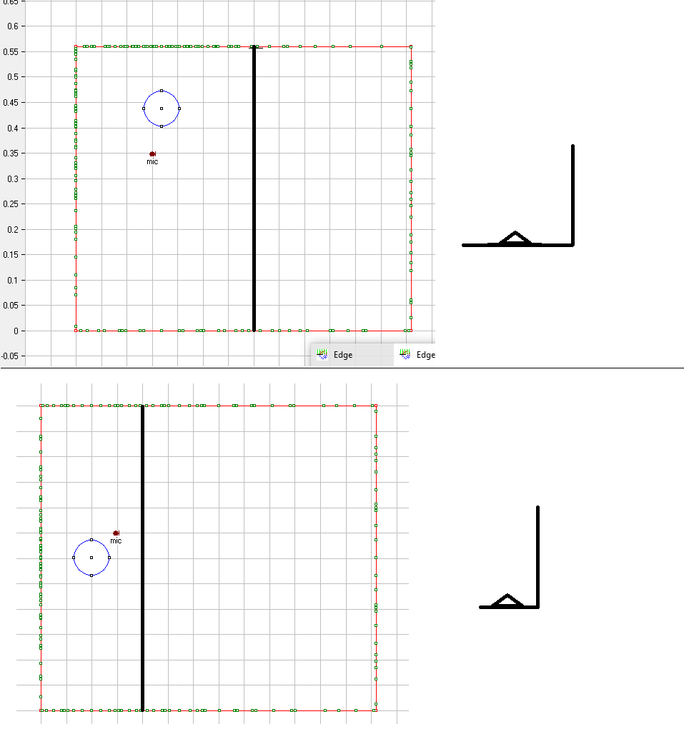

Shallow L-frame had the best set of compromises and it what I will use now, Edge response appears to be a bit more balanced compared others, maybe that is related.
Top of the 2nd image shows driver placement, there is actually a woofer below on it the baffle right now.
On bottom: The front baffle can be made much narrower with a very similar response and with edges near either side of the driver vs nearer a corner , however it would mean an extreme L-frame... I would like to try it.
Testing was done in mono, you can the notice with the L-frames the image becomes slightly asymmetrical, for the shallow one I would say it is a benign effect and in stereo there would be no asymmetry .
Could be related to any of factors mentioned for the deeper L-frame.
Still need to check if L-frame is better on the inside or outside of the speaker pair.
The L-frame should definitely be on outside of the 2 speakers, sounds very 'boxed in' with them on inside, which is not surprising I suppose.

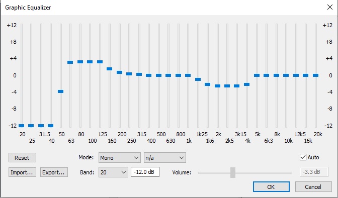

This was the EQ profile:
attachment.php
The dip in the upper mids is no longer needed or wanted.

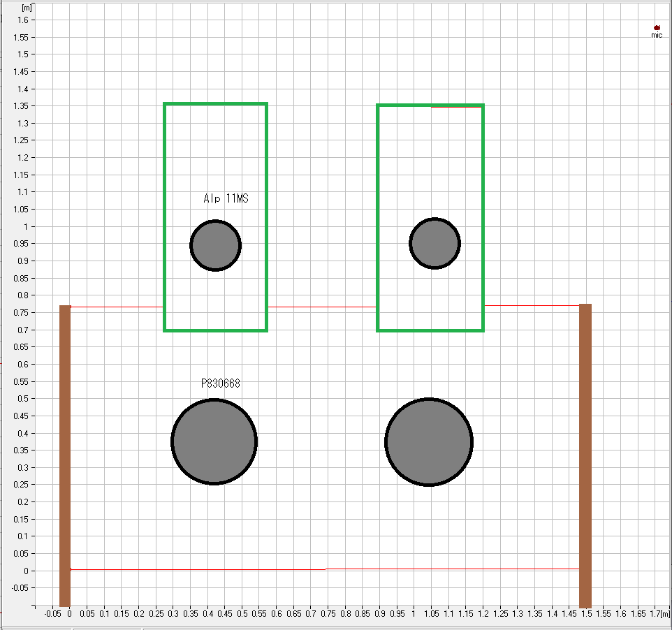

A good compromise to get larger baffle area in smaller space for an OB multiway is having the drivers share one large baffle.
Below is just a rough test setup, it was quick and reversible to just attach the 11MS open baffles to this wooden headboard that I had mounted the 2 P830668 on for an earlier test. There is excessive distance between the woofer and FR, the Edge response looks pretty bumpy for all the drivers.
Despite this and all other potential issues of sharing a single flat baffle for all drivers it sounds pretty great already.
The 11MS manages to maintain low IMD in midrange with heavy bass so it is ideal for OB WAW, this was my issue using the alpair 7p in a similar OB application, I wanted to cross it higher to lower IMD but the P830668 cone break up would become too audible.
On this baffle the 11MS is 1st order high passed at 100Hz with -0.8dB attenuation (sensitivity is quite well matched to P830668). the 11MS sounded good running even left running fullrange, it was a bit cleaner and coherent sounding this way and I wanted to have some protection for over-excursion.
The P830668 sound best low passed at 750Hz, surprisingly high, I think after getting some use at real volumes (enough to create some cone movement) the mid range smoothed out and of course the vastly increased low bass efficiency helps.
The OB woofers are amazing for the simple reason that you basically only hear them and not the room, bass emanates from the baffle only, attack and decay is very fast for more realistic impact, more definition, and it persists up to very high volumes.
The is in a 9x11' concrete wall listening room.

1st order passive HP will not result in any protection for the poor small widerange driver, in contrary. At main resonance, SPL will come back, sometimes even more as without any filter at all.
The only way to use a pssive 1st order HP in a WAW is having a parallel LCR to the wideband which flattens the impedance at resonance and allows the C to work correctly. 100Hz HP and 750Hz LP sounds strange, especially in an OB. Have you measured or calculated?
All the best
Mattes
True but only for passive XO, I should have mentioned this is using PLLXO .

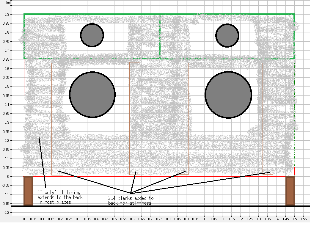

They were strange XO points and I think it was to do with the extremely erratic response of the baffle and driver placement
This was a crude first test for seeing the potential of using a single baffle for all the drivers.
A lot of adjustments have been made since and still a WIP.
Below is another rough diagram of current state of it and overall it is a big improvement over last example.
I will need to find out the new optimal XO again using software but
already obvious is that the 11ms no longer needs any attenuation and the woofer lowpass point is going to be lower.
One thing for sure with polyfill lining it is a strong contestant for ugliest speaker ever built.
I can of course get most extended response yet from 11ms alone on this baffle and the lining addressed some of my previous SQ issues of using large baffles, but it will be hard to go back to not having the strong OB bass response of the woofers.
