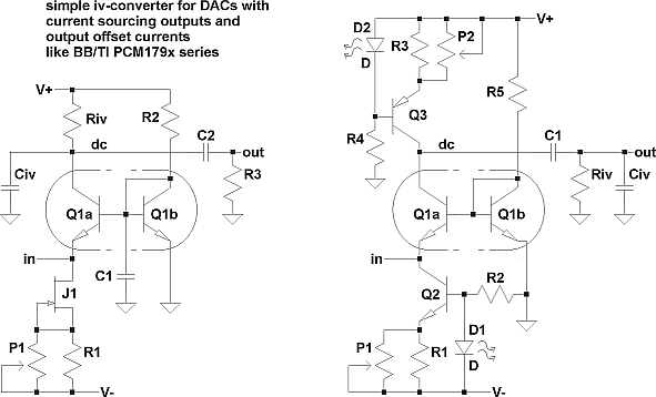

You need to make sure that the second output sees an equal and low impedance.
You could either use two identical circuits like the ones in the attachment and take just one of two outputs, or connect a smallish resistor of 2-20Ohms from the second output to gnd.
Since the output of the attached circuits is free from dc it may be directly coupled to a buffer stage or a following device.
The left circuit requires well regulated clean power supplies, especially the positive supply.
The right circuit lessens the demand on the positive power supply at the expense of slightly more touchy setup, a bit more noise and slightly increased THD.
The left circuit is capable of THD better than -90dB (at fullscale) and better than -110dB in noise. But best is...it blows away OPamp-IVs within seconds.
See also the thread "ZEN -> CEN -> SEN, evolution of a minimalistic IV converter"
That is just wishfull thinking at best. SE from 179x it just blows, that is it... Increased distortions, reduced dynamics, increased noise - all due to SE, resistor aproach.
Also those circuits above are very picky about adjustments, picky about components.
