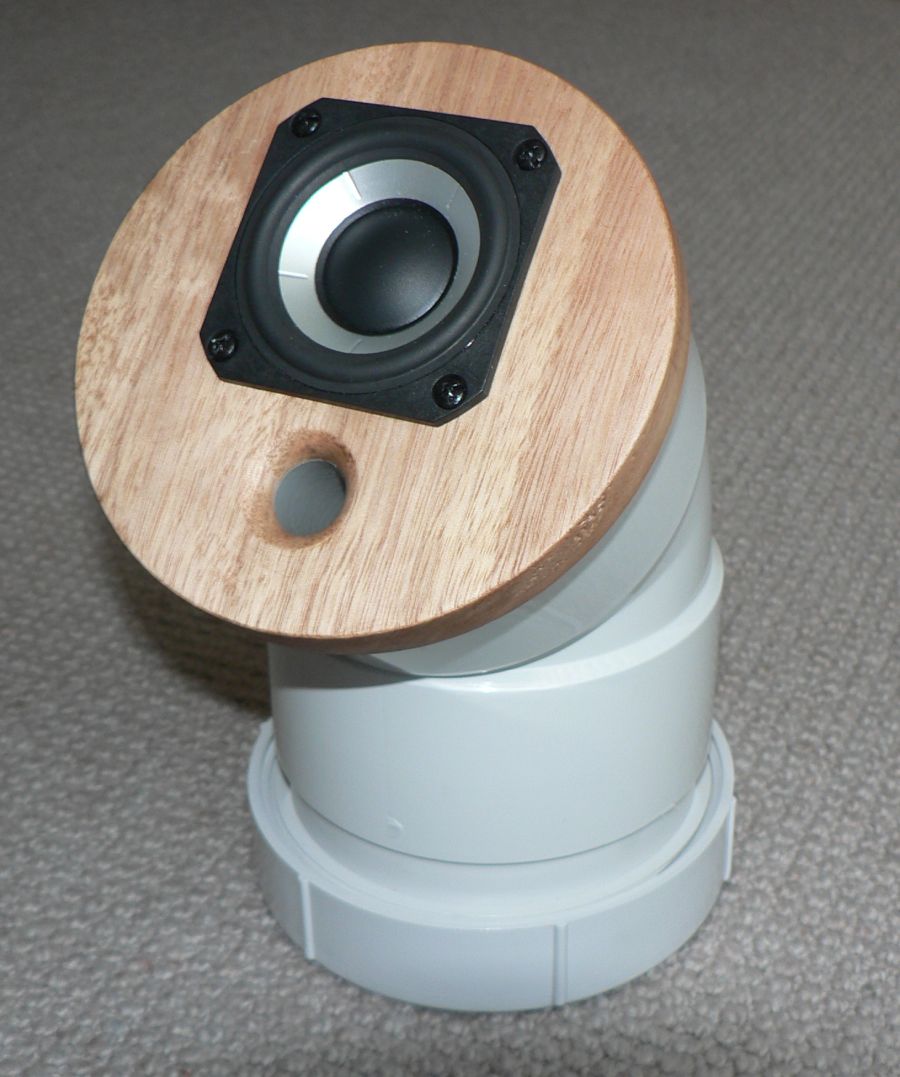

Played with this micro stuff for the last couple of years and some observations.
SB65WBAC25-4 which does work better than it should. The top end is a real surprise, nice mids and ample bottom end when vented. Plastic frame easy to break when adding or removing spade connectors so care required. I did 3 versions and I prefer the vented:
Vented Vb=1.36L, Fb=78Hz, F3=65Hz
Passive radiator Vb=1.3L, Fb approx 80Hz (SB12PAC-00 with half spider removed.
Also did a PVC pipe elbow version but the box version sounded better.

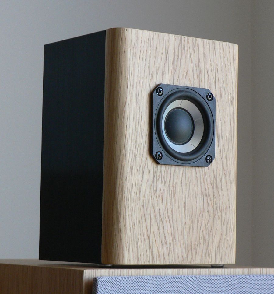

TG9FD10-04 which does a charming job. More relaxed presentation which makes for easy listening so it doesn't burn holes in your ears. The top end is not as good as the above but matches the overall sound and feel it's nicely balanced. I was going to add a tweeter (TN28) with it but not required.
Vented Vb=3L, Fb=80Hz, F3=65Hz, hump at 150Hz but doesn't distract from overall sound. Box is under size for better power handling and reduced excursion plus smaller build size. Flimsy plastic basket and a pain the add a 0.5mm gasket. Terminals aren't great for spade connectors.

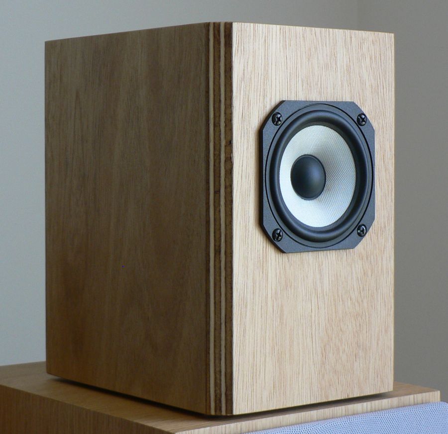

NE95W-04 which is nicely made but lacks the top end so it needs a tweeter. Mids and bottom end is fine. The gap for the voice coil is small so it can rub if the cone is pressed on one side. Pushing it back evenly all the way fixes this.
Vented Vb=2.9L, Fb=87Hz, F3=69Hz
Eventually used sealed with 2 drivers in series for HT presence / atmos speaker depending on orientation. Sealed Vb=2.3L, F3=115Hz

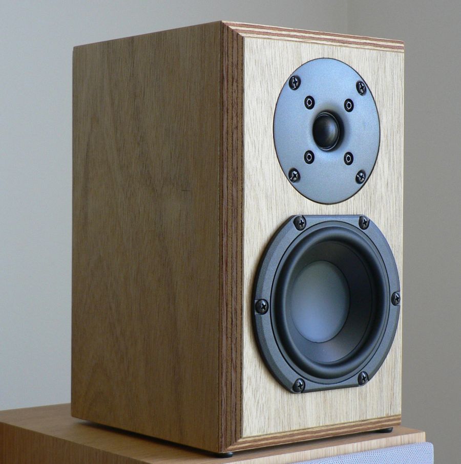

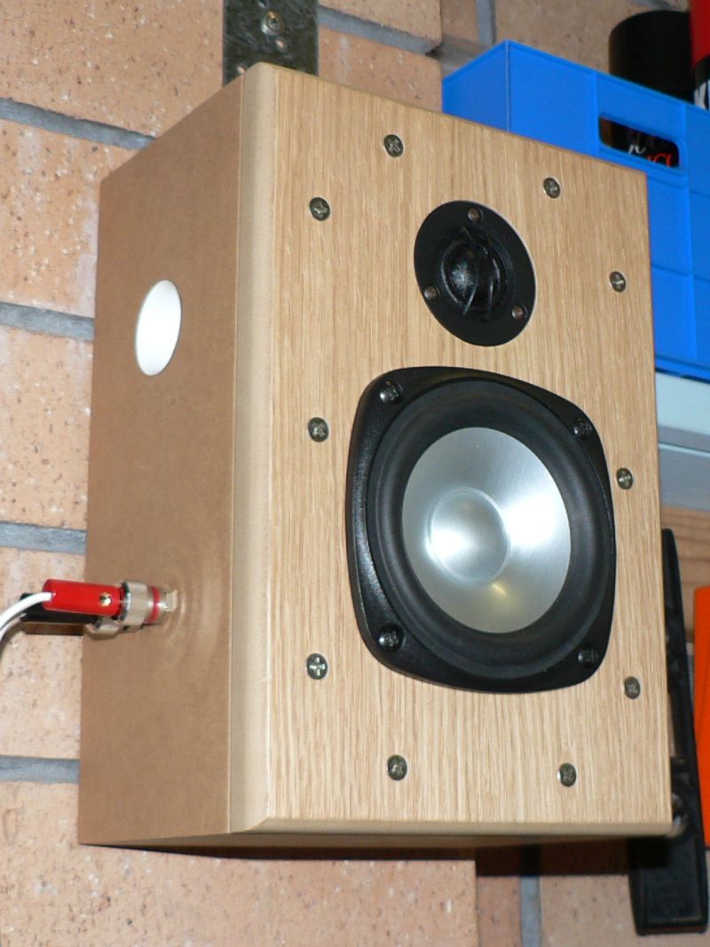

I did 2 other multiway micro speakers and as expected they out do the fullrange in the normal farfield listening positions but nearfield on desk the gap closes to a preference for the fullrange. The examples are shown below.
830870 + SB19ST-C000-4 - top end needs a tad more padding but fine elsewhere.
Vb=3.5L, Fb=84Hz, F3=72Hz
SB12PAC25-4 + NE19VTS-04 which is used nearfield above by workshop bench. A great little speaker and highly recommend the SB12PAC.
Vb=2.6L, Fb=78Hz, F3=72.
One thing I found with all the small speakers is a hump before the roll off is beneficial and makes the speaker sound more balanced.
All these were referenced against Jeff Bagby's Soprano in a small to medium room.
I've added some pics for reference.
