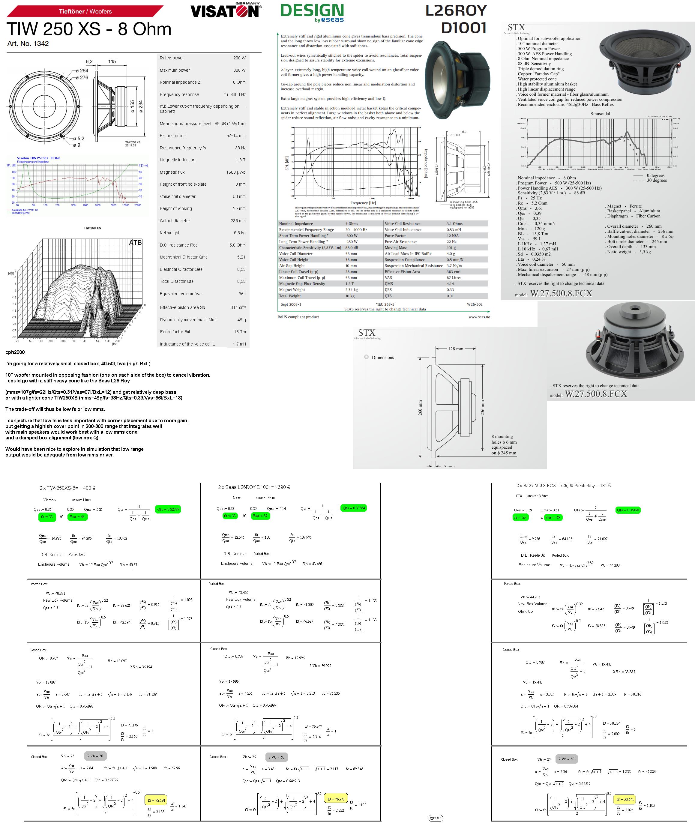

What I would like to explore is the following: I'm going for a relatively small closed box, 40-50l, two (high BxL) 10" woofer mounted in opposing fashion (one on each side of the box) to cancel vibration.
I could go with a stiff heavy cone like the Seas L26 Roy (mms=107g/fs=22Hz/Qts=0.31/Vas=87l/BxL=12) and get relatively deep bass, or with a lighter cone TIW250XS (mms=49g/fs=33Hz/Qts=0.33/Vas=66l/BxL=13)
The trade-off will thus be low fs or low mms. I conjecture that low fs is less important with corner placement due to room gain, but getting a highish xover point in 200-300 range that integrates well with main speakers would work best with a low mms cone and a damped box alignment (low box Q).
Would have been nice to explore in simulation that low range output would be adequate from low mms driver.

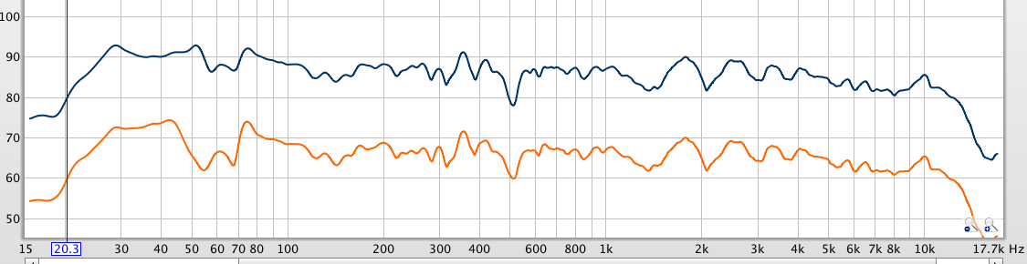

At long last, we did some redecorating of the music room a few months ago. So with accessible space, I was able to test my 1955 AR1 sub in 14 positions forming a U along the working end of the room with the usual REW runs.
Can't say as I have any brilliant findings except that you'd be surprised how the low end FR fluctuates with speaker location. If I had any generalization for my room, it would be that the generally accepted rule of 1/3 usually does the most good for most room modes, sort of, for that speaker and room.
Big effect of opening the sliding door on the clothes closet on axis at the far end.

Here are curves with the closet door slid open and slid closed, left channel, driver about 1/3 across speaker-end wall. Curve south of 90 Hz a whole lot better. BTW, that's a 15-inch driver in a 6 cu ft sealed foot box, lots of stuffing, with some bass boost.
Mic where my head usually is. This is the real thing, not made from sims. If you draw my "house curve" through it, within 4dB 22-14kHz, 1/12 smoothing.
Ben

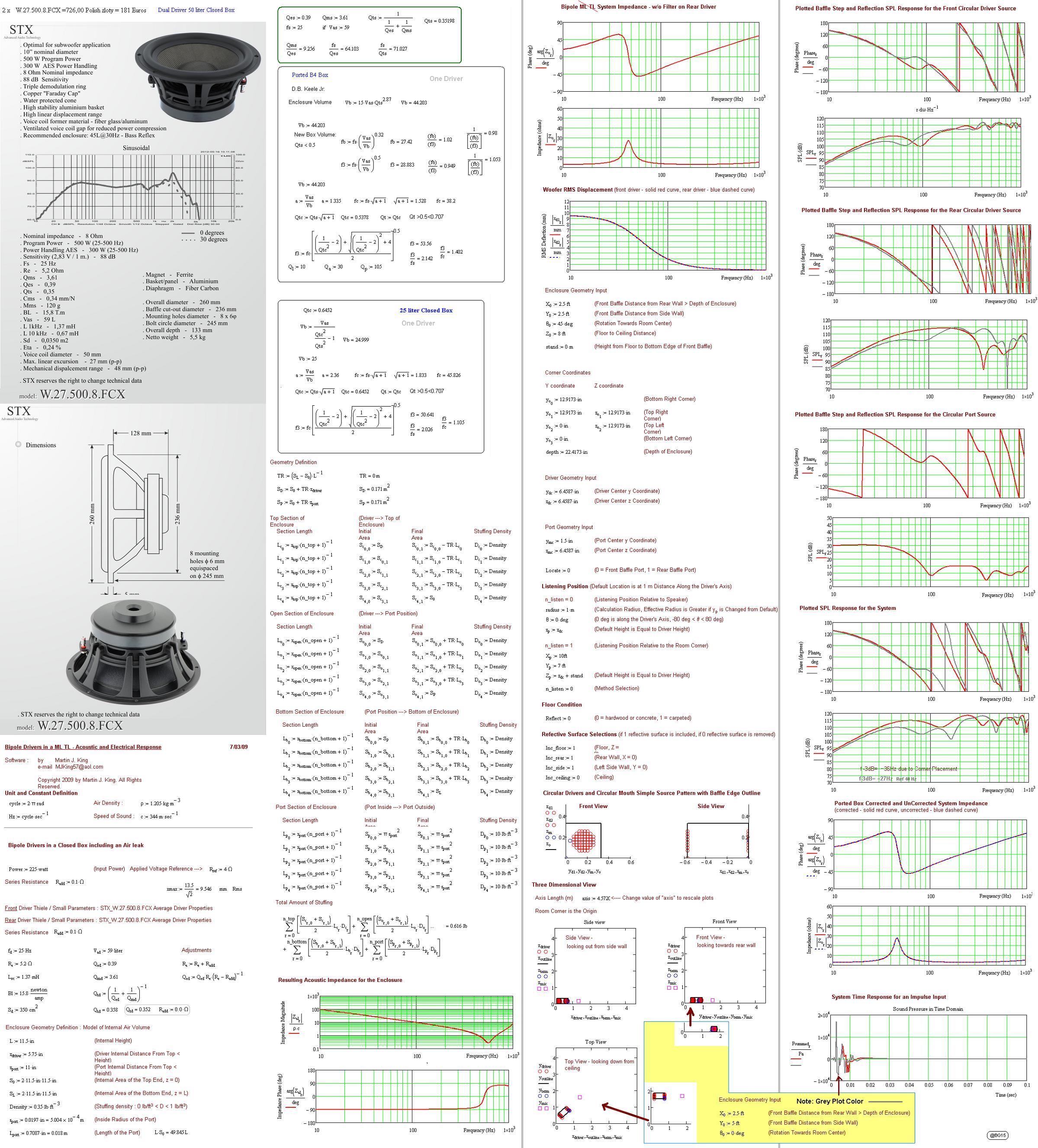

Having studied this a bit, I'm now leaning towards a Sub (actually Woofer) system in a closed box with low box Q (as low as 0.5) using a driver with low MMS, Rms, Le and high BxL. So not a sub unit in classic sense

Akabak can simulate corner placement - the radiator geometry, size, and orientation (6 DOF) relative to 3 walls in a corner are all specified (how far away each one is). It can make a big difference and changing distance a few inches can show room cancellation or floor cancellation modes depending on height and placement. The relative mic or listening position is also selectable in 3d relative to speaker.
For example, in the following code which describes the radiation from a horn mouth element:
Code:
Radiator 'Horn_Rad' Def='Horn Segment Mouth'
Node=16
x=0  y=-8in z=-20in
HAngle=180  VAngle=15
WEdge={Width/2}  Hedge={Height/2}
Reflection
Label=10
This has the horn mouth located -8in below the reference (usually the tweeter axis) and -20in behind the tweeter and aimed 180 or backward firing into the corner with a 15 deg up tilt. The "Reflection" switch turns on the 3d spatial effects and diffraction and reflection. Wedge and Hedge define the cabinet width from radiator centerline to the edge of the cabinet to calculate the baffle diffraction assuming a rectangular baffle.
Earlier in the script you need to specify that reflection with a corner is used:
Code:
| Speaker placed in corner with driver at Driver_pos above floor in corner
Def_Reflector  BottomCorner
Bottom=30in  Left=36in Right=36in
HAngle=0  VAngle=0
Here, "BottomCorner" refelction definition is used and the tweeter reference is 30in above the floor and 36in from left and right side walls, and aimed horizontally and 45 deg from corner (0 deg is 4 deg relative to side walls).
