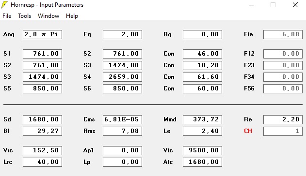

Hi everyone,
I did a compound simulation in Hornresp. I'm not able to do this in Akabak, I have tried several times but without success. I spent more than tens hours, not in my capacity.
I'm not sure about my simulation and I'm stuck today.
Could either of you do the simulation in Akabak ?
The speaker is the B&C 21DS115
Box size : 104 x 75 x 65
Axel

I have only a 2D view made in Sketchup.
If I will do a 3D version in Sketchup, it is good for you ?
It depends in what format 3D is. To create mesh file for Akabak is needed STP type of file. Also it must be made in way that all planes what are needed to transfer to independent subdomains in Akabak, are separate planes in file and also must be possible to edit 3D to add needed interface planes.
